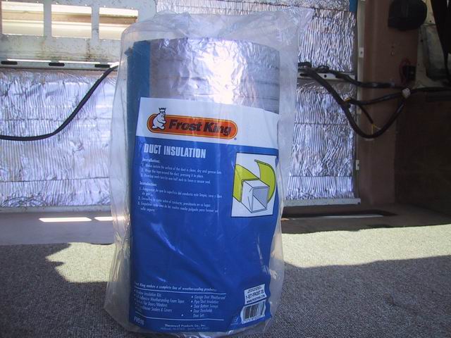

i've been putting in the stuff from the above referenced post. I also used some duct tape to hold it better in places. Here it is

Yes, r390, I used that same FrostKing duct insulation on the inside of my front door panels. It seems to work pretty well. I got mine from Home Depot.
How well is that sticking to the metal?

I put the stuff on during the hot So Cal Summer. It did not fall off. I had inside temps well over 100 a few dozen times while the van was parked at work. At what temp does the stuff fall off?

I read the "great source : http://www.sounddeadenershowdown.com/ " and understand. OK I get it. Thing is, I did NOT use asphalt based productis. I used the "Butyl with a non-asphalt filler" (see picture) stuff for insulation. and used the Juliano's OEM GM sound deadening material.
I have no smells and the stuff is quite sticky on the side walls of the van no matter how hot it is. I measured my inside temp today in the 94 F heat with all the windows shut at 112F today in the direct sun by looking at the indoor/outoor thermometer just a short bit ago. Then I opened the door and stuck my nose near the various materials. I could not smell any of the VOCs that are mentioned in other places. I guess the fact that we are under 158F might have something to say too. But, the Frost King stuff is rubbery with no asphalt filler and aluminum covering designed for indoor use.
Point is I choose wisely. Only issue the aluminum does not stick so well and I used duct tape to keep it in place better.
