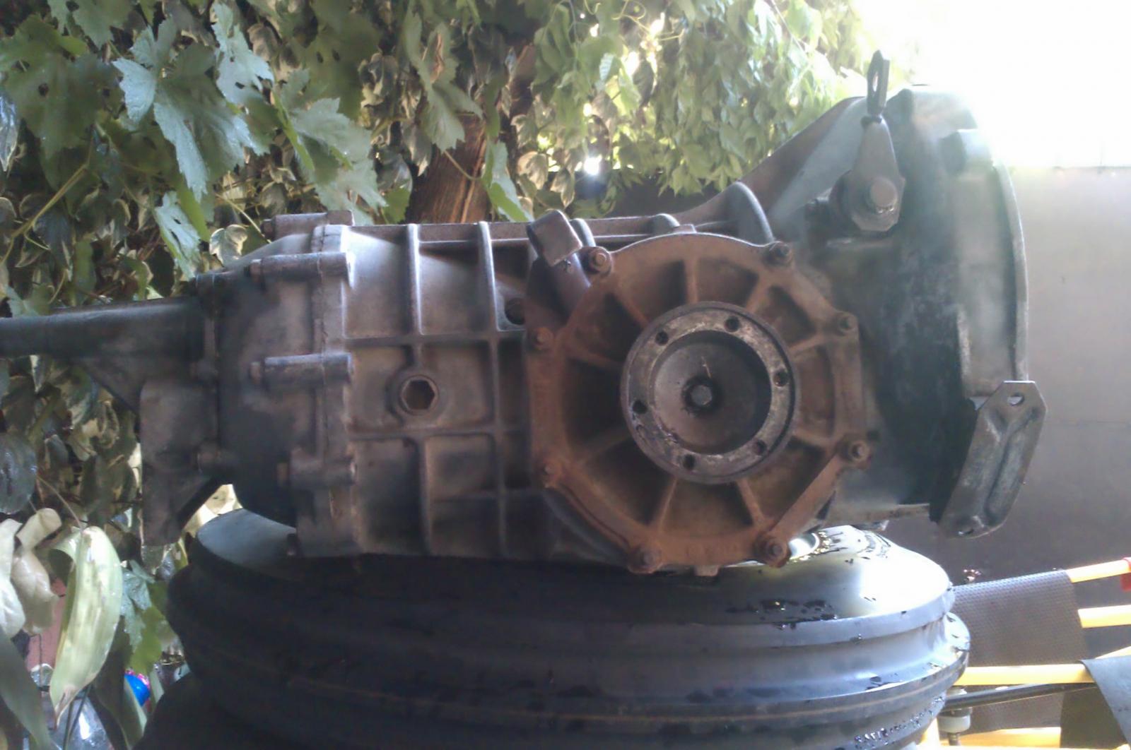

I've got a 5-rib (002) pyramid trans laying around. I want to use it in my 69 bay window (also has a 002, 3 rib) do I need to make any modifications or is it just bolt-on?
jsturtlebuggy
Joined: August 24, 2005
Posts: 4589
jsturtlebuggy is offline
PostPosted: Sun Mar 05, 2017 10:32 pm    Post subject: Re: Transmissions For Dummies Reply with quote
A 5rib should fit in replacement of a 3rib without any problems. There will be ears on top of bell housing for mounting that should not cause any interference with body.
Just remember you are putting in a higher geared transmission.
More load on the engine if it's stock.
