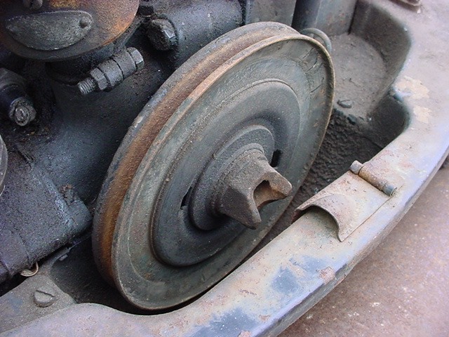

I'm asking on this forum to get a pic of a 25hp pulley but the engine i'm building is for a 55 and i'm not sure of the type of pulley to use on the generator, i have a three piece 36hp pulley with the fat lip on the outer half of the pulley. But i'm thinking it should still have the thin lipped 25hp pulley. I have a 54 hand book and it shows pics of the thin slot generator with round regulator with a 25 hp pulley.
Any thoughts help with pics greatly appreciated

simon, how detailed do you need?
i could have a close-up for you tomorrow

My '55 Barndoor original engine had the thin lipped upper pulley.

If you're using the thin-lipped pulley, then you'll need the 36mm nut. Both of which is correct for a Pre '55 motor. The lower crank pulley should also have no lip, as opposed to a curved lip pulley which was introduced in 1956 to coincide with the newer fat-lipped generator pulley & 21mm nut.

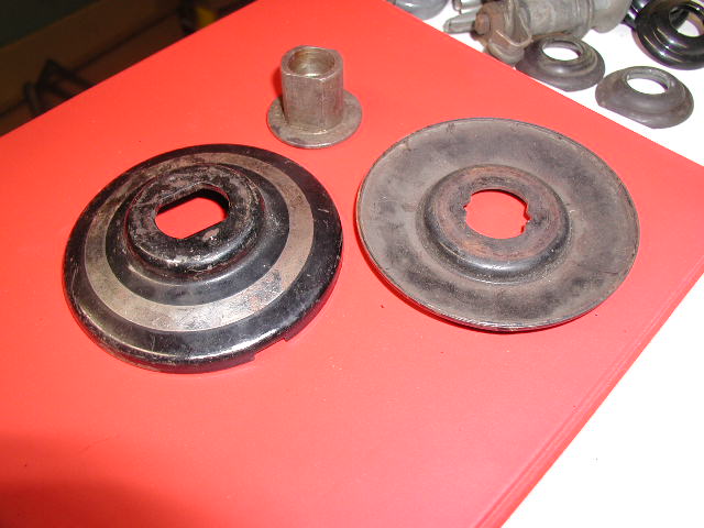

Uzi, could you get me a picture of the three pieces apart so i know what the front/back and the hub look like, i think i have the parts but need to compare with something.
thankyou

More info:
The toolkit changed to remove the larger generator pulley wrench on August 4th, 1955 so I would assume the 36 mm pulley nut was also changed at that time.

PostPosted: Mon Dec 05, 2005 5:19 pm    Post subject: Reply with quote
John Henry
'57 Deluxe
'56 Single Cab
Rusting Hulk
Joined: August 20, 2002
Posts: 646
Location: Malvern UK
Rusting Hulk is offline
PostPosted: Mon Dec 05, 2005 11:05 pm    Post subject: Reply with quote
John thankyou very much, exactly what i wanted, and i think i have one.
