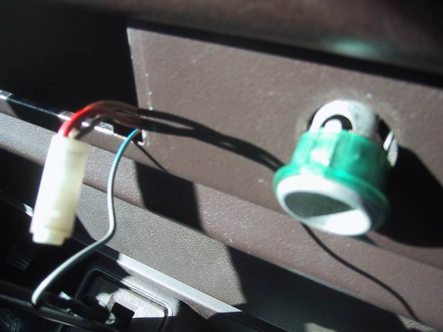

PostPosted: Mon Sep 18, 2006 10:46 am    Post subject: How do I get this lighter apart? Reply with quote
OK, got it half way out. Now what?
How do I get that ring off?
I looked at the Casco instructions,
and I can't make it work. I have
to seperate the green plastic ring.
Don't quite see how to do this, yet?
Any help?
The wires are what I unplugged from the lighter.

PostPosted: Mon Sep 18, 2006 12:51 pm    Post subject: Reply with quote
It's been a while since I replaced my lighter. Can't exactly remember how I got it out but I do remember fighting with it for a while. I just went down to AutoZone and bought a $5 replacement lighter. I figured, "What the hell do I need a lighted ring for anyway?" Of course, the standard lighters don't fit in the hole. I'm fortunate to have access to a machine shop so I took a large washer, chucked it up in a lathe and drilled it to fit the new lighter. Painted the new home-made bezel flat black and installed everything. Works great. I also installed a couple more el-cheapo lighters under the dash on the drivers side. In this day of cell phones/XM radios/radar detectors/etc., you just can't have too many lighter sockets. Some PO had long since snipped the wires going to the Euro plug in the dash. I do have a really nice electric vest that I use on my motorcycle that would plug right in but, since this is a waterboxer, I have real heat. Being an old BMW motorcycle guy, the only thing I can think of ever having seen plugged into that funny socket is heated clothing. I wonder what other accessories are out there that use those funny plugs.

PostPosted: Mon Oct 02, 2006 3:31 pm    Post subject: Reply with quote
I DID IT! I DID IT! I DID IT!
I got the cigar lighter socket out with out breaking it. Woo Hoo.....
What a MAJOR PITA it is though.
I will share with you the mystery now. You need to do as shown in the pictures that follow:

Once you get the snaps pushed out, which makes little sense while you are cursing away in the van, then you can push the center part (metal) out. Once you do that, you can wiggle the assembly out. You can NOT get the assembly out of the hole with out disengaging the sanps. Once out, you can play some more to get it into two pieces. It seems it is inserted half assembled and then snapped in. I don't think they ever really intended you to take it out as one whole piece.

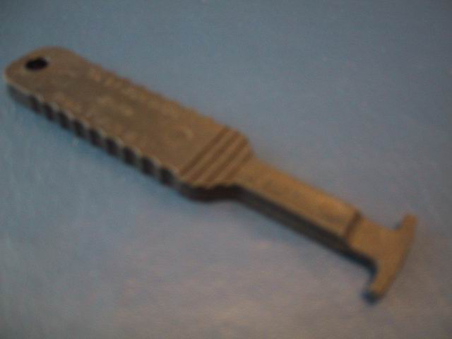

PostPosted: Mon Oct 02, 2006 3:40 pm    Post subject: Casco Tool Reply with quote
Here is the Casco tool I got for taking the 171 919 305 C cigar lighter assembly apart. I got this from a lighter kit at Walmart.
For my next trick, I will be installing a new one and an extra one for aux power. We'll see how that works.
This tool is so-so. I still used a few small screw drivers for this job.
WHAT A PITA!!!!

I got mine about halfway out and unhooked the wires and zipped off with my angle grinder and a cutoff blade, Took about 3o seconds.

I was at "my" WalMart (Las Vegas) and they do not have --any-- cigarette lighter. I followed your link and emailed Casco to obtain a list of retailers.
They never responded.
As fat as the Pig A part cigarette lighters are concerned I found a small "pod" designed to hold three gauges **and** the cigarette lighter, similar to the one in my old Beetle 1968, with the fat black ring into which the heating element sinks in. I seem to recall I got it out of a rabbit convertible.
Whenever I get installed I'll post pictures.
