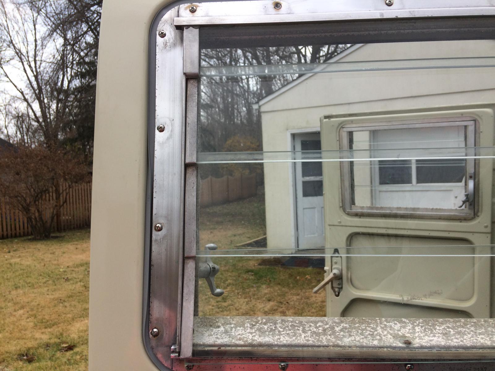

Galvanic coupling ruined the whole idea of stainless hardware for me. Especially on somewhere visible.
https://en.wikipedia.org/wiki/Galvanic_corrosion

I've heard there are some concern's about stainless Malokin Martin, where is this a photo of?
What is more shocking is the wiki link you sent and food, looks like I need to rethink food preparation and get glassware, YIKES:
"Lasagna cell
A "lasagna cell" is accidentally produced when salty moist food such as lasagna is stored in a steel baking pan and is covered with aluminum foil. After a few hours the foil develops small holes where it touches the lasagna, and the food surface becomes covered with small spots composed of corroded aluminum.[15] In this example, the salty food (lasagna) is the electrolyte, the aluminum foil is the anode, and the steel pan is the cathode. If the aluminum foil only touches the electrolyte in small areas, the galvanic corrosion is concentrated, and corrosion can occur fairly rapidly. If an aluminum baking pan is used instead, the rate of corrosion is markedly reduced, but still may occur."

Zinc is sacrificial.
We've seen how bolts get rusty when the zinc oxidizes... as it's supposed to.
Then, we improve on it by replacing it with shiny stainless hardware... only to have the base metal become the first to oxidize due to galvanic corrosion. Then your stuff really turns to crap. Better to just switch out the hardware with fresh zinc plated steel... if it really bugs you.

So what is preferred? Coat the sink style with clear grease?

It all depends...
A little mirror clamp corrosion over time is OK = do nothing
Needs to look great: (some combination of the following)
1) paint, wax, clearcoat, etc.
2) replacement schedule
3) keep it garaged / babied
To avoid base metal (your bus body)... use fasteners that will be sacrificed or are the same metal.
Minimize the difference in electrical potential when selecting fasteners.
You'll see (column 1 / row 3) in the chart below... with the steel bus body and the zinc plated mirror clamp... the engineers designed the bus body to outlive the zinc coating on the mirror clamp.
Here's a chart I put up in a Hehr jalousie window thread... when someone was using stainless screws or rivets. (so in this instance, ignore the red/green & just check out the chart)
aka: Evan

For protection from Galvanic corrosion, this stuff: https://www.ultratef-gel.com/tef-gel/
For coating zinc plated steel, this stuff: https://www.amazon.com/BOESHIELD-Corrosion-Protect...shield+t-9
I buy the T-9 stuff by the gallon, but you can also buy a $10 bottle. I live in a VERY humid/salty environment and I fight corrosion on everything. I have tried lots of products, but have become loyal to the two listed above. Lots of aluminum fastened by stainless hardware here, that also gets exposed to salt. Even my tools are coated with T-9....

Thanks easy e, that chart has me nervous because I used stainless screws on my Jalousie windows and you probably were the one to tell me not to.

That stuff looks exactly what I need Drew Ogden, do you think I can put that T9 on my stainless screws on the jalousie windows? I have a Wet Coast Marine near me and can purchase it there.
