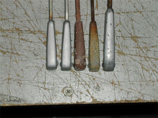

From the threads above:
I believe the ones on the right in this photo are the longer 66-67 style
Also the middle style in this photo

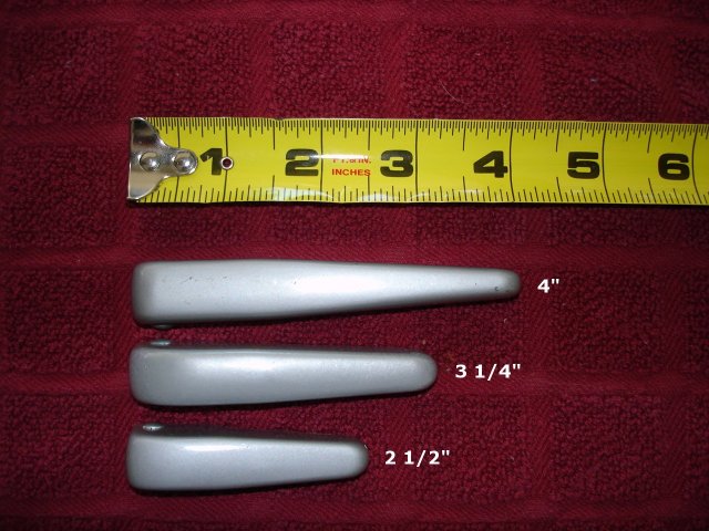

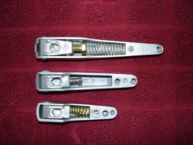

Those appear similar to ghia bases but are slightly different if I remember correctly. I have 2 NOS ghia ones...mild shelf wear, but I think they are a bit different. If I am not mistaken the bases are different as below? Any more input would be great. Thanks.
BarryL wrote:
Posts: 71580
PostPosted: Sat Nov 27, 2010 9:37 pm    Post subject: Reply with quote
Here's the backside photo from the thread above
The back of the center one, the Bus ones, does appear shorter.
I looked at the back side of my used 66-67 bases here and the raised portion is about 1" in length. I'm measuring the little curve downward too, which is not included in your red line above.

The backside above are exactly as mine (SWF and all). I guess I need to look out for some 67 bases.

Yes, that is my understanding as well - it's an upgrade to a new style of fastening that puts less wear on the shafts.
In this case, there are some press photos on the site that show the original bases for 65/66/67.
66 look long to me:
http://www.thesamba.com/vw/archives/pressphotos/66deluxe_a.jpg
67 look long to me as well:
http://www.thesamba.com/vw/archives/pressphotos/67deluxe_a.jpg
65 is indeterminate to me:
Long?
http://www.thesamba.com/vw/archives/pressphotos/65_13windowdeluxe1a.jpg
Appear short:
http://www.thesamba.com/vw/archives/pressphotos/65campmobile1a.jpg
