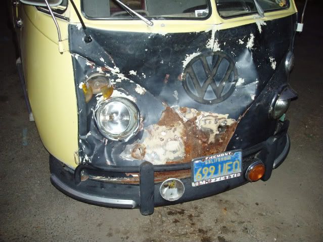

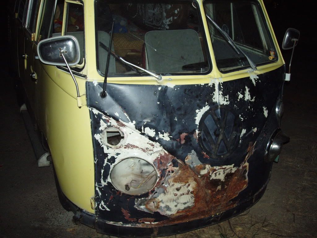

I know this has been covered in the past. I hit a deer a while back and I just finished replacing the nose skin on my 67 camper. I got most of the info here on the samba and further advice from some members. So I thought I would share my experiences for future generations of V-dubists.
I don't claim to be an expert and this is the way I did my nose job. It dosn't mean that its the only way, just what I found to be easiest. Take my experiences for what its worth.
So here we go!

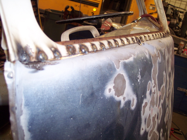

Good Job. If you have a spot welder, great, then you won't have to drill any holes to plug weld. All I have is a mig welder, so I drilled some holes on the side lips of the bus and where you marked the spot welds along the window sill. These holes are where you will plug weld the new skin on. For the bottom, I drilled a few holes on the top of the lip on the donor skin and welded from the top. Now that everything is "cleaned up" and in the open, take care of some of the surface rust you exposed. I also lubed up the wiper asembly.
ATTACH DONOR
As I said earlier. Make sure all your spot welds are ground down and flush. This will make a better fit. With the side and lower lips of you donor opened up set the new nose in place. It should fit nice. I started on the sides first and I clamped down a in a few places on the side where I wanted to weld and tacked in a few holes. Make sure you have a tight fit where you want to weld. If you don't, your weld will not hold.
Weld a few spots on each side while checking your fit during the whole process. Do the same for the bottom. Getting a tight fit on the windshield sill can be tricky. Another member suggested to push the inside lip with a 2x4 or something to get a tight fit. This sounds like a good idea, but my donor fit real tight in this area and all I had to do was hold down the sill a bit where I wanted to weld. Once you've tacked all around, work your way around and fill all your holes, again making sure you have a tight fit so your welds will hold.
Grind down all your welds and use a hammer and dolly to fold the side and lower lips over your welds.

BEFORE AND AFTER

Your explanation was really good. I would like to clear up a few things.
1. On your donor you cut everything around it off and then grinded with a smal ltip the spot welds from the back?
2. How did you get the old skin off your bus, i was going to drill but the cutting with a thin wheel sounds good what do you suggest? Did you use the small grinder as well from the front?
3. How important is tucking under i was going to overlap on the front window seal , what do you suggest?
Its been a while since I did my nose job so I'll try to remember and explain the best I can.
1. Yes, on the donor I cut all the extra metal off leaving a small strip that was still attached to the donor with the factory spot welds. (check out the 3rd pic)I removed this strip with a pair of plyers peeling it off "can opener style". If some of the spot welds were stubborn, I would grind down the welds a bit.
2. I removed the dammaged nose by cutting, with a cutting wheel, as close to the welds as much as possible again leaving a small trip where the spot welds are. After this was cut, Again I used a pair of plyers to remove it can opener style. Any welds left over, I ground down from the front.
3. I would recommend tucking the nose under the windshild frame.
