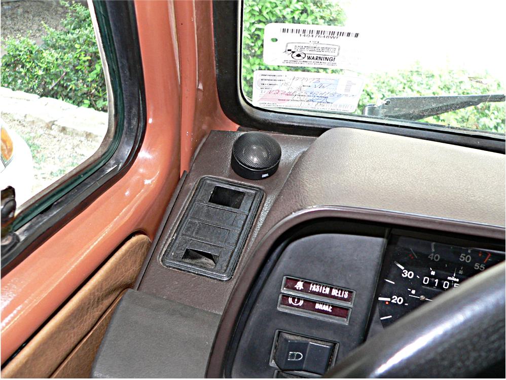

I got a set of JBL two way speakers, but the speakers are seperated.the woofers are mounted to the doors in the kickpanels and the tweeters are mounted on the dash facing the listeners, this gives clearer sound, over 4" speakers aimed at your elbows.
like this but mine didn't cost this much.
http://cgi.ebay.com/JBL-C608GTI-6-1-2-COMPONENTS-N...dZViewItem
tweeters:
woofer:
crossovers:

Hmm I like the tweeter idea. But I'm reluctant to drill holes in the dash to fasten them. Rolling Eyes Yea I'm a bit ridiculous. Maybe I could do something like that on the ceiling. I wonder if those JBLs would fit up top next to the window crank. Thanks for the visuals Art. Man I can’t wait until my stereo gets here. I’ve gone over two years with this crappy 24 year old stock system.

Those tweeters are almost manditory in my opinion. You lose a huge amount of the high frequency sound when it is only firing out from the doors, because those frequencies are highly directional. The dash mounted tweeters will allow you to hear far more detail since they are aimed at your head.
Im mounting mine in the corner of the dash and windshield with double sided black tape. You can easily run the wires under the dash by going around and under, to the receiver. No wires, drilling or permanent buggery.

I didn't want to cut into the dash either so I opted for the air vent. I figured if I ever wanted to change them it was a lot cheaper than a new dash. I got this tweeter/mid system at http://www.crutchfield.com/ for $39.00 on clearance. No body wanted them because they were clear. I just painted the back of them with Krylon fusion and they turned out pretty good. I highly recommned component speakers if you can find a good deal!!!
