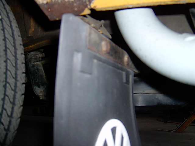

Here's some OG mudflaps,
This bus is a 71 so the mount would be 68-71
This is a 72-79 (apologies for the focus but I'm not crawling under again)
And here's a 68-79 front (no they didn't come with robertson screws from the factory)

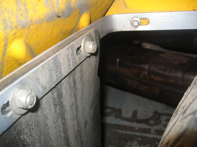

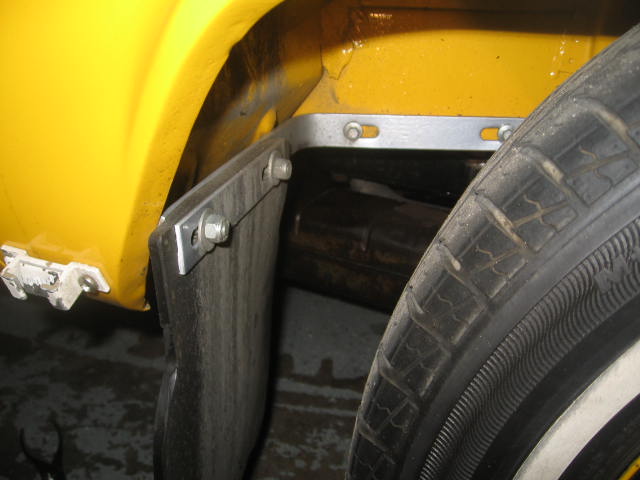

PostPosted: Thu Jan 29, 2009 11:44 pm    Post subject: Reply with quote
here are some pics of how i mounted mine
its just 1 inch flat steel with a 90 degree bend
works good & can be done easy

PostPosted: Mon Feb 02, 2009 8:12 am    Post subject: Mud Flaps Reply with quote
Got my flaps installed. Used a couple metal hinges and a few bolts. Worked pretty good.
