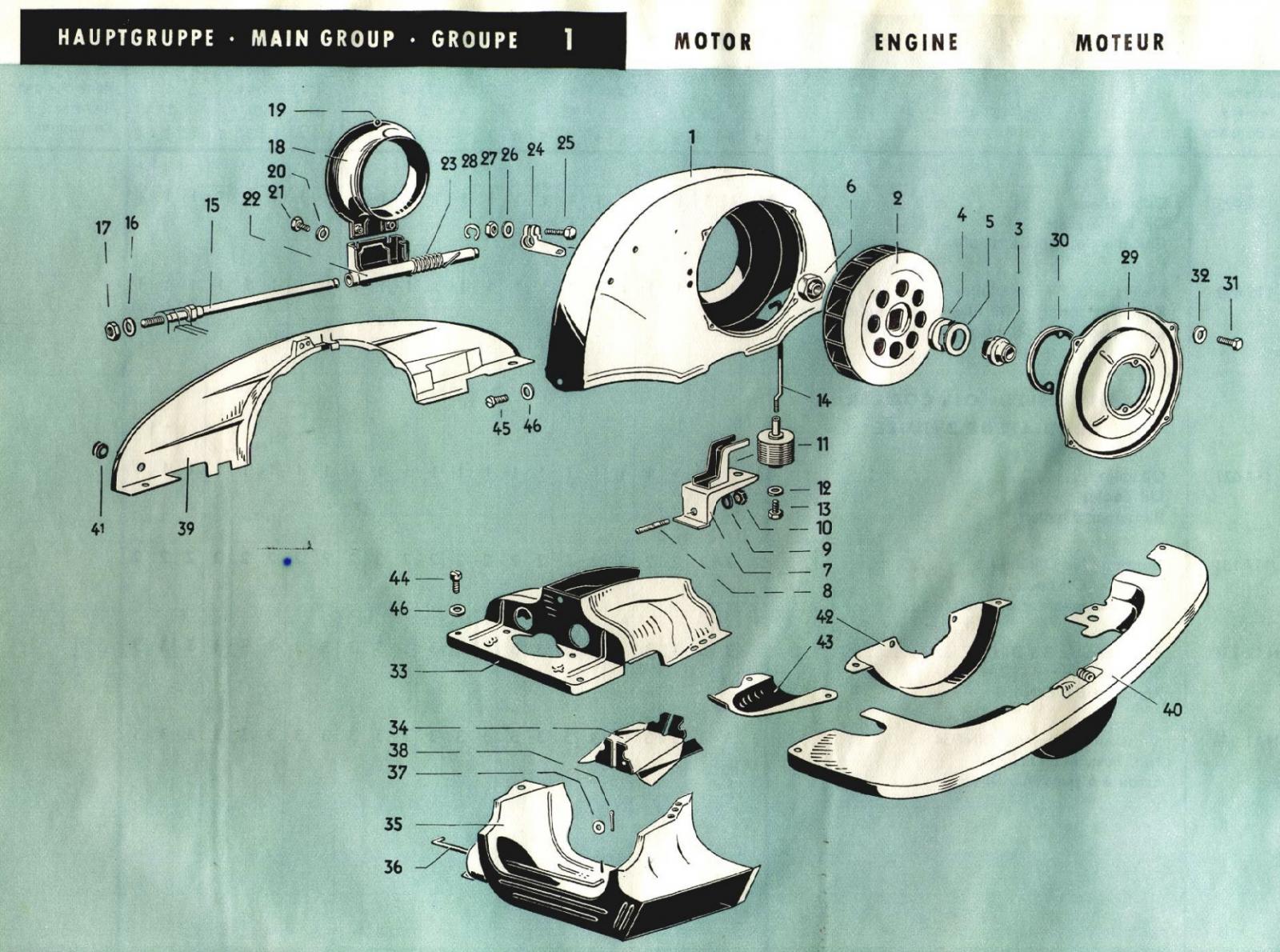

Anyone know if there is anything unique to the Heater box tin, no the box itself, but rather the "Sled" that runs under the pushrod tubes with the flap?
Looking for one for an early 55 (jan) engine, and not sure if I am looking for something specifc.
Thanks

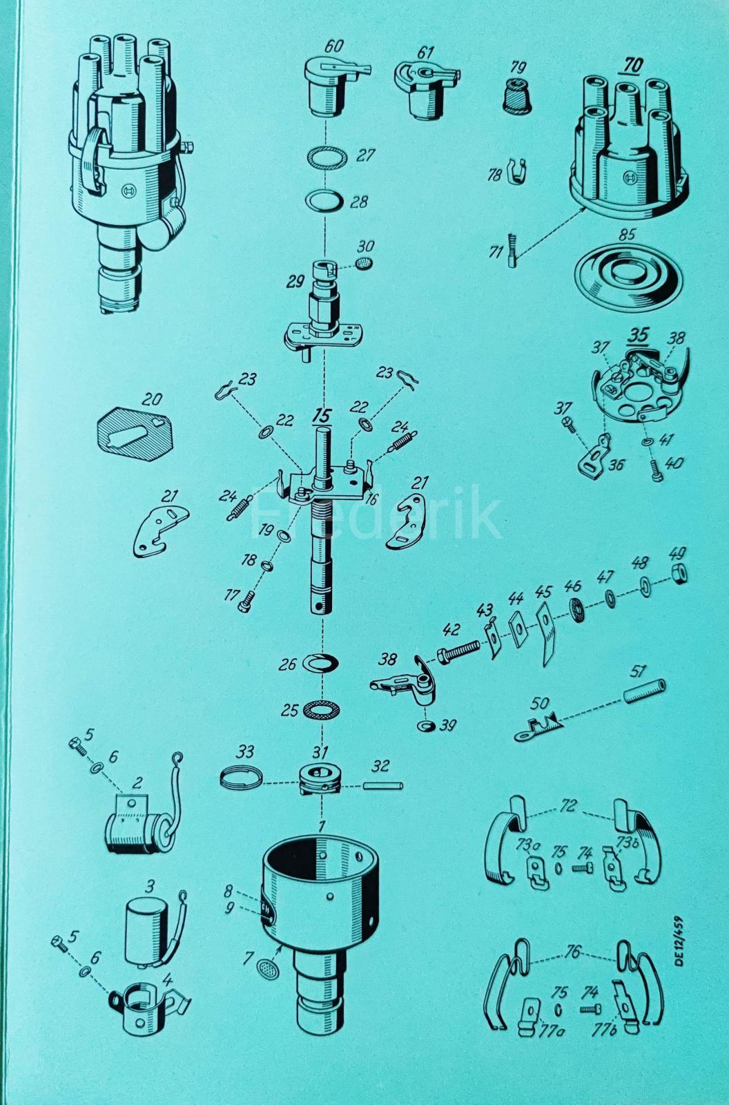

RockStock
Joined: November 26, 2004
Posts: 4211
Location: England
RockStock is offline
PostPosted: Sun May 25, 2025 1:39 am    Post subject: Re: 1954 & 1955 engines whats not correct! Reply with quote
If it’s part #35 in the exploded diagram above, the main difference is probably the number of captive nuts/holes on the rear top. 2 or 3. Early is 3, late is 2 (but may also be different, lhs sled to rhs sled, I can’t remember)

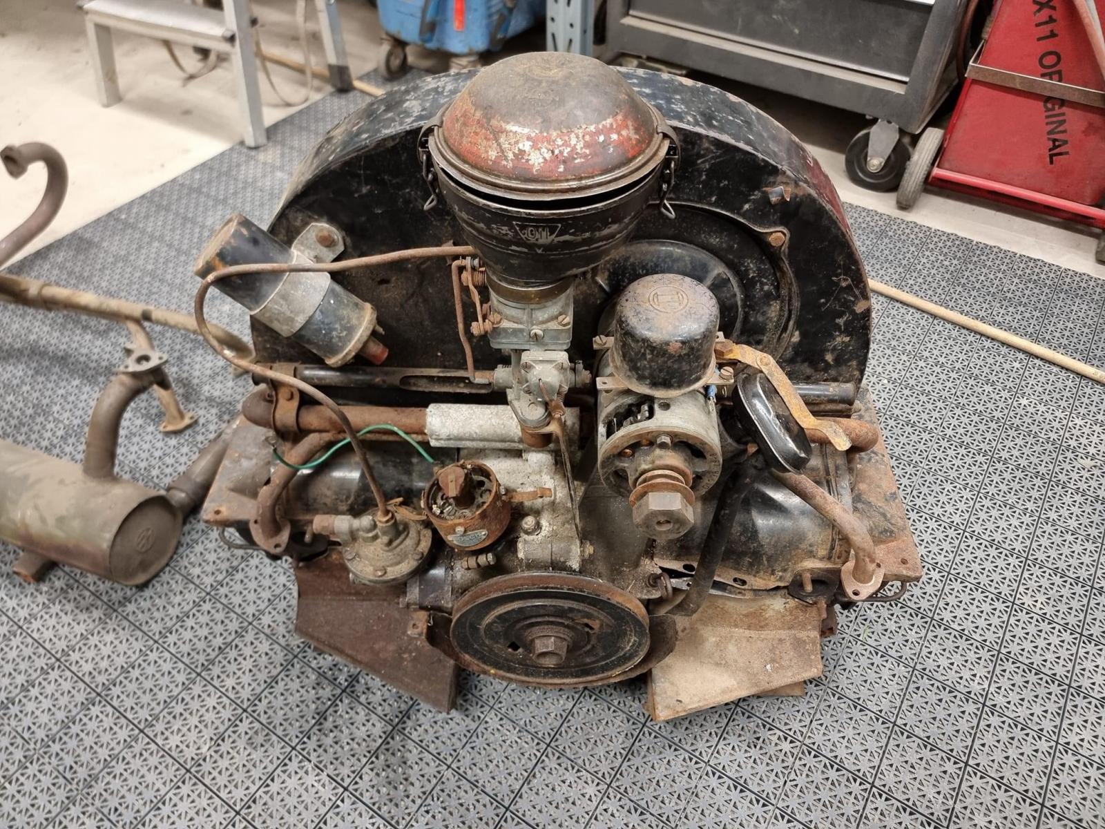

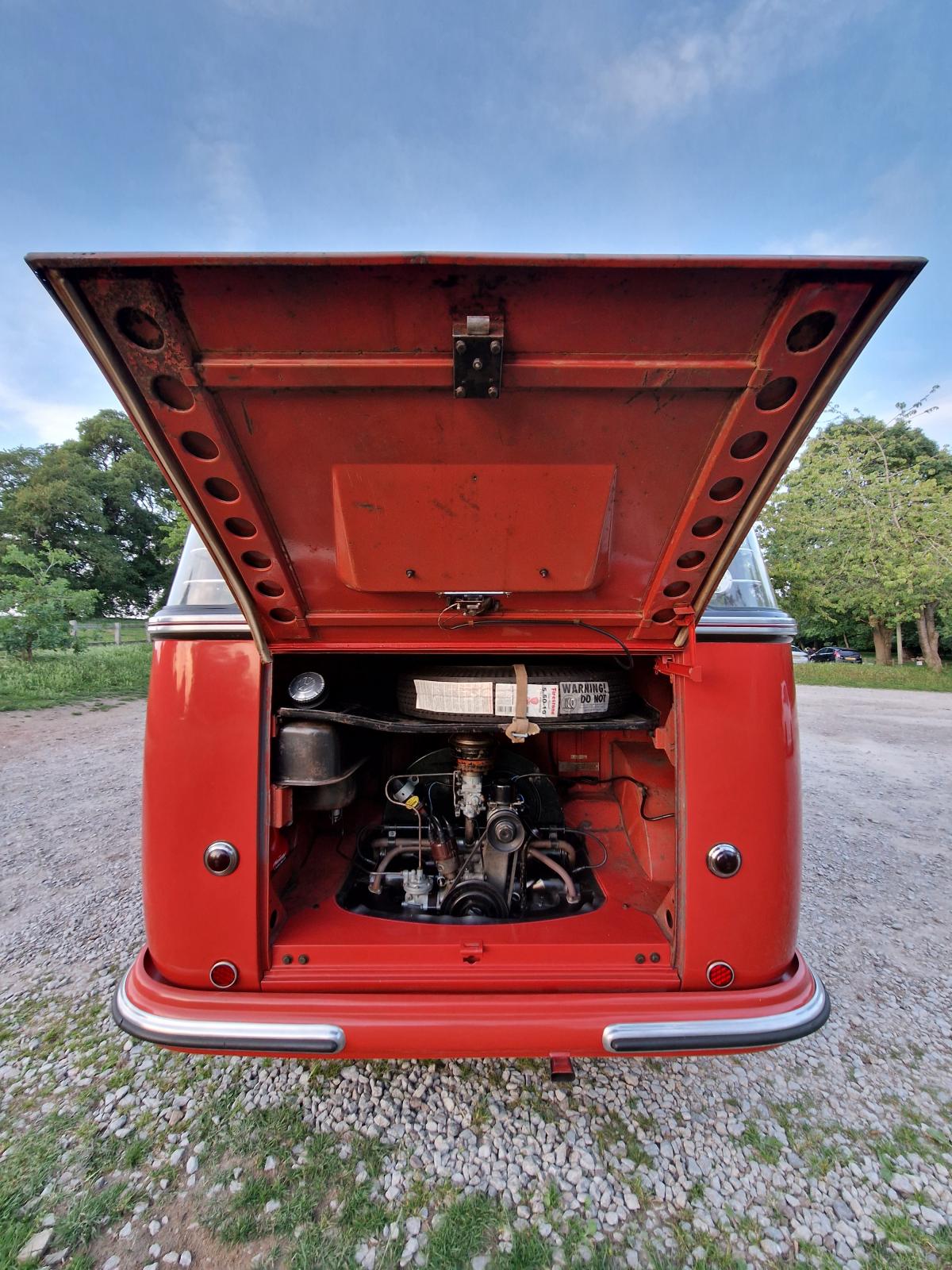

PostPosted: Sun May 25, 2025 9:55 am    Post subject: Re: 1954 & 1955 engines whats not correct! Reply with quote
1956 or later due to the oil fill. The heater boxes would define it too since they changed design sometime late 50s.
1-0900722 die langsame grüne Schildkröte
https://www.thesamba.com/vw/forum/viewtopic.php?t=765074
Posts: 71457

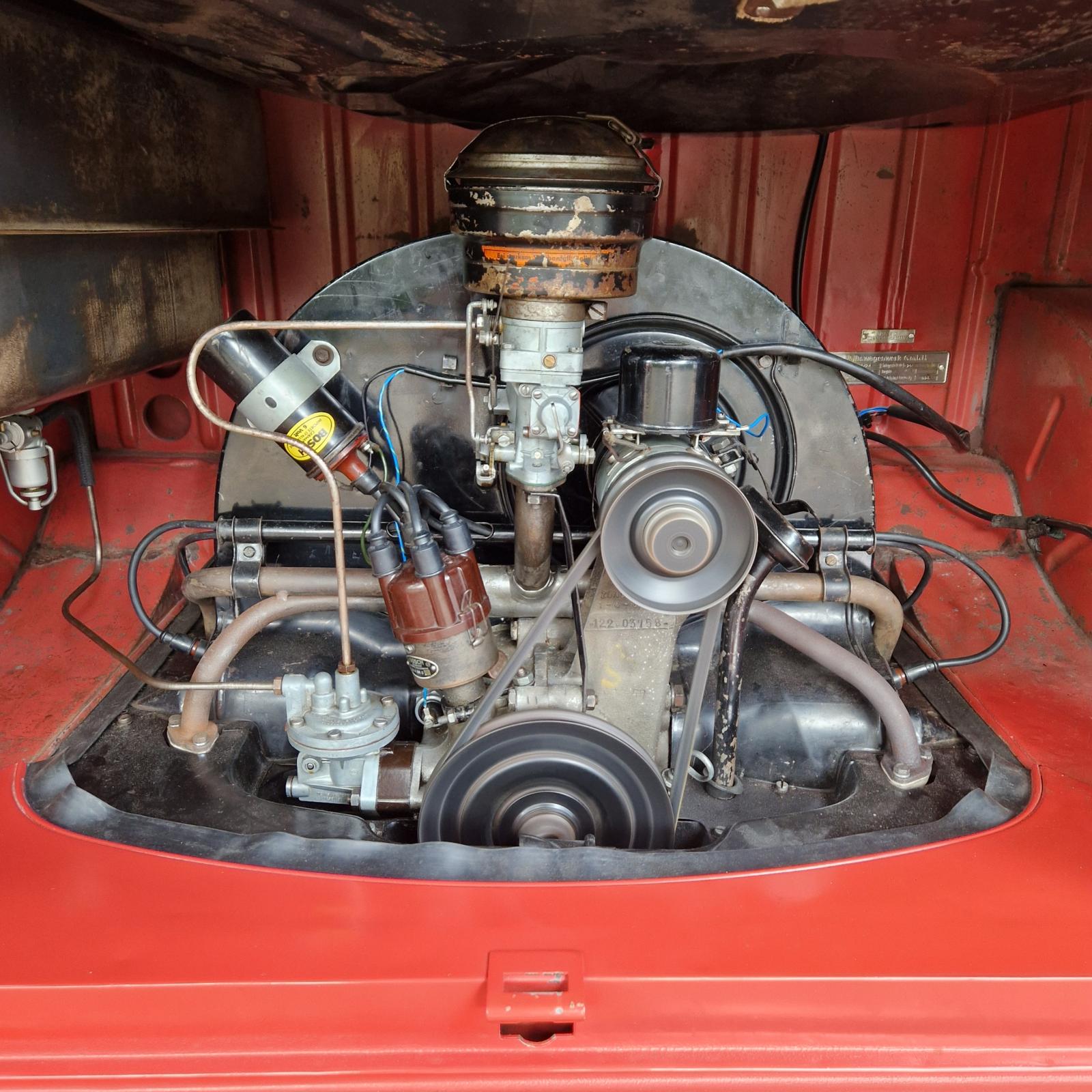

PostPosted: Sun May 25, 2025 10:41 am    Post subject: Re: 1954 & 1955 engines whats not correct! Reply with quote
Oil filler with the removable cap but a strap air cleaner? Weird...
I wonder if that's a square regulator too but it's hard for me to tell for sure from that image.
The early boxier heater boxes are into 1957 sometime.
RockStock
Posts: 4211
Location: England
PostPosted: Sun May 25, 2025 10:59 am    Post subject: Re: 1954 & 1955 engines whats not correct! Reply with quote
It also has the pre55 curved top oil cooler
