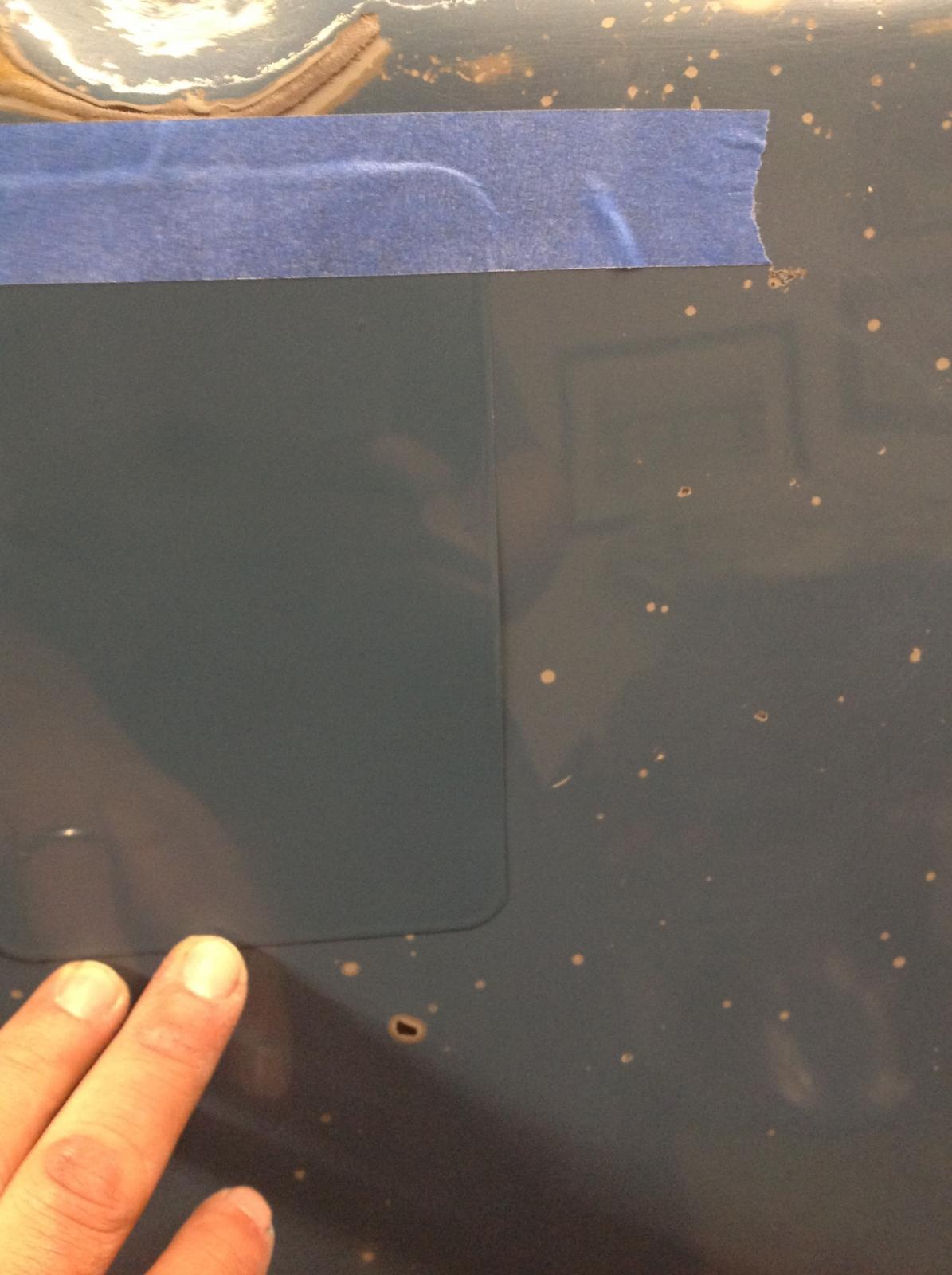

58silvert
Joined: September 05, 2012
Posts: 28
Location: california
58silvert is offline
PostPosted: Fri Feb 15, 2013 9:29 pm    Post subject: Reply with quote
Here is the DoveBlue code and formula from AkzoNobel Sikkens. This is by far one of the best paints out there.
This is a 2 stage, so base and clear coat.
Is made from their autowave MM line, which is the latest ecofriendly waterborne paint. Let me know if you guys need other colors as I will be posting some of the popular ones soon.
AKZO code is FLNA50549
Here are the toner need it
098 41.2g
971 1.1g
575 12.3g
744 23.4g
Activator waterborne 29.2g
This formula gives you 0.10 liters, is what I use to make the spray out card in the picture.
