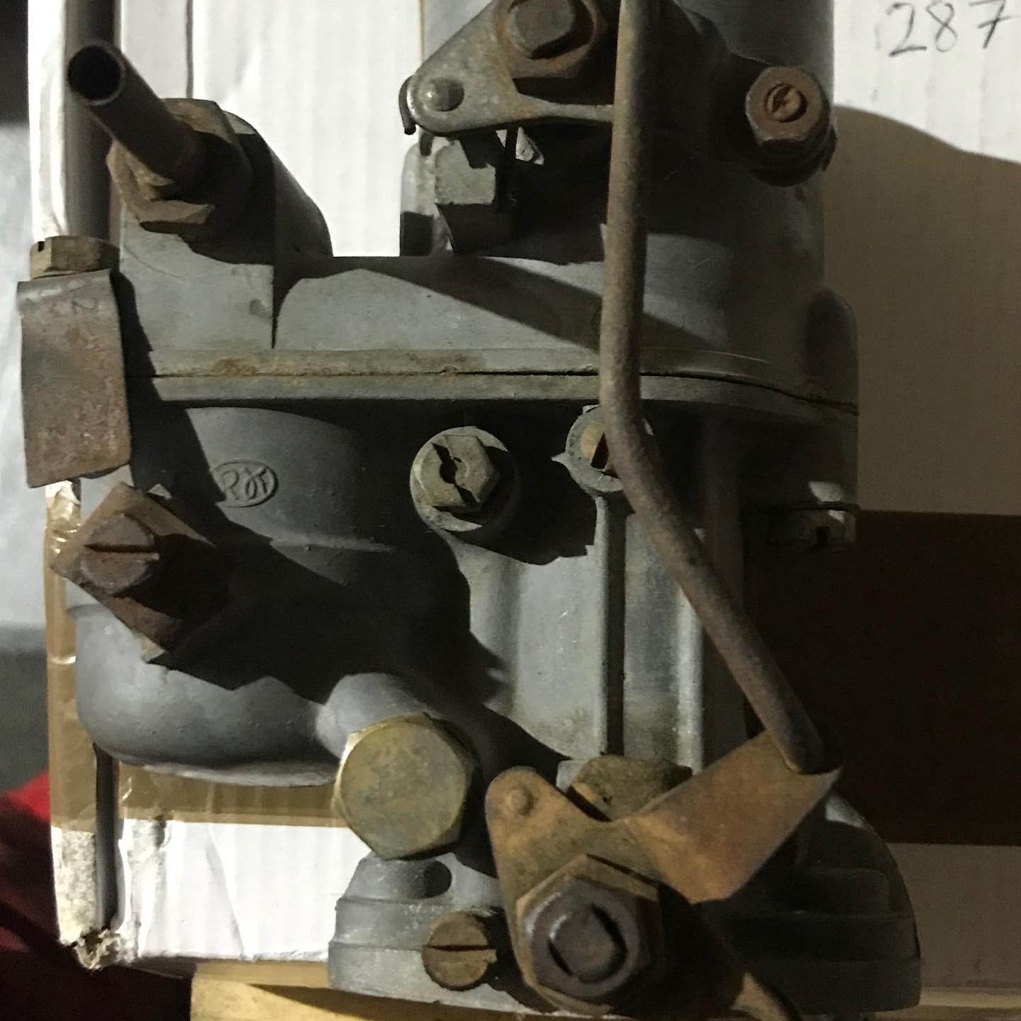

I thought I'd overhaul a 26 VFIS.The home zinc plating kit was a gem.

Home zinc plating kit?

A bit amateur but yes, and fantastic results. https://classic-plating.co.uk/product/zinc-plating-kit/

I would never think of doing this at home.
How did you enhance the carburetor body?

Luckily I have access to an industrial bead blaster.

I used the same proces with less good results - the zinc alloy is still relatively dark.

It looks superb, a credit to you.
Did the plating have any effect on the threaded parts / clearances?

Thanks. No dimentional change, all fitted beautifully.

In my experience you might have the amps too high.

I mean blasting.
