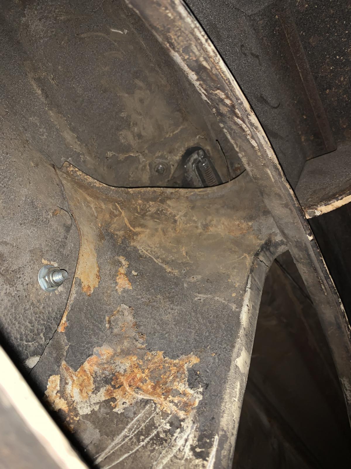

Well, we did get it open but didn’t do a very good job of documenting it. I do have some pictures at what was happening….and I will explain what I did for future reference of someone else in the same situation.
I removed the exhaust and the cool air boot so that I could gain access to the back side of the latch.
While I could reach up and touch it, my direct view was blocked by a support bracket.
I shoved my camera up there and took a picture so that I could see what was actually happening….the locking pin was wedged against the hole…instead of the latch.
I was able to put enough pressure against the pin and then pull the cable….thereby releasing the trunk.
I have removed the pin and am just currently leaving it like that.
I figure I will revisit it when I get to the bodywork step.
Thank you to those of you for your help.

Looks like you'll need to tweek the pin forward a little. Don't know if you have enough adjustment in the "pin mounting plate" or not, as that might give you an alternative way to set the pin location. Just a thought.

Keep in mind the 2 mounting holes for attaching the latch pin to the decklid are a little offset. You may have the catch installed upside down causing the pin to bind in the latch. See this add for photos.
https://www.thesamba.com/vw/classifieds/detail.php?id=2276440
