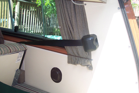

Here you go. Took about 20 minutes to install and clean up last night. Perfect fit and works great. I only installed the passenger side into my 84 Westfalia.
I removed the two small screws that hold the panel along with the screws for the curtain wire and tie back. When I pulled the panel back a little, I could easily see the factory plastic plug in the mounting hole. After a coule of measurements, I drilled a hole big enough to get my phillips screw driver through the panel to remove the plug then I made a clean 3/4" hole with a hole saw to finish the job.

Envious? Envious of what? I'm the envious one: a Touareg, a BSA and standard verts. You must have a heck of a garage. Love the Vespa/Lamberetta. Also, thanks for the pics and info. I had no idea the mount was so far back. Looking forward to making the linolium lizards (kids) a little more safe.

Okay, I just finished installing the driver's side rear seat belt today, and it really is not that bad. I used the Go Westy kit. After installing the passenger side rear 3-pointer, I had a good idea of where to find the mount through the cabinet on the opposite side. I took a couple measurements from the rear mesh screen snap locations, and figured out the rough location of the mounting bolt inside the rear cabinet. After cutting a small hole and then drilling through the panel behind the cabinet, I ended up hitting the plastic bolt that plugs the rear seat belt mount hole. It was perfect, and easy to find.
The retractor ends up sitting in the forward section of the rear cabinet, just below the top shelf. Then it's a simple matter of drilling and cutting the two pass through holes and dressing them up with the rosettes provided. It is a lot simpler than I previously thought. In fact, the hardest part was vacuuming the dust out of the hanging closet from cutting the holes.
The one thing I did not care for was that the belt initially rubbed across a sharp edge of one of the new holes on the inside of the hanging closet. I took a small piece of plastic wire loom, sliced some of it off, and screwed the piece around the inside edge. This ultimately keeps the belt from sliding on this point, and doesn't cheapen the professional look at all.
As for the belt passing through the cabinet, it really doesn't seem too intrusive. It is still possible to hang clothes (if you do such a thing), though the space is reduced some. I end up stuffing my laundry bags and random crap in there anyway, so it doesn't make any difference at all to me.
