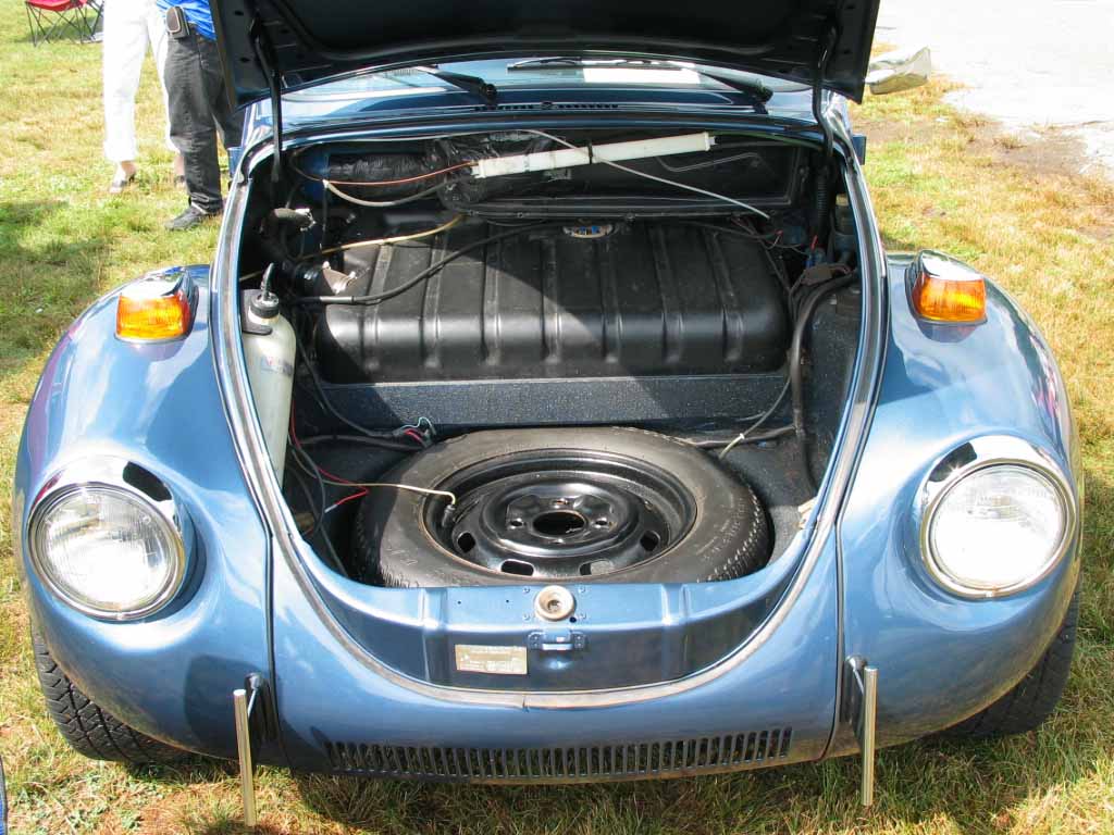

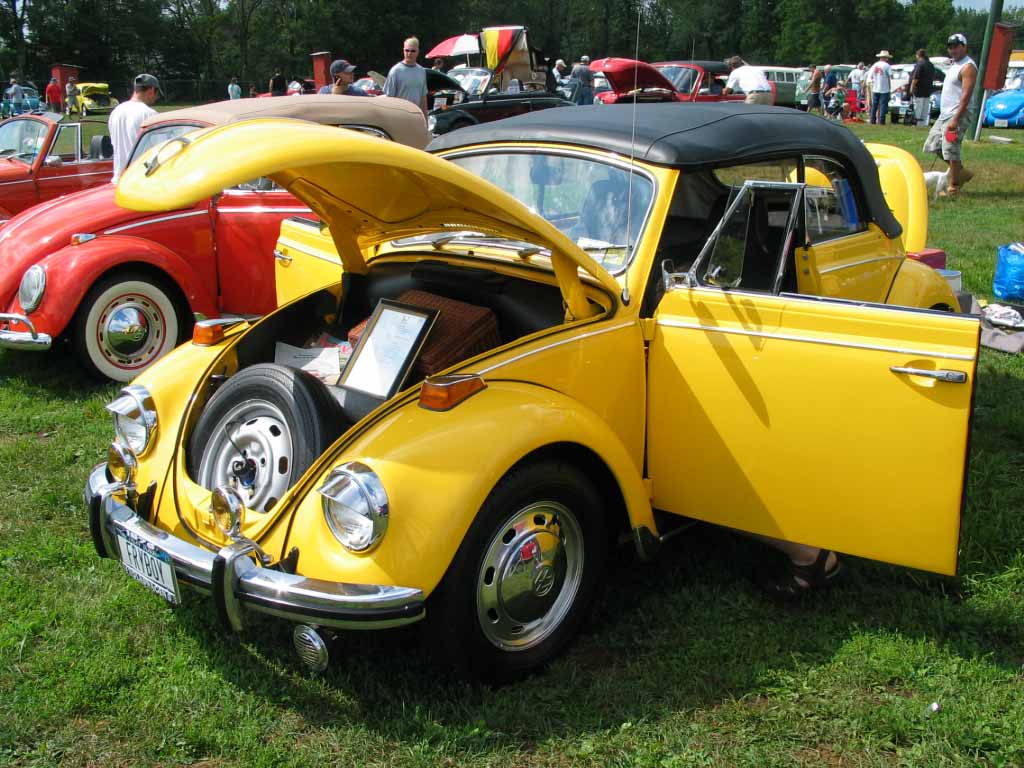

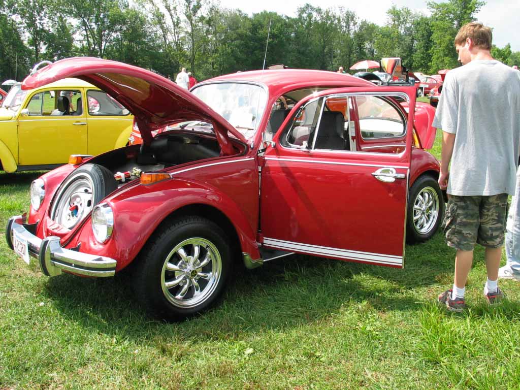

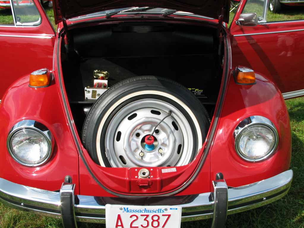

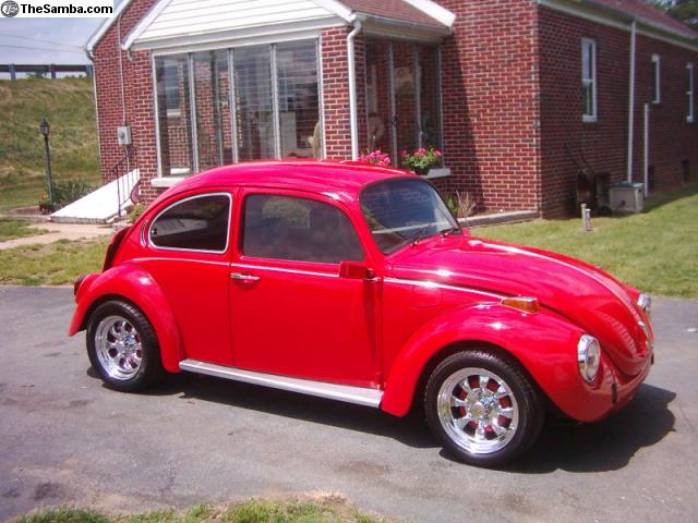

There's been alot of questions about how to tell a Beetle from a Super Beetle so this is to help.
The easiest way to tell is that the spare tire in a Super lays flat while a Beetle stands up.
Beetle
Super
Beetle
Beetle Convertible to 1970
Super 1971-1972
Super 1973-1977
Super Convertible 1971-1972
Super Convertible 1973-1979
