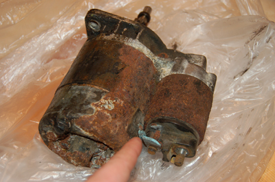

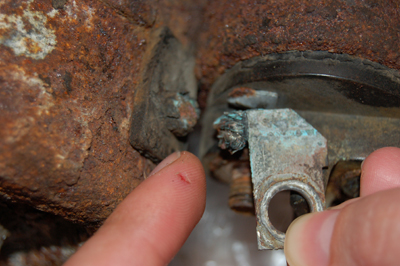

so i may have found the culprit.
i was underneath looking at the wiring to the solenoid and found that the bottom connector that looks like a ground wire ("connection A for field windings" as described on page 27.13 of the bentley manual) was completely rusted, crumbled, and broken off at the base on the side of the starter. i imagine this was why the starter wouldn't crank.
looks like it's time for a new starter, or does anyone have advice on rigging this cable.

PostPosted: Sun Oct 08, 2006 7:24 pm    Post subject: Reply with quote
here's what the problem looks like:
mightyart
Joined: March 24, 2004
Posts: 6188
Location: Portland, Oregon
mightyart is offline
PostPosted: Sun Oct 08, 2006 7:41 pm    Post subject: Reply with quote
Time for a new one (starter), you live in the rust belt?

PostPosted: Wed Oct 18, 2006 7:14 pm    Post subject: Reply with quote
Finally got a remanufactured Bosch starter, put it in...started right up. Nice 'new' sounding start...
