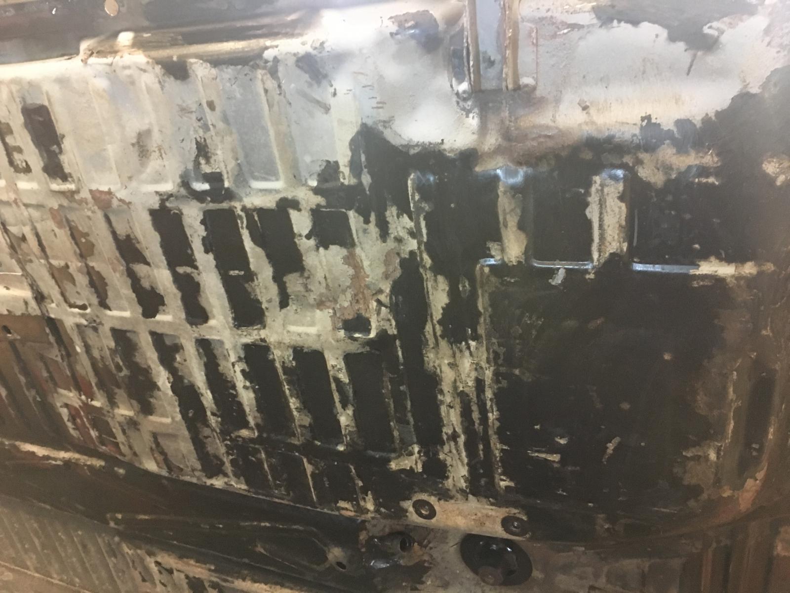

I did not take this car apart, now trying to fix someone else's work. They pulled the shifter cable with the outer casing. I just can not find the way the cable goes into the tunnel. I know the pan has been changed, could it be a standard and not have an opening?

Mike, both inner and outer casing were removed. The bently booh shows it going under the torsion tube.
is it posable vw did the same to the t3 as they did to the t1 in the early days. make 2 pans,1 auto and 1 std?
I have spent hours to find an image of some sort.
Thanks, Jac

at the trans end i have these
clamp sleeve
clamp bolt
washer
hex nut
bellows
The cable is intact
looks like I am going to have to find another car to look at.

PostPosted: Tue Apr 18, 2023 9:09 pm    Post subject: Re: type 3 full auto Reply with quote
You can kinda see where the cable comes out in these pics.
Jason37
Joined: April 21, 2004
Posts: 1047
Jason37 is offline
PostPosted: Tue Apr 18, 2023 9:26 pm    Post subject: Re: type 3 full auto Reply with quote
And if you look closely you can see the tube in the center of pan just before the subframe mount.

PostPosted: Wed Apr 19, 2023 9:37 am    Post subject: Re: type 3 full auto Reply with quote
Lift up your shifter and you can see how the cable hooks to it.
So, now you know how both ends are routed/attached! Wink

I want to say thank you all for all the help. it turns out my pan is a standard.
Now I can move forward with this mess
Thanks Jac
