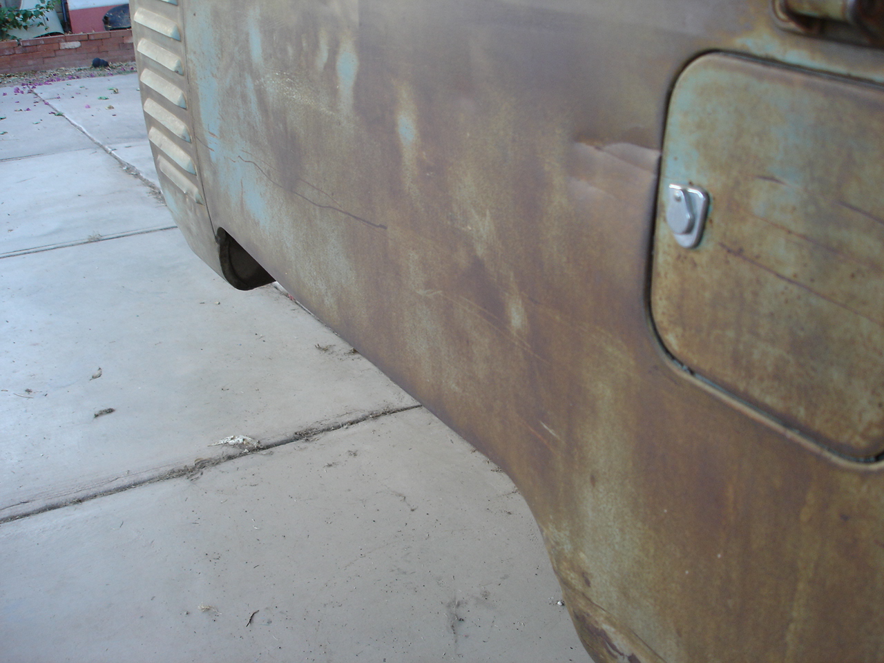

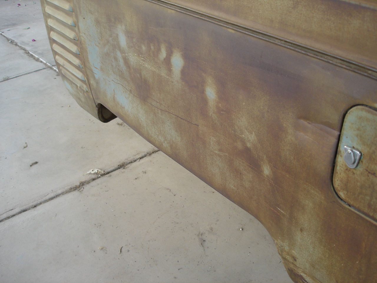

Not visible:
Maybe if my Truck was shiny.
Can you feel them? It looks like a different pattern of patina along the spot welds which would make me think that they are there.
Posts: 71684
PostPosted: Tue Nov 07, 2006 8:55 pm    Post subject: Reply with quote
"Not as visible" I guess would be better. I can feel a couple of them but not all. You can see the circle ridge more.
Here are 2 BIG photos if you want more detail:
http://www.thesamba.com/vw/scrapbook/54truck/20061107/DSC08892.JPG
http://www.thesamba.com/vw/scrapbook/54truck/20061107/DSC08893.JPG
