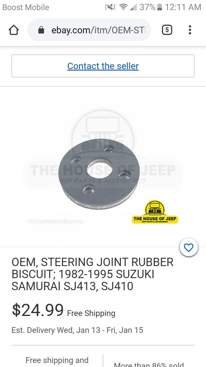

I actually emailed th3 seller asking if they had anything for type 3s! Cause for what's it's worth migbt just being easier and cheaper to just cut the battery, and I have gone through 2 optima batteries in 2 years maybe less since tu3 rest mod was done on the car.

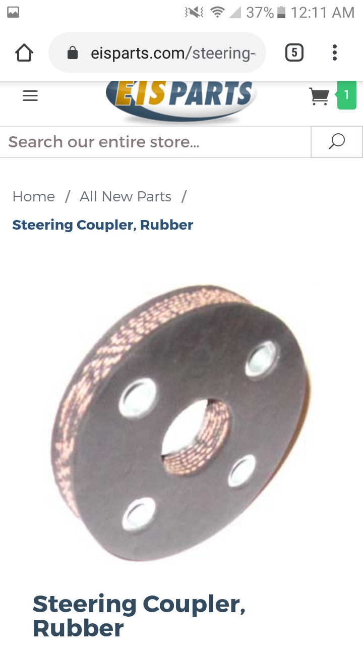

i thought it better to find the cause of the battery drain than resolve it with a cutoff switch. the cutoff switch is probably also a good idea for security purposes if its hidden somewhere but if you forget to turn it off when you get out of the car you will still have a flat battery in a week or two.
since i have replaced the steering coupler disc with a non conductive one the panelvan can sit for a couple of months and still starts ok.

Quick update, I checked coupler and I do not get thay power issue you were getting, so I am back to being stumped on this thing! It really gets to me cause I just got a brand new battery and I have it unplugged when car is off and it's very annoying having to connect and disconnect it. I do have a clock, it doesn't work but it is wired.

How has your battery been holding since your couple change? I might be checking wrong,but I might be switching the coupler just do it. Which couple did you end up using?
In your thread I found 2 type, in the post I curious which one worked for you

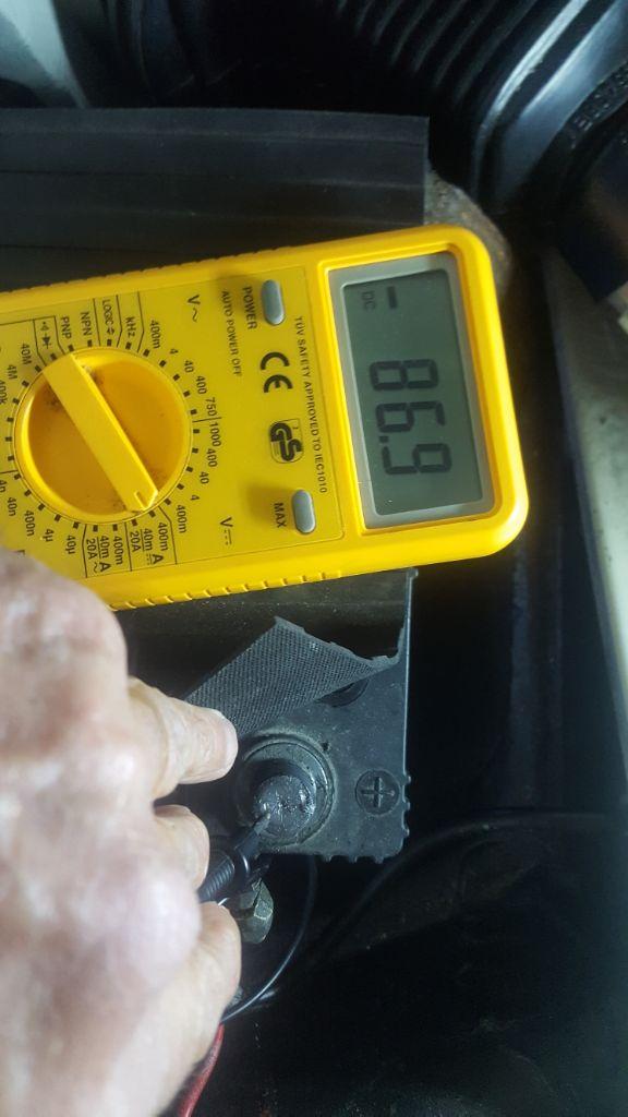

PostPosted: Thu Jan 07, 2021 12:56 am    Post subject: Re: Battery cut of off switch? Reply with quote
you will need to check current drain at the battery with a meter set to amps or milliamps. i disconnected the positive lead from the battery and with everything turned off in the car (clock,radio,interior light etc) you should have no reading.
as you can see from the pic i had a drian of 86.9 milliamps.
whith this reading on the meter you have to pull the fuses 1 at a time to determine which circuit is "leaky"
see how this goes

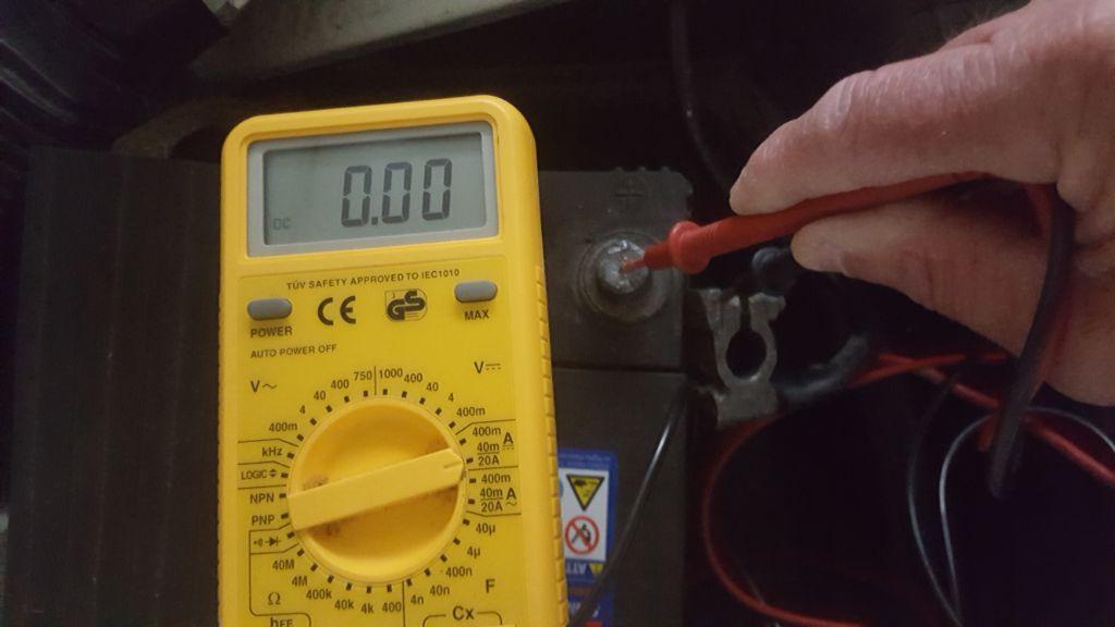

PostPosted: Thu Jan 07, 2021 12:57 am    Post subject: Re: Battery cut of off switch? Reply with quote
i have a pic after i fixed my issue with no current drain. eg 0.00 milliamps.
Is was after you installed the new coupler right?
Which coupler did you end up getting? I'm going to move ahead an order one and hope for the best cause I exhausted dealing with this.
see how this goes
