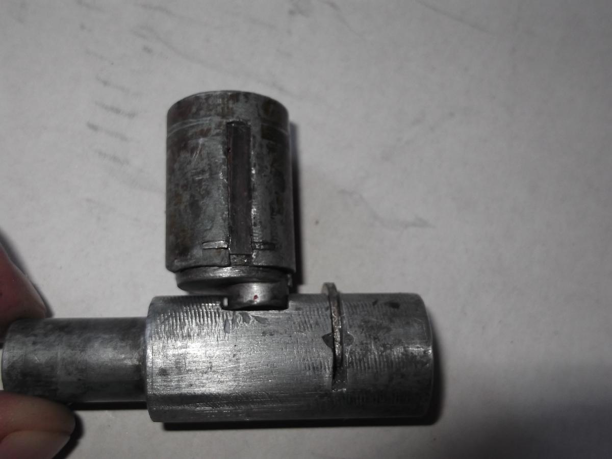

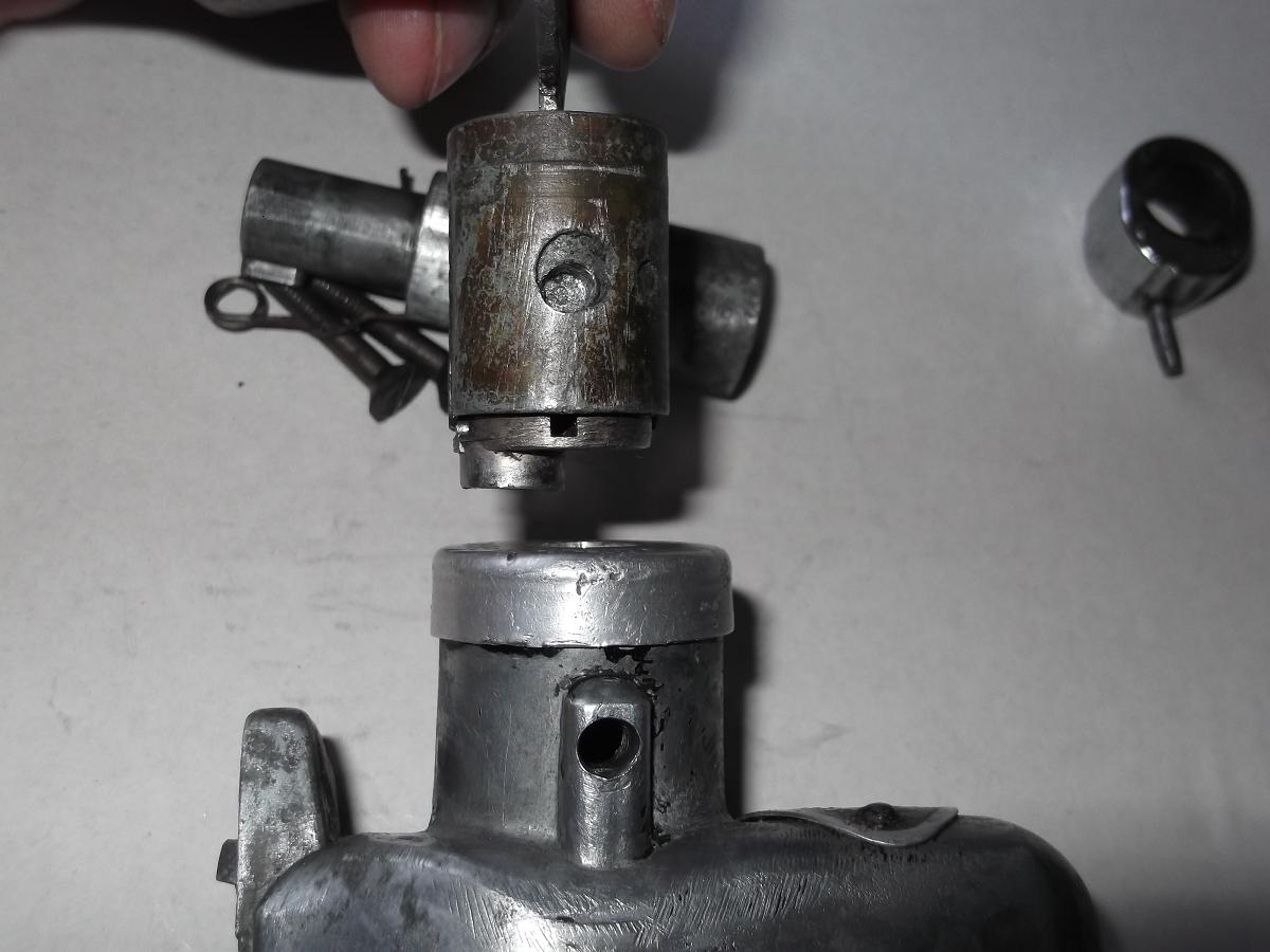

Ok, so here's the dismantling process.
1. undo the 2 slotted bolts. use a sharp screwdriver to avoid damaging the slot. sometimes these get stuck. i used a portable drill with a screwdriver bit, using the torque settings. after a few attempts they broke loose.
2. this is the electric contact setup: the inside bakelite piece pivots on a pin, providing contacts from BATT. to INSTR and ZUND. so, it provides electricity to start button/ignition and instrument panel. hints: please check under the triangular brass piece. there are 3 small springs. mines were corroded. to test that the contact piece is still ok, put it inside and gently press the cover. you should feel some spring resistance there. also some contact cleaner/fine grit sandpaper takes out the corrosion on contacts.
3. now here's what's under the cover: the spring that pushes against the pin is easy to take out. first pic shows the contact in the ignition position. now you can move the EIN/AUS lever. the second shows the contact in stop position. now the EIN/AUS lever can't be moved.
HINT: do NOT try to rotate the lever in the lock position. you will break it. ask me how i know that. Crying or Very sad
4. you can see here how the inside piece moves. from left to right, and does not rotate. in the locked position the EIN/AUS vever will not move so it prevents starting the car. (well, is not easy to make a short on the back of the electricity panel Razz ) also the steering is locked in position as the steel pin in the front is inserted in the oval slots of the lock device on steering shaft.
5. now to attack the lock cylinder. the aluminum bezel with STOP/GARAGE/FAHRT is just pressed there. with a small flat screwdriver tap the edges lightly and it will pop out.
in the "finger" casting there will be an aluminum rivet. you have 2 options. one is to drill deep and then remove the cylinder. as i later found out, the aluminum rivet just protects the slotted head of a small pointed bolt. carefully remove the aluminum rivet and with a small screwdriver undo the pointed bolt.
6. here's how the lock cylinder sits inside: has an eccentric area that moves the inside piece from left to right.
7. the inside piece has a small metal piece that holds the steel pin inside. if you get that part out, the front steel piece must come out. mine is still a bit stuck, moves only a few mm. that steel piece is spring loaded so it should come out easy
8. various pics: the key is a F profile, made by HUF. i think Beetlekey has some new units for sale , but on his website he said he can't have a key cut by code number. i am sure that if you just take out the lock cylinder to a decent locksmith he can cut a key for you based on present configuration.
you can also see the EIN/AUS lever that i broke, not knowing it was in the locked position. i'll have to think creative and make a hole inside to fit a threaded bolt, then use some strong adhesive. the metal that is made of would surely not withstand welding techniques.
also you can see a checklist of all the parts you need to have a functional Huf steering lock.
this lock that was opened up for resto/learn purposes will be sold, i'll just keep the brown one for my split.
Have fun!
