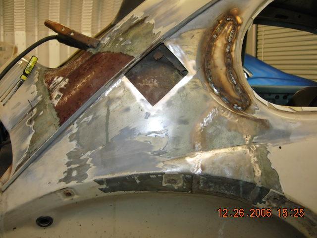

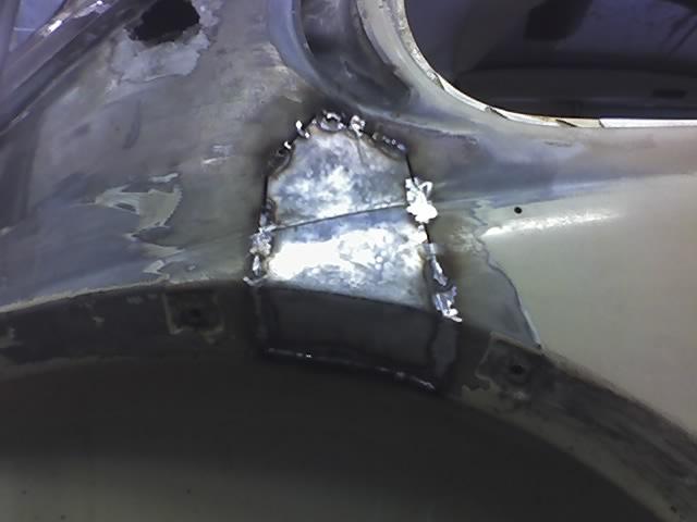

Here are some shots of it today. I have done some patching recently. I made my own patch panels for the rear side crescent vents, as well as all other rust repair areas around the rear window.

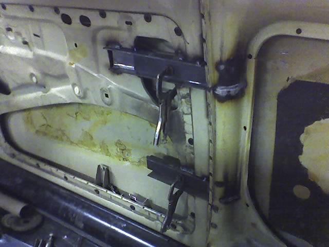

I have the driver side suicide door almost completed. It is fully operational. The hinges fit completely inside the B-pillars.
Yes I know the rear of the B-pillar where the door panel goes is bent open a little. I had to get access to a piece I forgot to cut out that restricted my ability to remove the hinge pins. The hinges come out so the pockets can be painted fully.
Ok, thats what Ive got so far. I am hoping to have the metal work done soon so I can sandblast the car and get it into epoxy primer before it gets too cold here in Florida.

Good eye on the torch. Yeah, I used it to clean up the the joint of the quarter to cowl area. The quarter I took off was the one I put back on. When I got the car there was large portions of the old quarter still on, under the *new* quarter. The new quarter was removed correctly from a donor car, so I just had to lift the pinch, cut off the old and reinstall the new quarter like it was supposed to be. At the joint up top, they cut the new quarter short so I had to do some grafting to make it work. I was going to smooth that parting line anyway, so I blended it over with a new piece, and it has a hammered line to replace the old seam, only it will never crack because its one piece.
For lifting the pinch I used an old screwdriver that I ground into a chisel tip. I started at the bottom (easy with no running board) and worked my way up. I only opened it about 90 degrees from closed- just enough to get in there and remove the old/ install the new. I didnt want to crack it by work hardening it too much.

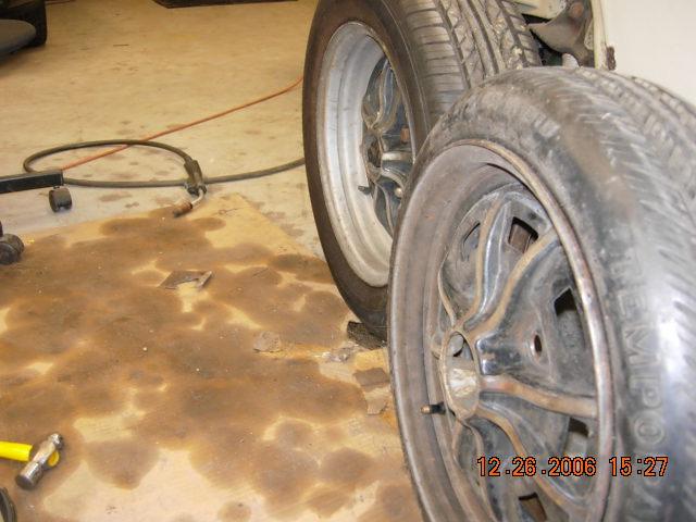

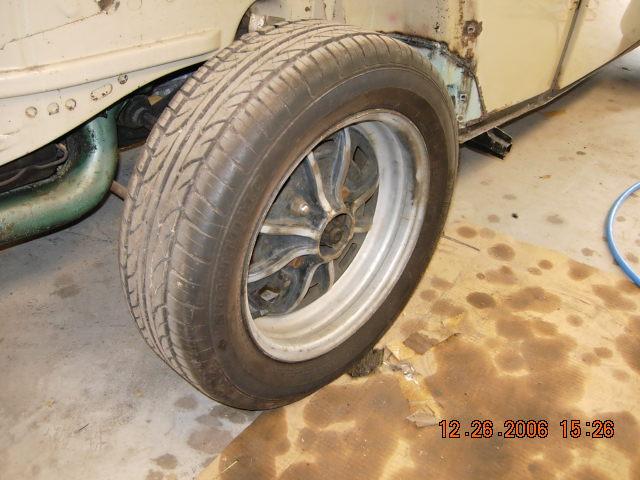

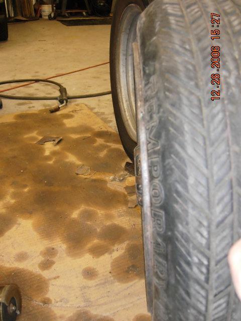

I thought I would add some pics of my wheels. They started out as 15x 5.5 sprint stars. There was no way that the front were going to fit inside the fenders, so I had to cut them up. I reversed the rim, and offset it as much as possible to tuck it in. The center now protrudes past the rim lip. I think they look cool, and when they get caps they will look even better. I turned down stock caps, because I plan to make my own out of billet steel. (steel because I have it, otherwise it would be aluminum)

nice man but it needs to sit lower if it is going to look anything like that drawing. Very Happy Going to bag it?

Air ride is not in the plans. As it sits right now, the front is pretty low on the adjusters, but it still has 165's on it. The rear is at stock height. Its easier to work on it higher up. It will get lower, trust me. I might go the air shock route, just because I have two kids and if we all ride I want to stiffen it up a bit. Im not looking to replicate hydraulics, just to have a little height and weight adjustment.

Here are two pics from my camera phone, showing the pass side suicide door hinge being installed, and some metalwork to the pass side quarter.
