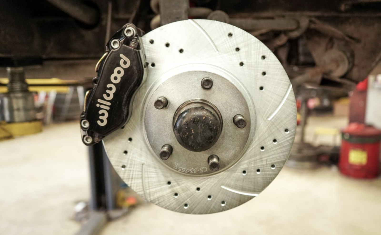

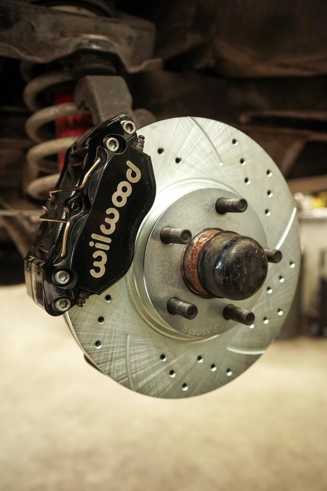

As the team at SCP continues to drive new product development, we are excited to announce our Wilwood Front Disc Brake Kit. These are 4 piston calipers with improved stopping power from our brake it and any of the other kits on the market.
https://smallcar.com/wilwood-front-disc-brake-kit-vanagon/
As Vanagon users, we are always looking for ways to improve, upgrade, explore what is possible. We have a rear kit coming in the next month to round out our performance brakes.
Fitment note:
-works with many 15" wheels (please post your fitment confirmations in the comments here!!)
-we offer a SCP upgrade version for existing G60 style customers
Thank you for the support!
Austin

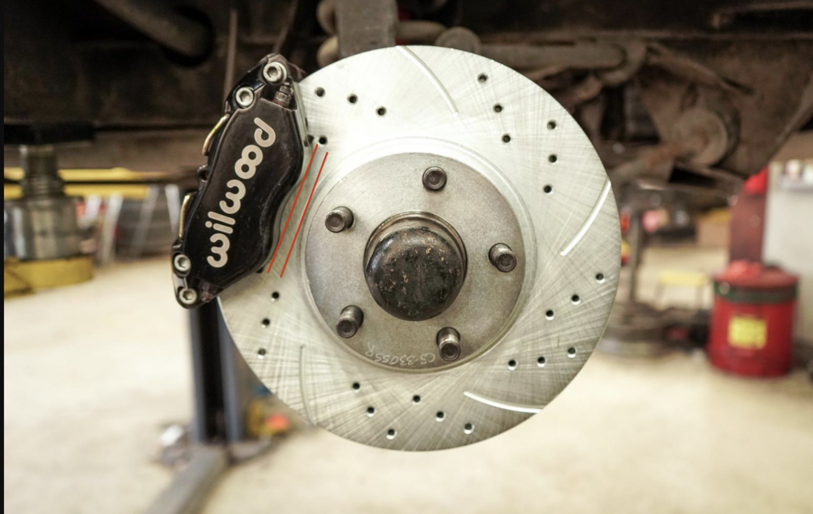

PostPosted: Sat Dec 23, 2023 9:36 pm    Post subject: Re: Wilwood Front Disc Brake Kit: Vanagon Reply with quote
This looks like a solid option especially using wilwood calipers. Nice work!
My only questions is it seems in the photos that the wilwood calipers used are not quite deep enough to maximize the surface area of the rotor. If these are 288mm rotors I would I think you would want to maximize that surface area.
Whats the measurement between the caliper and usable rotor surface?

PostPosted: Sun Dec 24, 2023 4:47 am    Post subject: Re: Wilwood Front Disc Brake Kit: Vanagon Reply with quote
Wilwood - great idea.
Caliper depth - could this be that SCP used smaller calipers to allow use of 15¨ rims? They seem to be one of the smaller calipers Wilwood offers.
On the other hand - 8 piston carbon-ceramic might be overkill

If i remember from my reseach, the brake pads can be removed without removing the full caliper. That is a huge pluse in my book. Dont know if its the same with the claipers shown.
