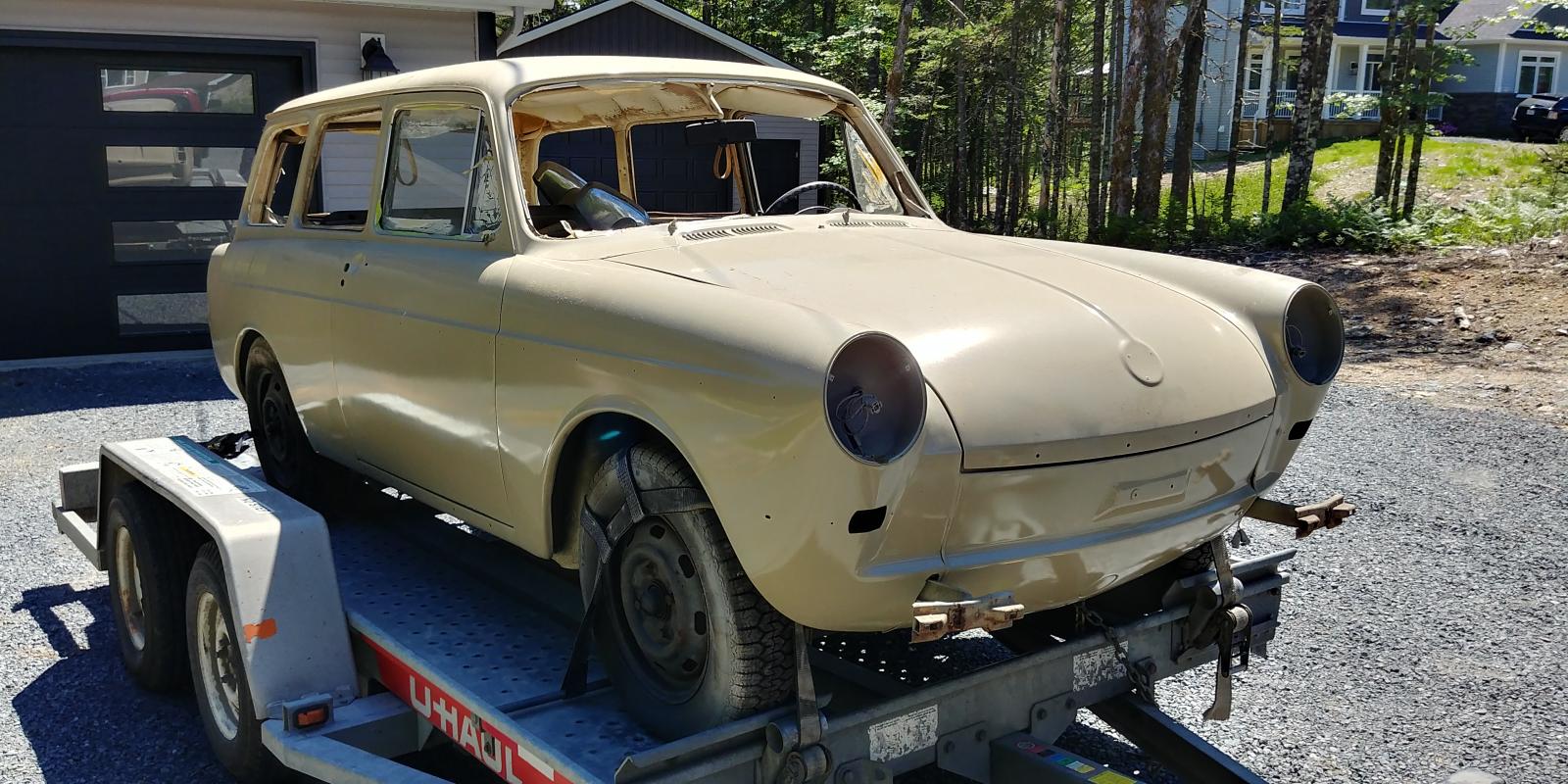

So I bought a car. It will be a project to keep me busy now and during the winter.

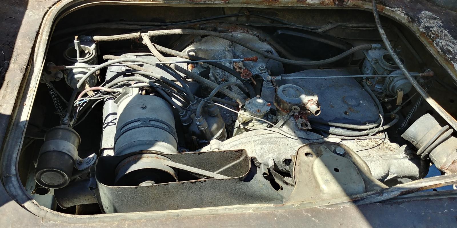

Here is the engine. I am not sure what exact kind it is. It doesn't have a lot if miles on it since it's last rebuild. I'm new to carburettors so it will be a learning experience.
A bit of figureing out here.

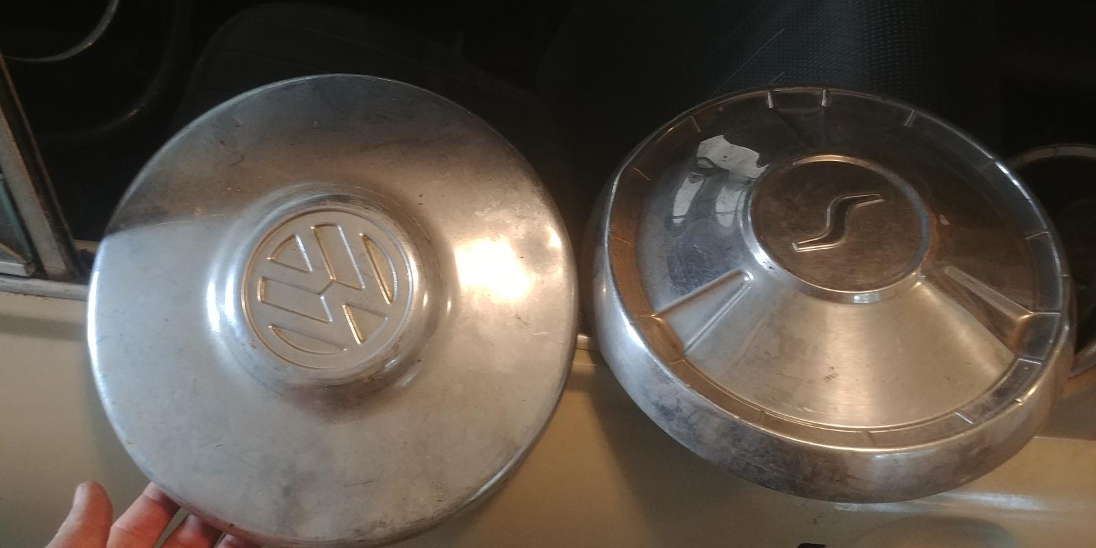

There are 4 of the one on the right and two of the one on the left. The wife wants the one on the left. Anyone know what the one on the right is?
Over all it seems in decent enough shape. It's going to need a new windshield, all new rubber everywhere, new dash, 2 front seat covers, carpet, and probably the usual stuff on the engine. This car hasn't really moved in about 15 years. Paint is new. Most of the parts are inside the car, the only thing I can't find is the turn signals for the 2 front corners and some trim pieces.
This should be an adventure.

Looks like a good solid project. By the way that other hubcap is from a Studebaker. Looks like you have the correct '67 style hub cap in good shape.
old_man
Good to know. I actually only have 2 of the VW ones. Looks like I need to look for another 2. I also need wipers. What kind of front turn signals do I need/will fit?

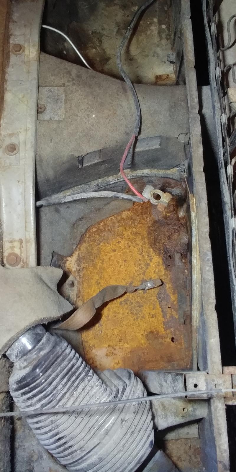

Seller warned me the battery tray was rusted out.
It's got 3 or 4 small rust holes but overall I was expecting much worse. It still can hold a battery but some remediation is probably required. Still happy with it.

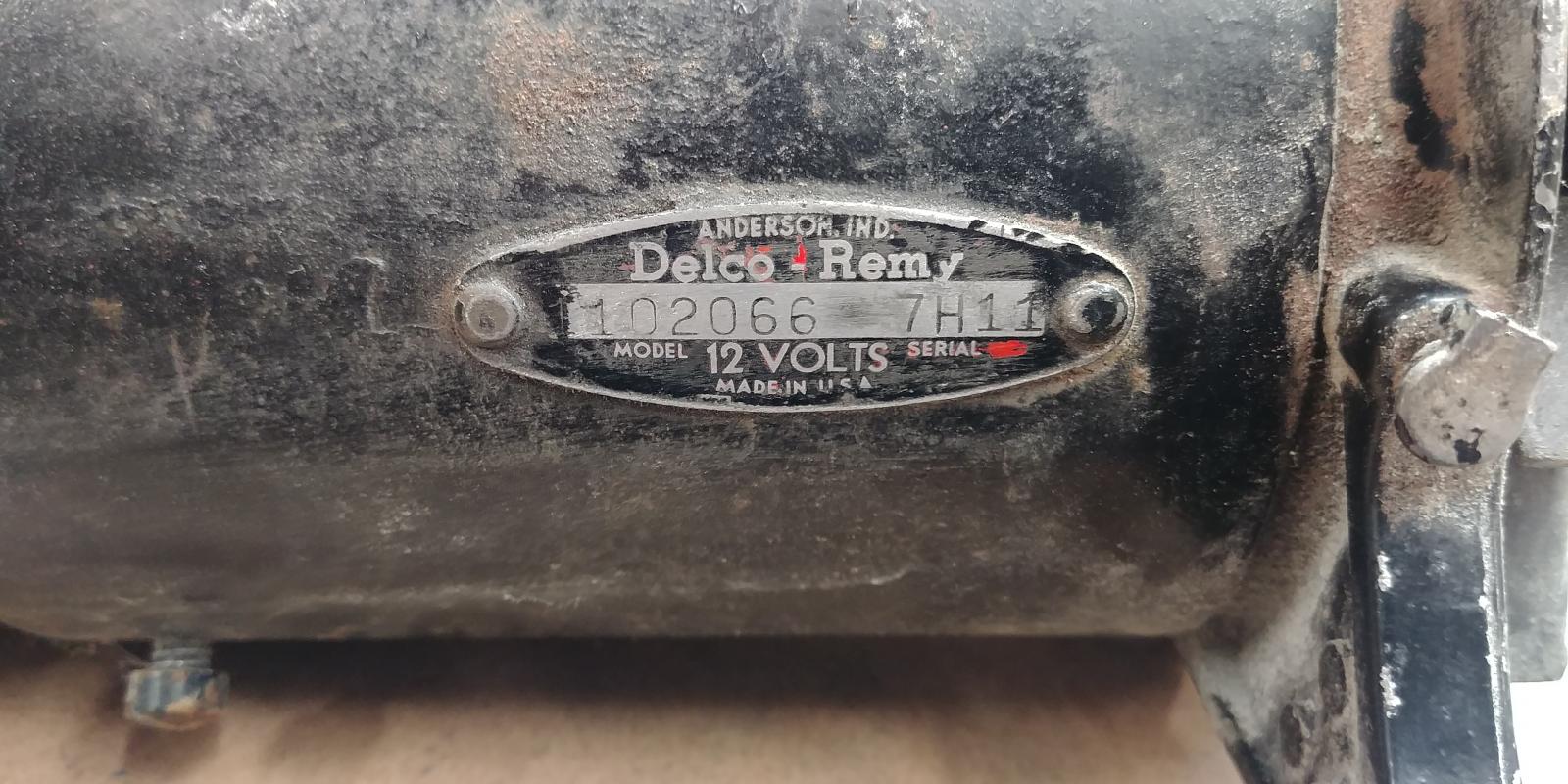

I found this alternator/generator. Anyone know what it would be? Was part of a plan to do an alternator conversion?

PostPosted: Sun Aug 05, 2018 8:40 am    Post subject: Re: My 67 Squareback Reply with quote
That Made in USA generator is not meant for a VW. A lot of chrome etc molded off your '67! Did you get any of it with the car? It would've looked like this '67 originally. You're missing the big black stock air cleaner on your engine.

PostPosted: Sun Aug 05, 2018 9:36 am    Post subject: Re: My 67 Squareback Reply with quote
Like Mike said, the Delco generator is from a mid 50'sto mid 60's GM (Chev, Pont, Buick, Olds).

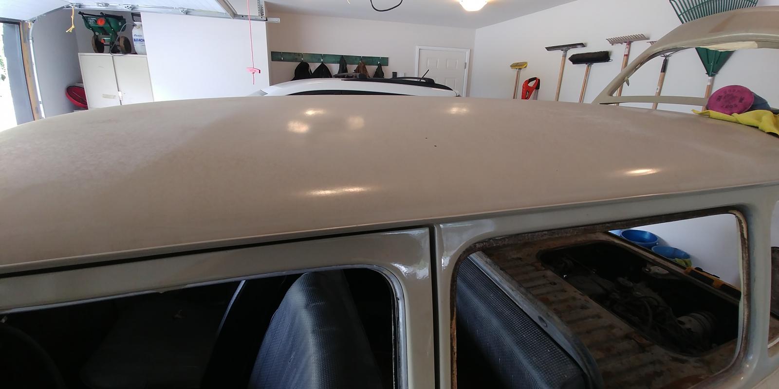

I also noticed that there are holes on the roof. I can only assume that these were for a roof rack. So I guess at this point I either have to patch the holes (I really don't want to) or find me a roof rack that fits. Any of you fine people have any idea what roof rack would line up with these holes?

PostPosted: Sun Aug 05, 2018 5:19 pm    Post subject: Re: My 67 Squareback Reply with quote
It looks like those holes would line up with a VWOA dealer accessory roof rack.

PostPosted: Mon Aug 06, 2018 4:47 am    Post subject: Re: My 67 Squareback Reply with quote
I was looking at those earlier and it did sort of look like it could match. So now I either have to find one or plug the holes.

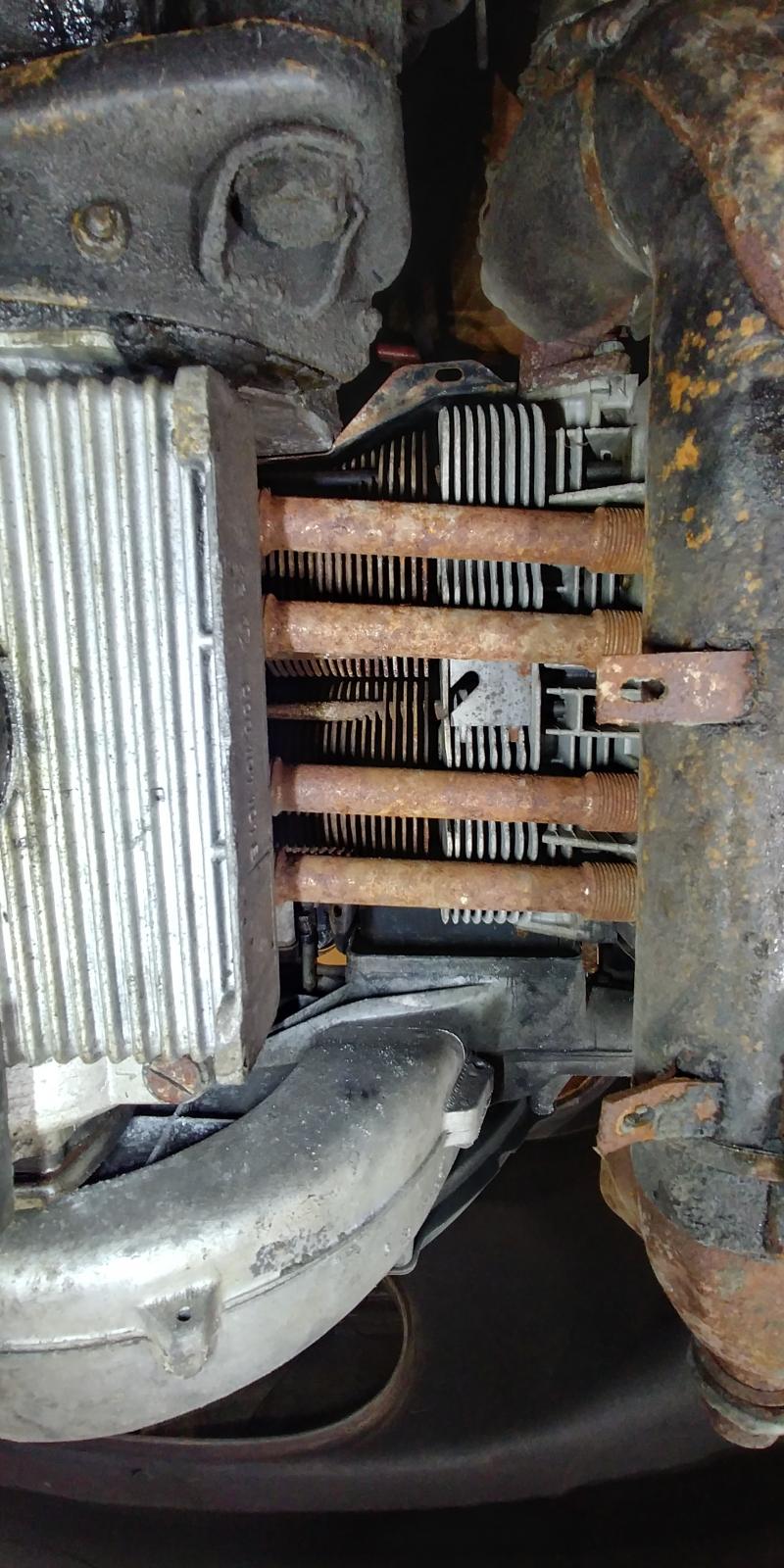

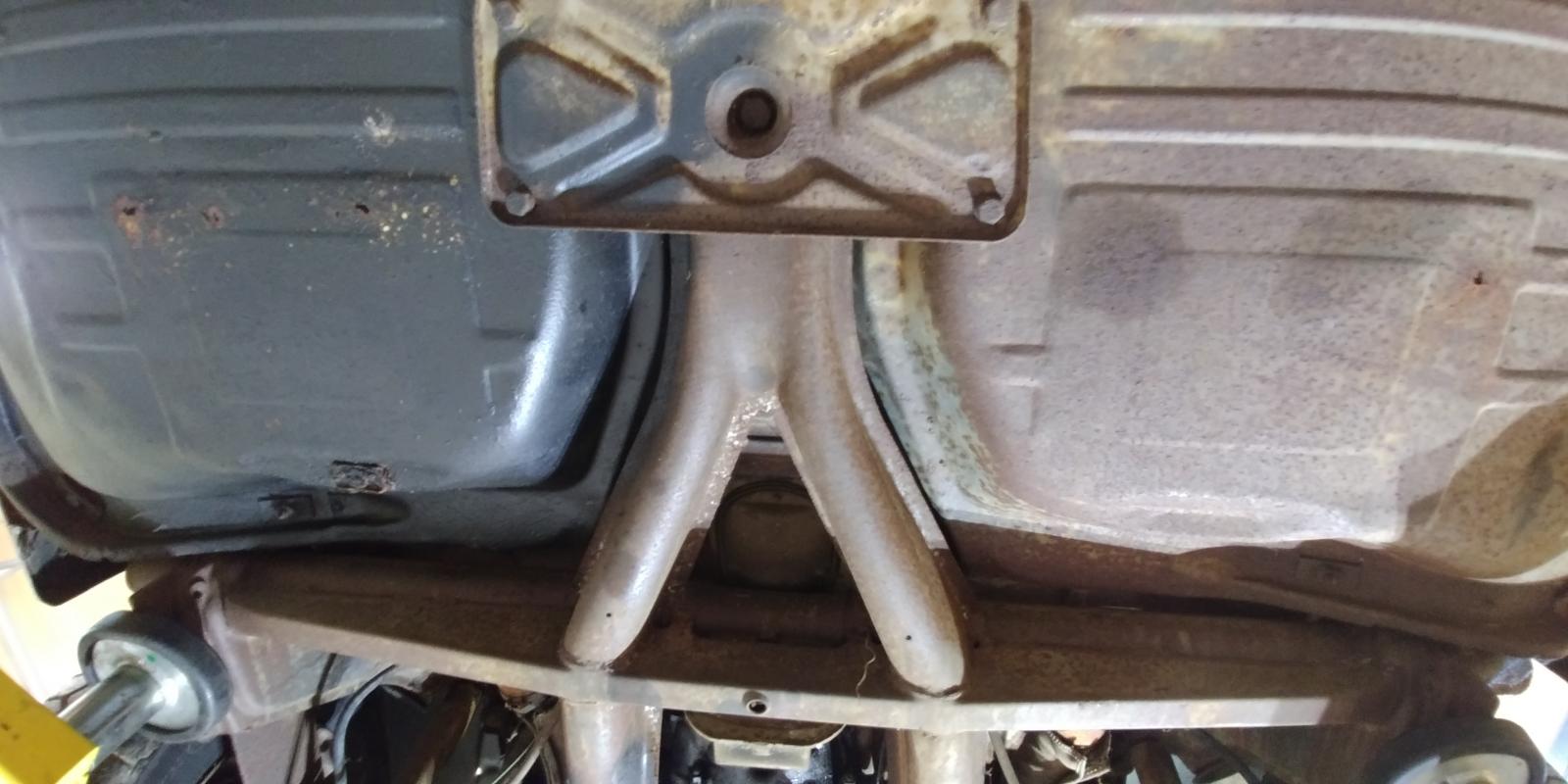

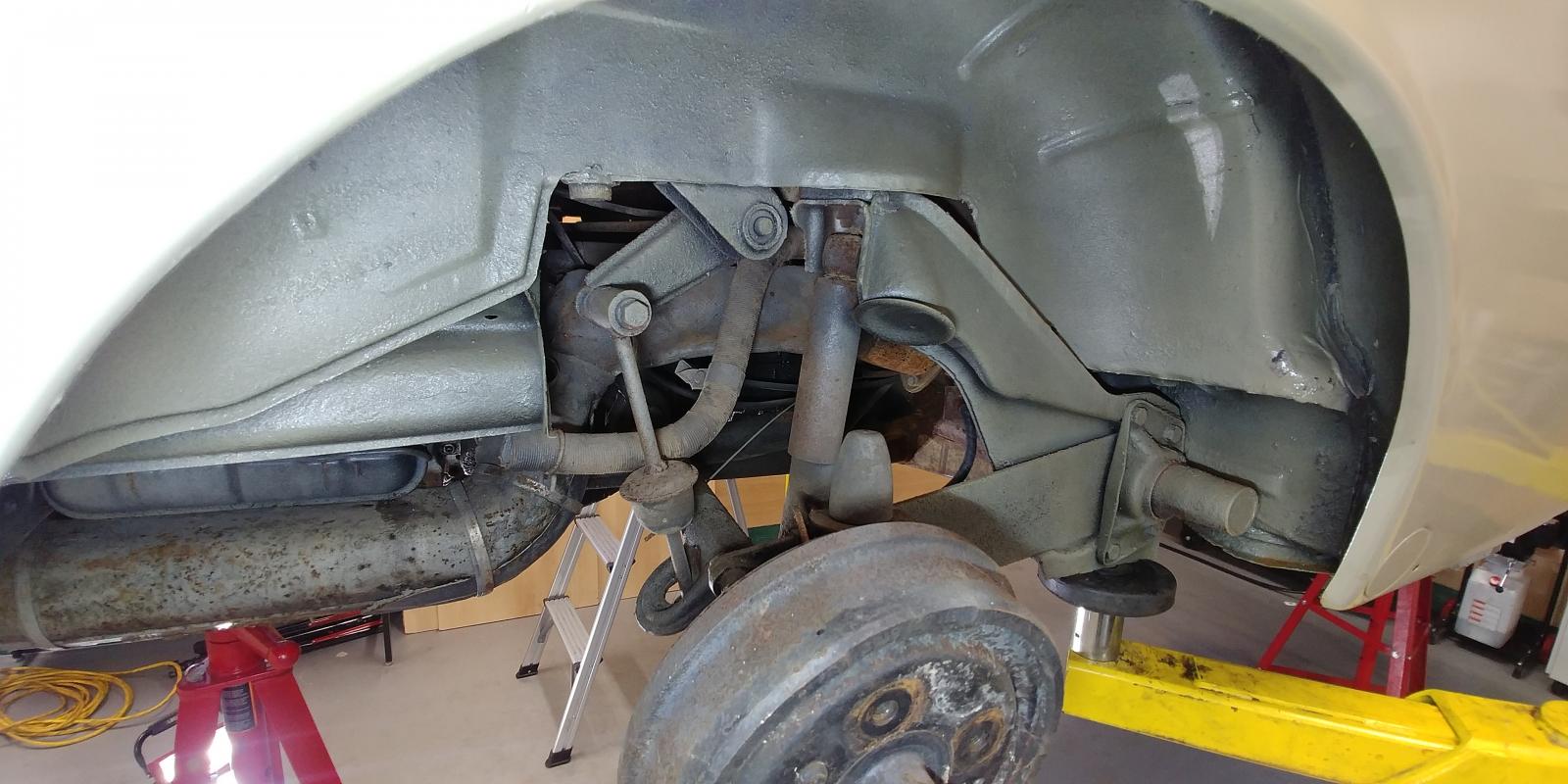

So I finally got it up on the hoist. Underneath looks decent to my untrained eyes. I am just going to post a bunch of pictures of the underside and wheel wells. Please tell me if any of you spot something that needs addressing.
To me it looks like the rubber bushing 'cold flowed' and needs to be replaced. This is common on porsches after a few decades. Is this the case here?

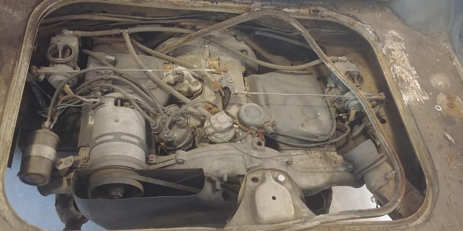

Can someone tell me exactly what engine I have in here?
I have had these sitting in my garage for years not being used. Bolt pattern is wrong and I am not sure the bore is big enough. What do you think?
Also here is a video of the muffler that came separate. Is this normal or how is it exactly suppose to fit/tighten?
.....still happy.
Tthis looks like the rubber bushing 'cold flowed' and needs to be replaced. This is common on porsches after a few decades. Is this the case here?
.....still happy.
The bottom looks pretty good for a 51 year old car.
Yes, those bushings probably need replacement. Since you're familiar with Porsche's, most of the same stuff applies on VW's.

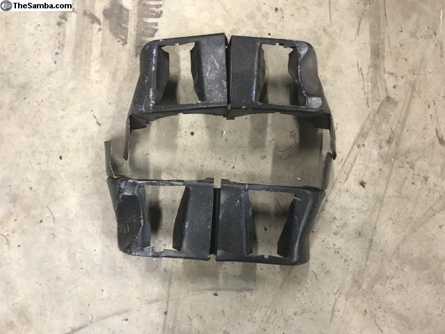

It looks like someone forgot to install the under cylinder/above the push rod tubes on that engine (at least the 3-4 side). Don't know about the other (1-2) side.
As far as what size engine it is, there's no way of knowing without pulling a cylinder head.
The "Cookie cutter" rims do look good on a type 3, and others have used them before. You'll have to get the drums and hubs re-drilled for the Porsche pattern, and either drill the fronts or buy new rotors to use them. Pay attention to the offsets IF you decide to lower the car!!
As for that muffler nut, you'll want to replace the copper gasket inside, and then use a thin 46mm wrench to tighten it (preferably on the engine for alignment).
I hope this helps.

old_man
Joined: June 19, 2018
Posts: 1414
Location: Newfoundland
old_man is offline
PostPosted: Mon Aug 06, 2018 3:27 pm    Post subject: Re: My 67 Squareback Reply with quote
Sorry, what did they forget to install?
KTPhil Premium Member
Joined: April 06, 2006
Posts: 36421
Location: Conejo Valley, CA
KTPhil is offline
PostPosted: Mon Aug 06, 2018 3:40 pm    Post subject: Re: My 67 Squareback Reply with quote
The little air deflectors that fit the underside of each cylinder pair. Really bad for engine cooling to not have them! You have to loosen the heads and remove pushrods/tubes in order to install them (bummer).
https://www.thesamba.com/vw/forum/viewtopic.php?t=687067
Either these (like on the bug or early cars):
...or better yet, these (aka, "cool tins"):

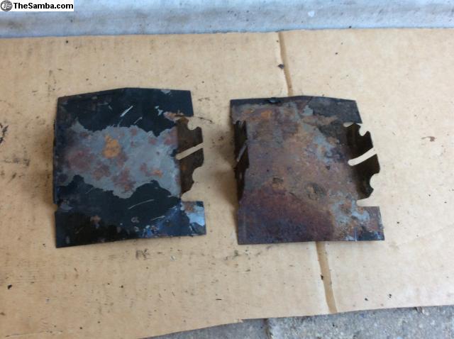

These things?
Am I missing anything else?
I found these three pieces of metal. I think the two on the right are for near the rear wheel but I don't know what the one on the left is for.
Posts: 36421
KTPhil is offline
PostPosted: Mon Aug 06, 2018 5:21 pm    Post subject: Re: My 67 Squareback Reply with quote
https://www.vwispwest.com/pg90
You are looking for items 25 (preferred over 7 on a Type 3), and also check for others like 3, 4, 11, 12, 22, 23 which may also be missing. All are vital to cooling!
I don't think any of those 3 pieces in your last photo belong. The leftmost is a pulley tin for a Type 1 or 2. I don't recognize the right two; part of broken mudflap, maybe?

PostPosted: Mon Aug 06, 2018 5:38 pm    Post subject: Re: My 67 Squareback Reply with quote
old_man wrote:
Hard to tell from the photo angles - but, it looks like the front holes don't line up with the door gap. There's a roof support piece (above the headliner) that's centered with the door gap which should take the weight of the rack and cargo, instead of the sheet metal roof; while the hatch hinge support takes the weight of the rear. If the front mount holes aren't in line with the door gap, I'd patch them up; otherwise you'd be risking denting the roof if you carry any cargo on the rack.

PostPosted: Mon Aug 06, 2018 6:39 pm    Post subject: Re: My 67 Squareback Reply with quote
I definitely do not have 22 or 23, those are called the lower or sled cooling tin correct? I will look at 3, 4, 11, and 12, tomorrow.

[quote="BSQUARE"]
I'll take a look tomorrow. I have the headliner completely out so it should be easy to see where the holes go. It could have also been installed incorrectly.
