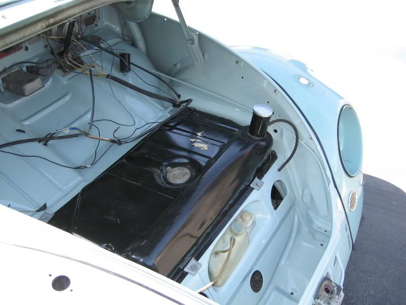

Chassis would be built in Dec '59 (a 1960 model). Mine is 2859590 and was built in early Feb 1960. They are fairly close relatives! Did you check the body to see if it matches?
BTW, where are the pics?? Smile

A '61 has a unique "one-year-only" gas tank. It looks like the one in my photo above, but there is no sending unit.

Does the hood have a Wolfsburg crest? Are the taillights still the snowflake style?

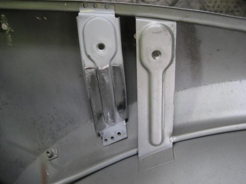

the whole front clip changed at 61
not to mention oval dash and windshield size was smaller.
probably a number of other changes to the body alone.
61 has a one year only hood support to fit the new trunk area but before springs were introduced in 62
the one attached to the car is a60 and earlier
the floating one is 61 only( with the holes in it)
61 has the bend as the wheel wells were moved down.
this is 61

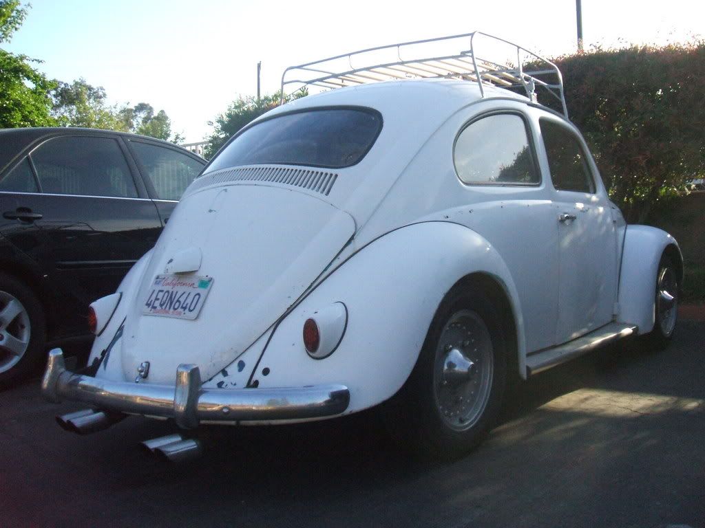

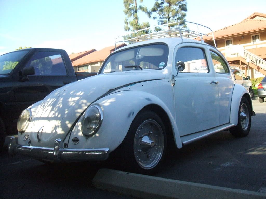

here is a pic of my ride requested by 67florida deluxe Very Happy its def. not for the purists but it gets me to point A to point B in some style. Its my first bug and i love it. Bought it just as you see it, havent had the time or money to put into it. but hope to after working long and hard this summer Laughing

Looks nice,needs a bit of work but nice all and all. Like the centerline rims.

thanks needs lots of work..but hey she runs and thats what i need right now.Oh and i know the pictures suck but i didnt want to move and lose my prime parking spot. Eventually i want to get some sweet artistic shots.
haha really? they fit the car nice but eventually there going to be gone.
