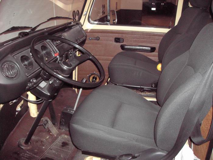

After scouring for reasonably priced vanagon seats in good shape with no luck, I picked these up off of craigslist for $100, from a 2005 dodge srt-4. They weren't exactly slide in, but only took an hour and a half to make them work. I didn't destroy the stock rails so original seats in the future are still an option.
This sort of thing may be an option for you if you can't find vanagon seats?
