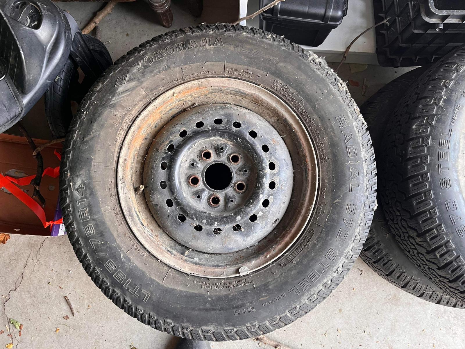

PostPosted: Fri Dec 29, 2023 9:44 pm    Post subject: Re: Tire date code info Reply with quote
Just trying to figure out what the date code is on these.
74 Thing
Joined: September 02, 2004
Posts: 7636
74 Thing is offline
PostPosted: Sat Dec 30, 2023 1:39 am    Post subject: Re: Tire date code info Reply with quote
Look for the 4 digit number near the rim somewhere around the tire. Stands for the week and year on manufacture.
Bruce
Joined: May 16, 2003
Posts: 17586
Location: Left coast, Canada
Bruce is offline
PostPosted: Sat Dec 30, 2023 4:01 am    Post subject: Re: Tire date code info Reply with quote
It's on the other side.
