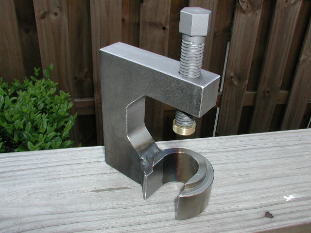

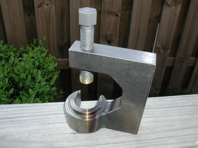

I got tired of having to pass up on bus steering wheels because I couldn't get them off. I had to leave too many behind for fear of damaging them so I finally got around to making my own. Did this at work yesterday and tried it out on mine tonight. Works great!

Sweet puller. I've never needed a puller of any kind to remove pre 1967 Bus steering wheels. I just use a big brass punch & a hammer. Sit in the drivers seat, put your knees under the steering wheel and push up. Place the brass punch against the top of the steering column and give it a good wack with a big hammer. The vibration will break loose the taper fit and off it comes. No damage to anything! Paint is perfect and the threads on the column are still good as new.

Just prchased the steering whel puller from Joey (great response by the way) and would also buy the hinge pin remover, specially if you can make it work with the mirrors and cargo doors.

I just used the steering wheel puller i bought from scvw here and it was very fast and very easy to use. I brought the puller to a local vw restoration shop and now he is going to order a puller and also the hinge pin remover. thanks for making such a good product.

nice ,
what's the diameter on the opening ? from the steering puller
