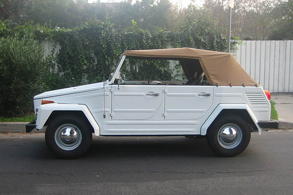

27x8.5R14 Bridgestone Dueler AT
Stock Thing rims, no lift. No rubbing.
You're in luck. Keep in mind that a spare that size won't fit in the boot.
