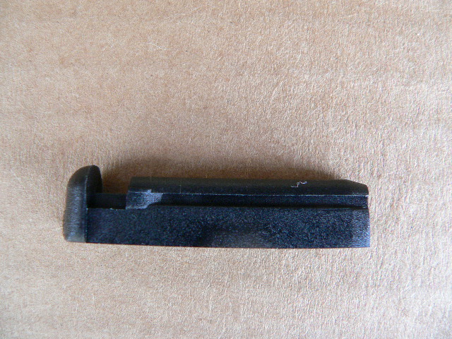

When your Vanagon was new it had two small plastic pieces that kept the window tight on the track.
Over time these break, or fall out making the slider loose.

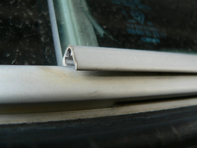

Does your slider windows look like this ? they are missing something.
This is the part, two go on the bottom track of each slider, I ordered mine from Bus Depot, they are relitively cheap, you may want to order an extra in case you "chew" one up to bad putting it in.
I used a pair of needle nose vice grips to compress it and slide it in, a shot of WD-40 helped also.
They put up a good fight going in. also make sure all the old one is out before trying to put a new one in.
All in and ready for another 25 years.

Greetings mightyart.............Wow, you must have ESP. Today Im at the local park putting a coat of wax on Madam Helga (shes been acting OK so I felt the need to reward her) and noticed the small popsicle stick I fashioned to keep the sliders quiet had just wasted away so I whittled a few more to take their place.
This afternoon I log onto the Samba for the third time today (NO!!!! I am not an addict, I swear!!!!!!!!! ) and lo and behold I come by your timely posting.
Do you have a part number for that critter or the heading under which you found the part?
Bus Depot is a favorite of mine and Im putting together a "buy it list" and would like to order a few of those as well.

http://www.busdepot.com/details.jsp?partnumber=281847723B
Buy one or two extra in case you bugger one up putting it in, they go in tight. Wink
It's a dealer part so it might take a couple of weeks to get it.

I second that. Just redid one of my windows, and they are a very tight fit. One went in pretty smoothly, the other gave me a bear of a time, but I managed not to break it. Having extras would be good because of that risk, and they're pretty cheap.

I believe the only ones available are for the later vanagon. They have a small lock/barb (like you can see in the picture) that mecanically hold them into position. The earlier vanagons did not have this barb and they had to be glued into place. My '84 Westy had the glue inplace kind and I could not find them anywhere. I got the newer kind with the barb and then used a dremel to cut a small notch inside the window chanell to accept the barb so it would stay in place. I had to take the window out to do this. Gettign the window out requires you to remove the rubber felt channel and the window latch. I then used carpenters clamps to slightly spred the window fram appart and the window comes out relatively easy.
