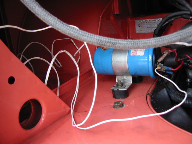

I run out of gas, then after walking a mile to fill up, it would not run
I guess the fuel pump failed somewhere along the way....
Good thing I travel with a backup electric pump and extra hose to hook it up (never thought I would get to use it....).
Tie wrap it to roof of engine bay
Hook it up to the coil (have extra wire taped to it ready to go)
I was not too far from an air cooled VW shop (how lucky of me).
So I drove back there to buy a new fuel pump.
I am still driving with the electric pump.....

Weird, I would think you would bypass the failed fuel pump but I guess the electric can suck the fuel right through the bad fuel pump?

Yes. the fuel pump is basically two arrows facing the same way with the diaphragm in between, albeit a new pump is quite the suck to draw through.
