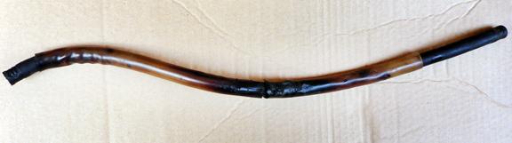

I was working on my son's 88 GL WBX 2.1 engine, fixing a broken connector on the power steering pump. Since the space is tight I moved the alternator a bit to the driver side to have more room for my hands... and I found this...
a closeup pic...
this is the fuel hose going from the T-connector to the #2 cylinder, behind and under the alternator. Last year on a trip the alternator died and was replaced by a shop 1K miles away from home. The bottom thin bolt on the alternator pinched and chaffed the fuel hose slowly and started a small fire... when? we don't know and not even smell the fuel leak... So I replaced the hose using one a bit longer and zip-tied it away from the alternator...
we guess that when they replaced the alternator they didn't move the hose far enough and let the thin bolt sit on the hose and the vibration did the rest.
so check that hose folks... and all other too...
all we can say that we were lucky... Very Happy
