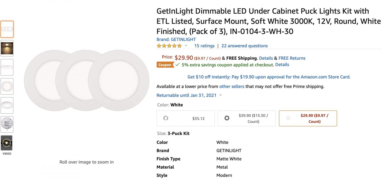

After lots of searching, I selected these lights for my install. They are designed for household cabinet use, as they come with a 110v > 12v wall plug adapter, which I simply set aside and had no need to use. I would be wiring the lights directly to the 12v battery. They are full LED, 12v and 4w per light, and came included with a dimmer switch. They had good reviews, and the price was right for $30. Pulled the trigger and got to work 3 days later once I had them in my procession.
https://www.amazon.com/dp/B07CZG2369/ref=twister_B07CZGVHQ2?_encoding=UTF8&psc=1

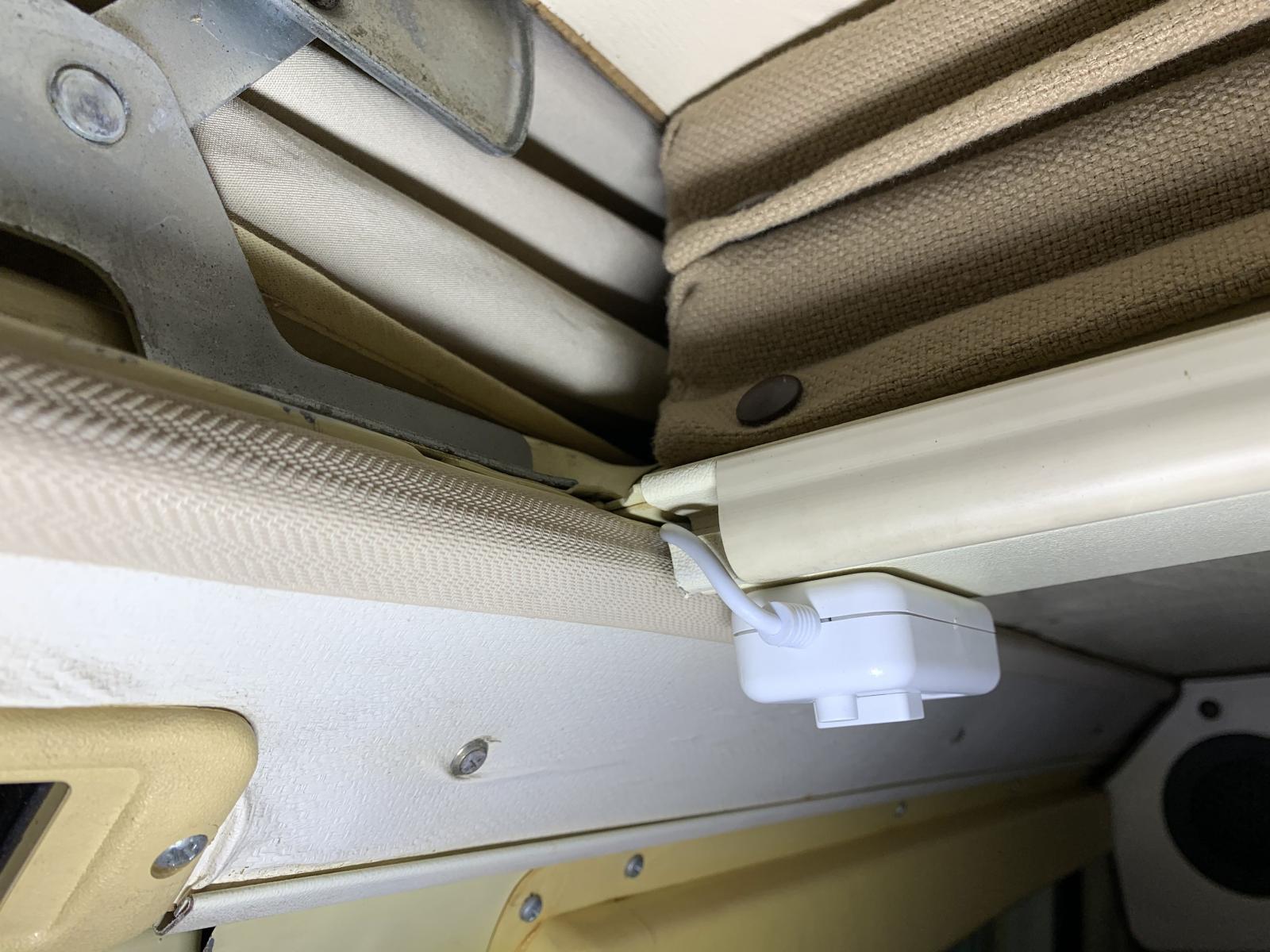

First order of business was to find a source of constant 12v power (terminal 30) so that the lights can be used regardless of key position. I chose to splice into the circuit for the kitchen galley light, which on my 82 is run off of fuse 8 up front. I ran my new wire back behind the cardboard trim above the spice rack, to the upper bunk support. I then removed the upper bunk support trim piece via the 4 Phillips head screws. I will be mounting my lights to this removable bar.

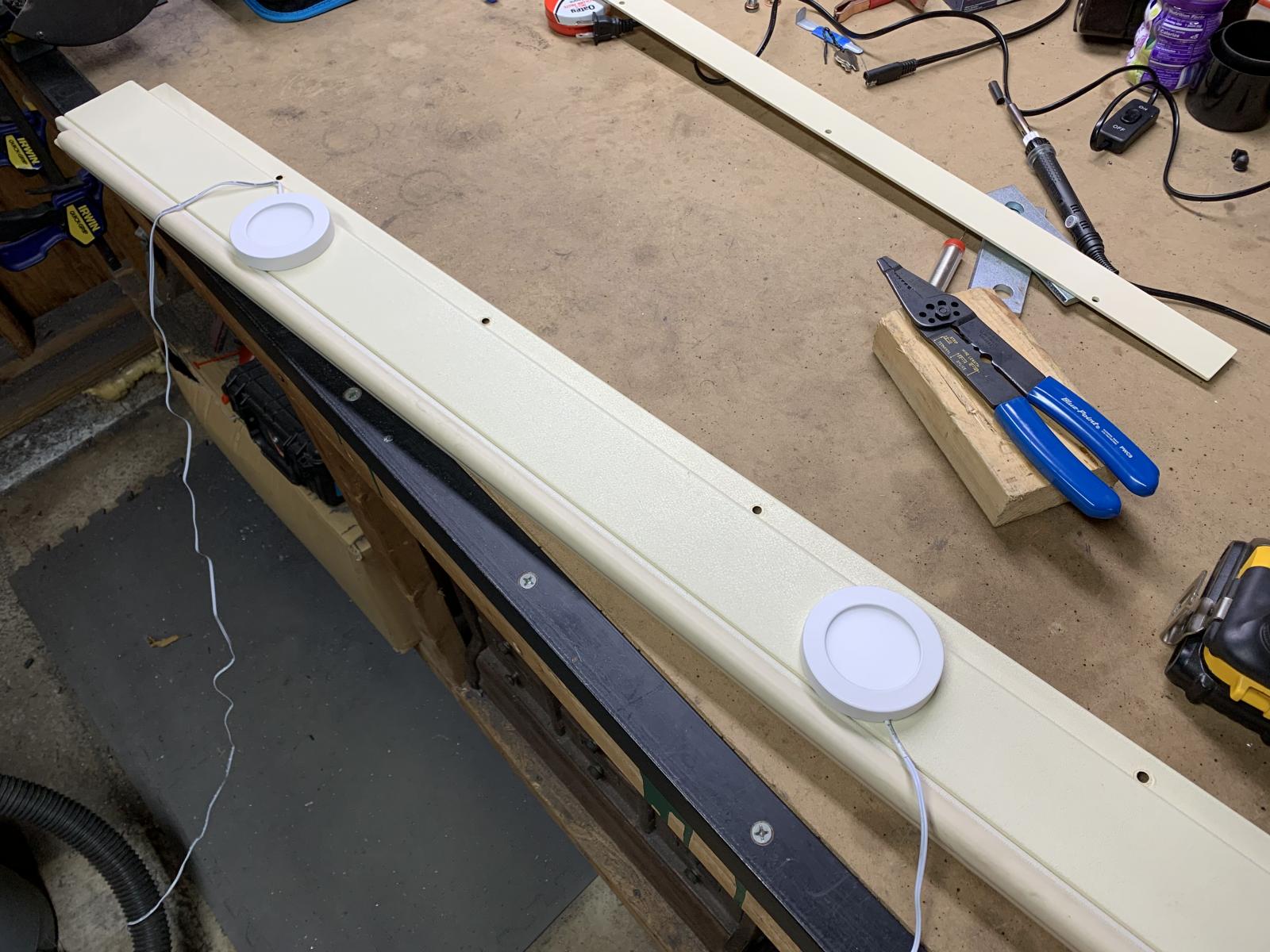

Next I position the two lights where I wanted to mount them. I marked the positions and drilled 2 small holes for the wiring to run through.
They lights came with steel base plates that you would normally screw to a wood cabinet. Then the lights (which are magnetic) would stick to them. I tried mounting the lights directly to the rail, since the rail is made of steel. Although they did 'stick', they did not feel secure enough to me. I could have taken apart the lights and added some stronger magnets, but I instead decided to simply use some 3M double sided tape to mount them.

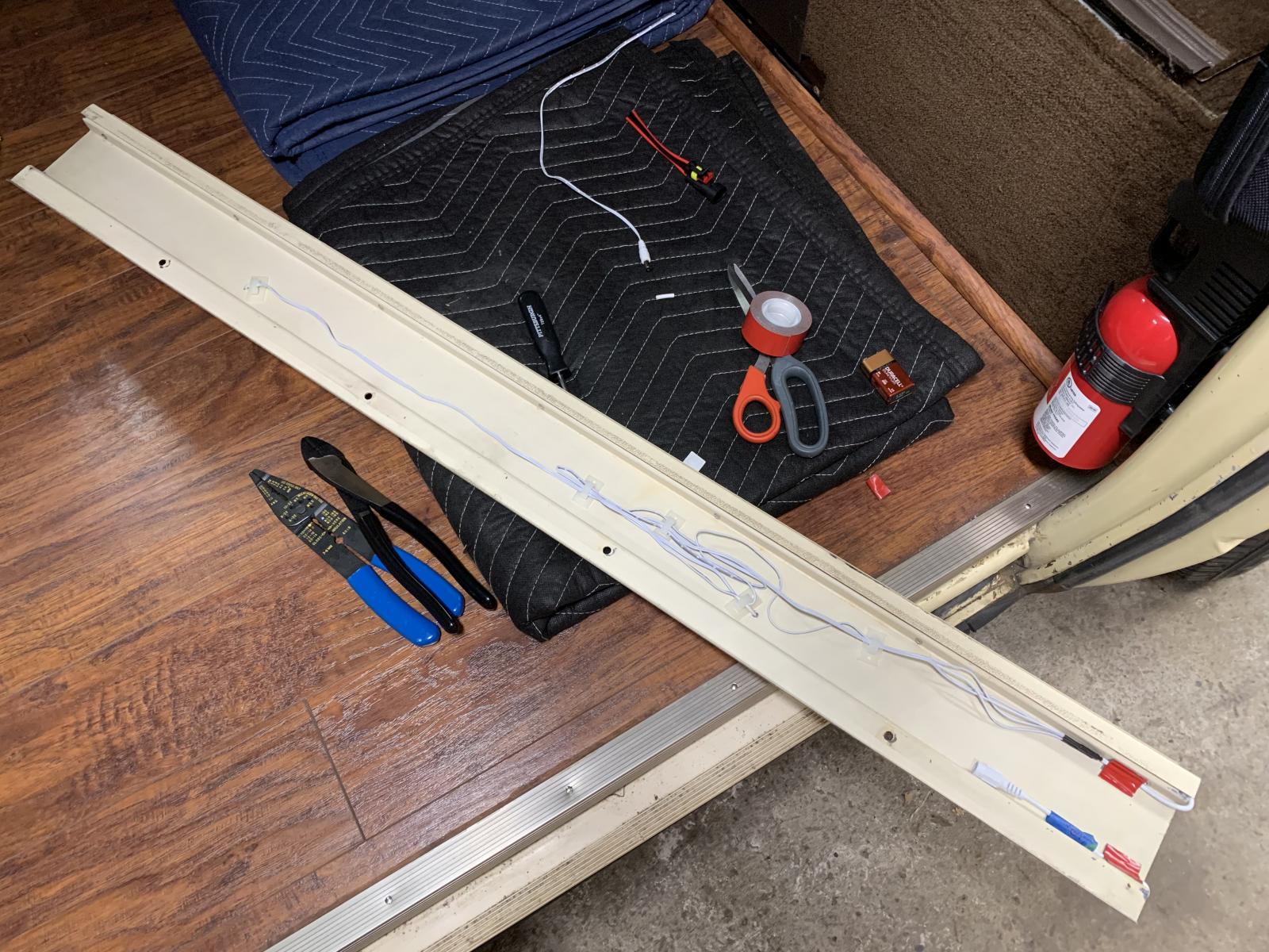

The three lights each came with their own quick disconnect plug end on them, which then plugged into a junction box so that the single power supply could control all of the lights. Since I am only using two lights, and also due to space constraints, I decided to cut off the quick connect ends and simply crimp connect the two lights together. This is what is looked like once the wiring was all finished up.

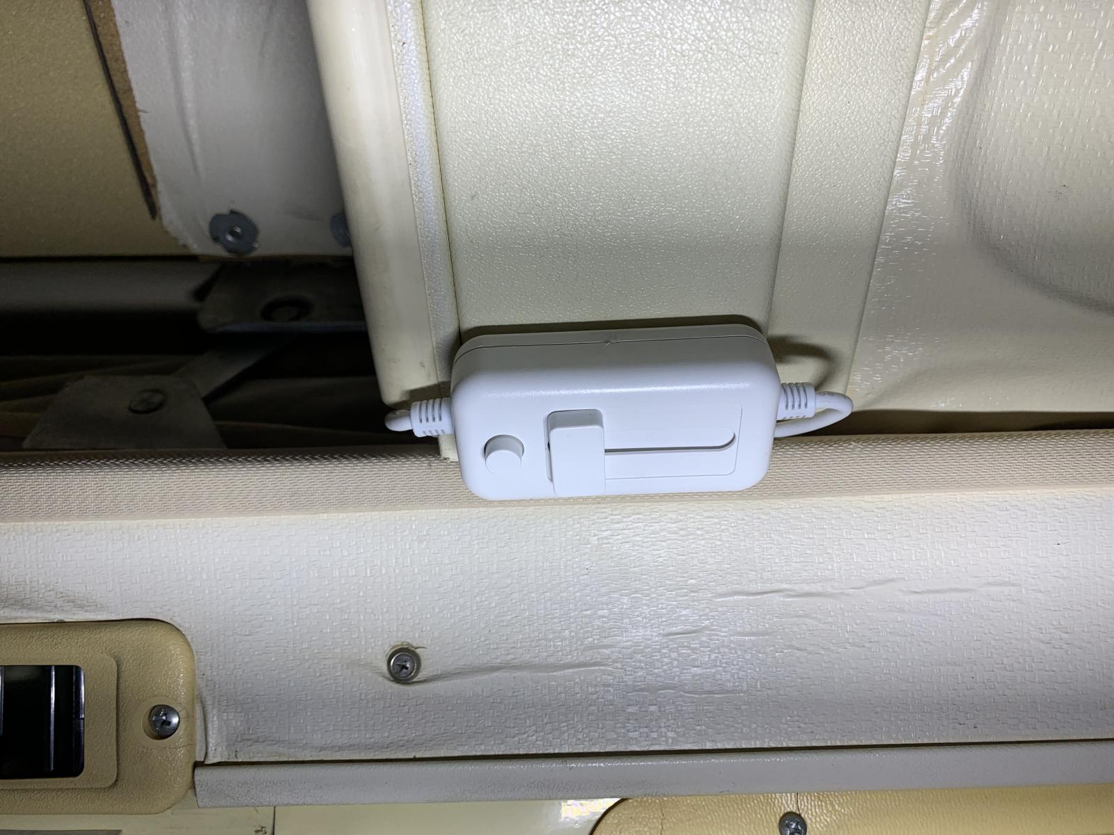

I decided the best location for the main power switch/dimmer assembly was on the far passenger side of the rail, mounted to the underside with some more 3M tape. In this way, it is easily accessible from the rear bench seat in either bench or bed layout. It is also easily reached from outside the van with the slider door fully open. In this way, you don't have to climb into the van to turn the lights on.

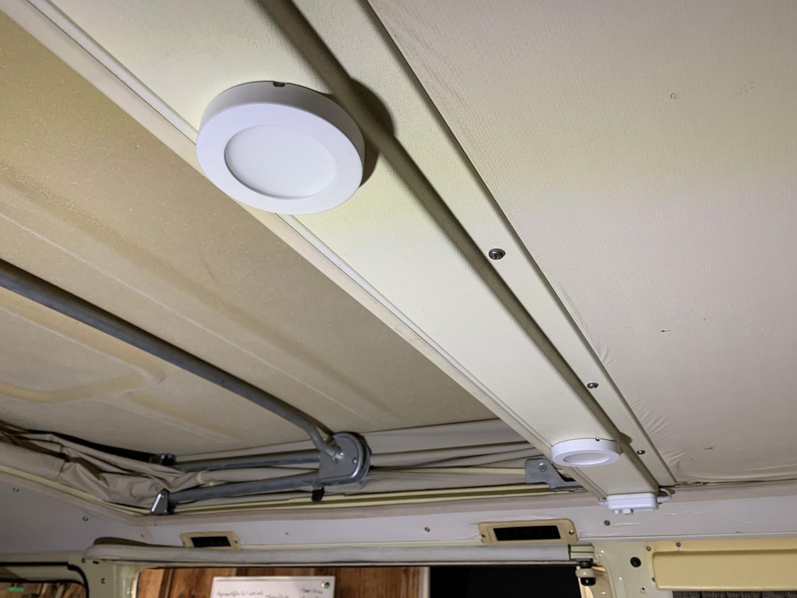

I used a few of the included sticky mounts to help organize the wiring on the underside of the trim piece. Then slid the bar back into place and reinstalled the 4 Phillips screws. And voila! Cheap and efficient lighting for the entire rear of your van!
Here is a photo with the lights at FULL POWER
And another photo at FULL DIM
At night, even the dimmest setting is more than enough to fill the whole van with a nice warm glow.
