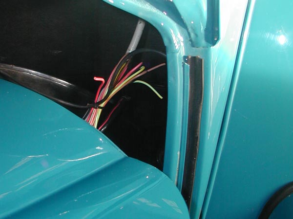

AlteWagen
Troll
Joined: February 23, 2007
Posts: 8702
Location: PNW
AlteWagen is offline
PostPosted: Mon Feb 22, 2010 3:01 pm    Post subject: Reply with quote
90volts wrote:
hows the water getting in?
In 1960 the decklid area on the body changed so any water that entered the vents would drain out the side of the decklid seal. You can see the detail in the top of the pic below.
1959 and earlier had a different louver section under the vents that captured the water and drained out of the engine compartment via two rubber hoses on each side.
You can see the tube behind the coil in this pic
and the drain above the screwdriver in this pic
Many times a bad license plate housing seal will let a lot of water inside of the decklid itself, and as mentioned earlier the vert water catches DIRECT water into the inside of the lid.
There is one HUGE drain hole in the bottom of the lid.
You can also see it a hole in this W decklid as well, a little different design but still a hole to drain water. Verts used the same inner support as sedans with drain pipes welded in.
