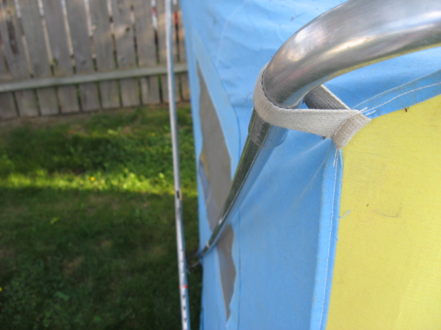

Here we go, sorry it took so long.
Here are the top gable sections. The angle is approximately 12 degrees. They were likely 20 inches long before they were bent.
Here are all the rest of the poles. Four of each.
Here are the dimensions of the poles. The ones with the 90 degree bend on one end are measured from the approximate inside apex of the bend. Not sure if that was the best way to measure them, but I had to start somewhere.
Bent poles.
Here is the rod that fits in the sleeve of the tent that fits in the bus gutter above the sliding door. It appears to be just 1/4" solid bar stock.
Here is the pole bag, just because.

A picture may be worth a thousand words but a pictures with measurements - priceless. I see there is going to be some challenges for me to make these.
Am I correct in assuming that the 90's slide over the center apex piece and then are adjusted outwards? And that the apex not only bends upward but slightly forward as well? It seems all of these lock into certain positions so that the apex is pointing at the right angle. Please let me know if you can.

This side got slightly bent in a wind storm.
Here is a sampling of the pics I took of the tent in my backyard. There are many more in my gallery.
