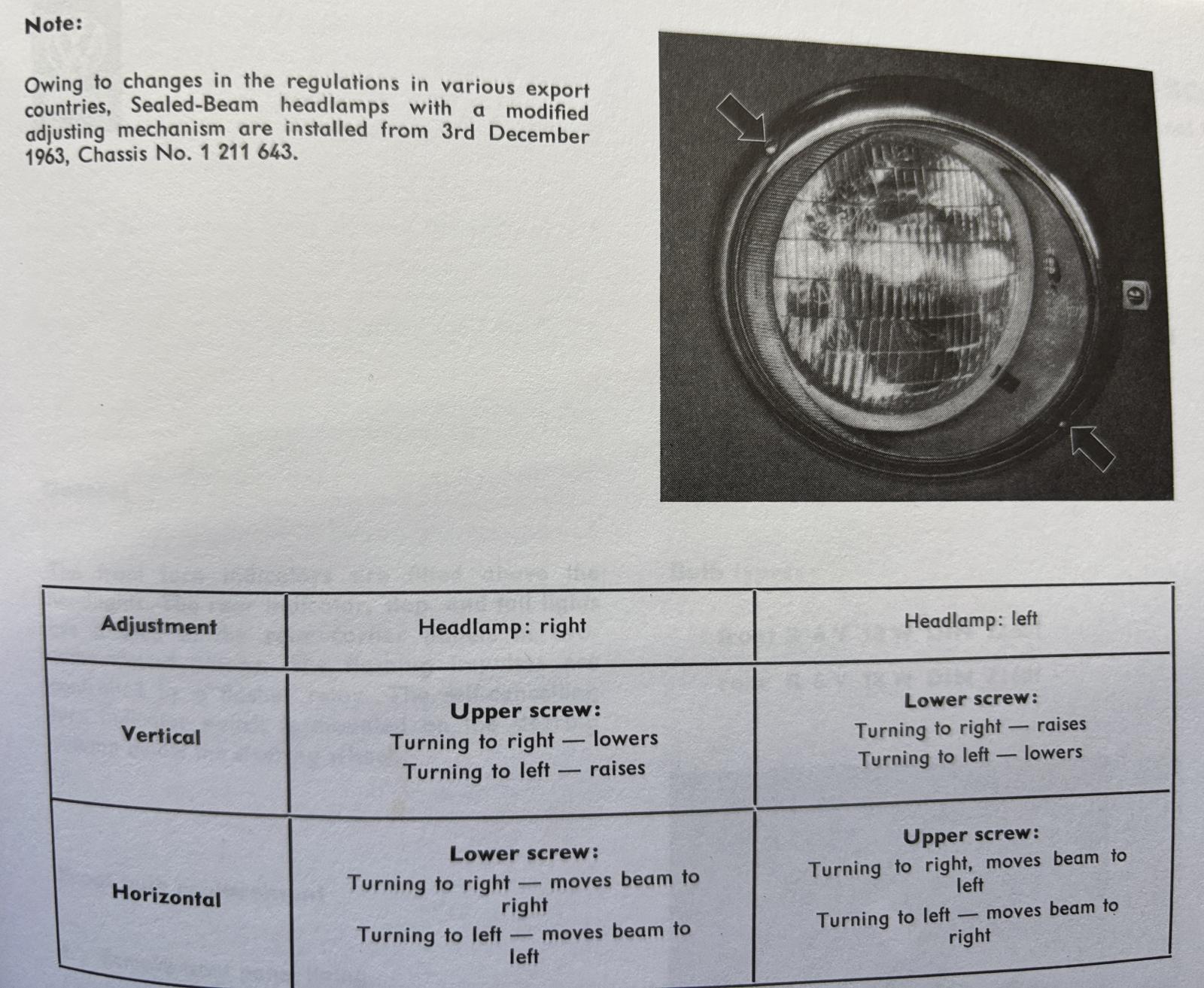

Adjusters are normally on the same side of the bulb near the mounting screw except buses sent to some countries where they were on opposite sides of the bulb
For search
Owing to changes in the regulations in various export countries, Sealed-Beam headlamps with a modified adjusting mechanism are installed from
3rd December 1963
Chassis No. 1 211 643.
