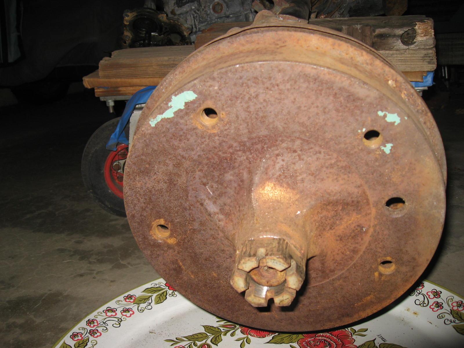

Am using this thread as I need help.
This transaxle is gungy inside from sitting outside since the 70's. I'm trying to free it up so it will rotate. I already have the drums free. In these two photos is it in first gear? Are the bottom two shift selectors in neutral?

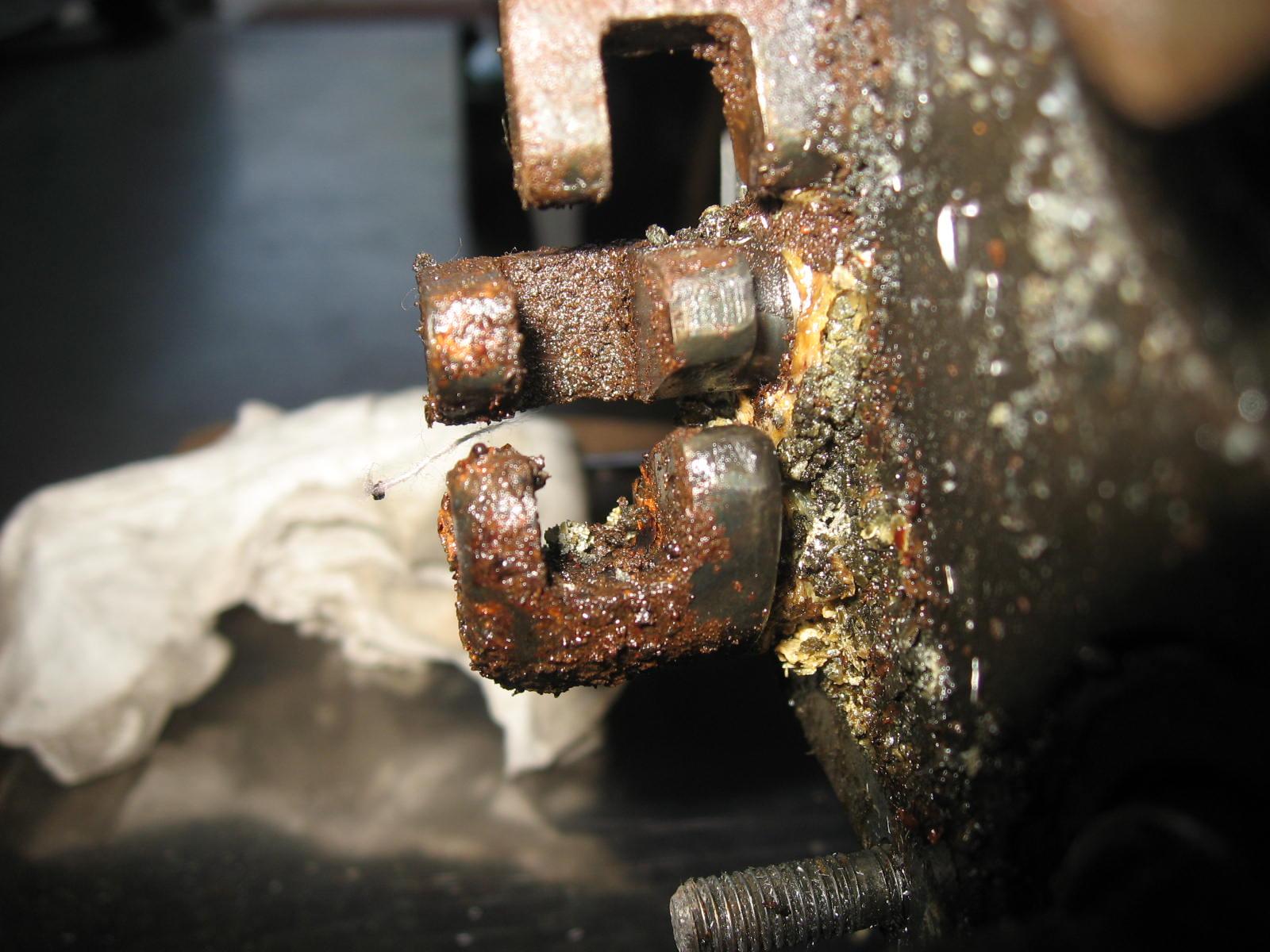

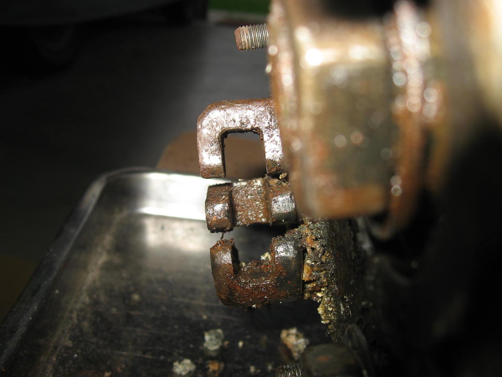

In these two photos I held the face of the hockey stick housing photo square to its opposite side . Is the hockey stick bent?

Just a "lil bit", Barry! Somebody was really trying to get into reverse, 2nd or 4th. Damn!
The faces of the spade end of the hockey stick SHOULD be parallel to the plane of the face the selector rods are in. Again, DAMN!

My first time into this territory. I've seen this stuff while the shop did it but never myself.
I can't get the top shift selector to pull forward and line up with the bottom two. Before I assume it is so rusted up I need to dig further, I was wondering if maybe the bottom two somehow got selected at the same time which would jam it from rotating.
I cant get the input to spin nor either exposed shafts by the shift selectors nor will either drum turn and all the brake parts are off. The drums rock back and forth as the RGB gears are free so I assume the main axles aren't moving at all.
Spinning one drum doesn't make the opposite spin backwards nor make the input shaft spin (I have a disc on the input to grip onto).

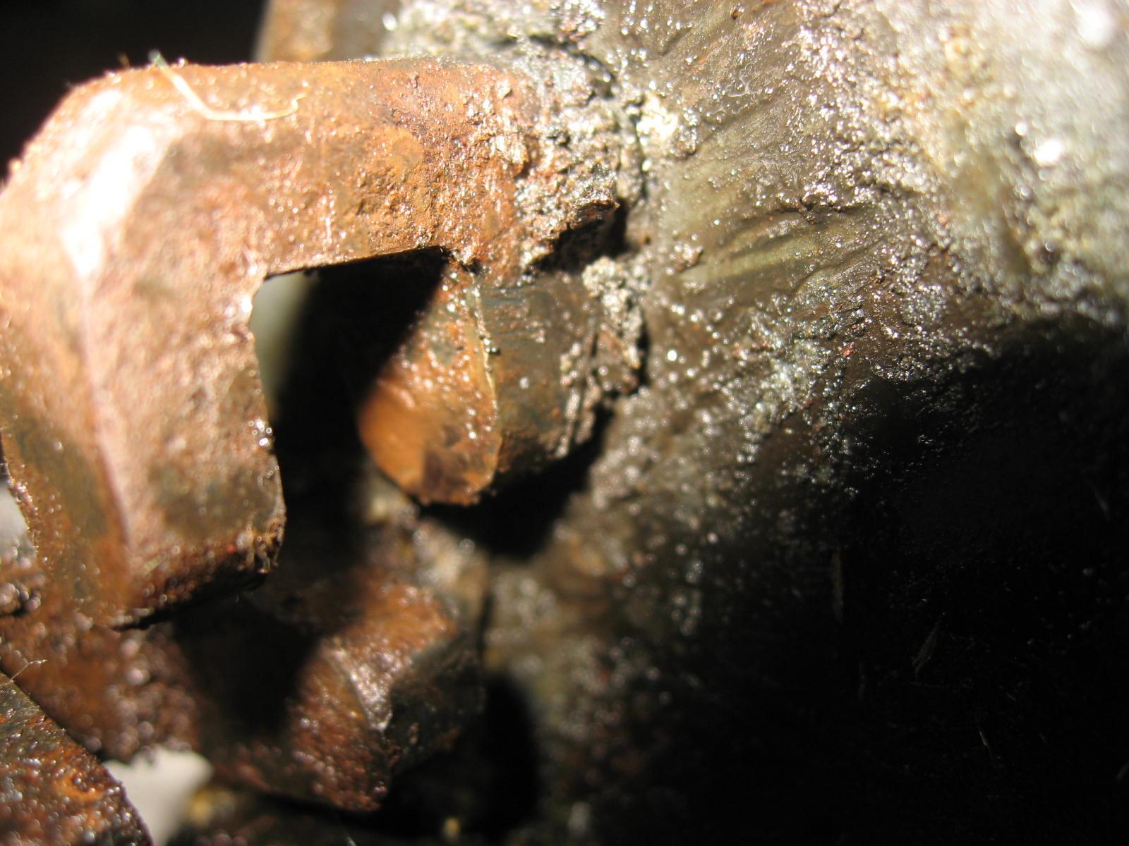

Now I'm completely baffled. If I put a socket on either of these shaft nuts I can rock them as if they are free but they don't turn.
Simultaneously this wiggles but won't turn free.
If I rock either of these I get the same results: they wiggle but don't turn.
But this wiggles again.
I can't get this to slide forward no matter what. It will go in a hair and back out a hair but that's it.
Can anyone tell if the bottom two selector shafts are in neutral?
I'm thinking that I must somehow be in two gears at the same time somehow. The bottom two selector shafts are rock solid and won't budge.

Thanks. That confirms my guess. I'll clean more of the gunge away and try to get the top one forward into neutral, at least.

In minuscule increments I was able to get the shift selector to appear to be in neutral.
Then using a socket and breaker bar on the exposed gear shaft nuts the tranny started to become free. Now it spins easy and the differential appears to be free. Turning a drum, clutch disc, or either gear shaft, everything turns together. It still is stuck in gear.
I can't believe that with steel shift forks, as these bus transaxles are equipped with from the factory, that I could have possible bent one that far to allow the shift selector to appear in neutral. I'm going to try to put a socket on both gear shafts simultaneously and see if I can get them to spin independently.
At least now it's a roller.
