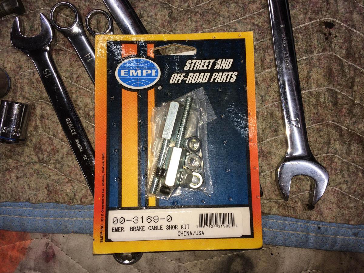

I cobbled together so BS for a buddy in the 90's for this problem.
ach60 wrote:
bobrk wrote:
Oofff,
Remembering the hack job we did to adapt late too-long e-brake cables to an early bus. LOL
My head hurts from those pictures, another ghost from the past comes back to haunt me!
And all I had to do was order this, VW Cable Shortening Kit, Parking Brake
Qty: 1 Code: 3169
https://www.jbugs.com/category/vw-dune-buggy-off-road-emergency-brake-cables.html
Funny what you can learn from a Dune Buggy.
But you can learn from Kurt "glideking" the master of Funky Truck, please see below:
ach60 wrote:
Who.Me? wrote:
Qty: 1 Code: 3169
I tried that kit, but the first time I yanked up on the handbrake to test it, it just ripped out. Tried tightening the grub screw even more, but it just stripped the hex head.
There are a few threads in the FAQs on more reliable ways to make the cables work. I think Glideking's solution in his Funky Truck thread is the most elegant though.
glideking wrote:
Usual problem of having non stock length hand brake cable when using "big nut" rear brake drums with early bus.
For years I used these off road cable ends and cut down the long '67 length cables. I used Loctite and they have never slipped.
Problem is there is very little room for adjustment as the cable stretches and brake lining wears. The hex section is too large to fit into the compensating lever and can't go through the tubes to remove the transaxle or RGBs. Once the cables have stretched they must be replaced. Later split buses have much more room for things like coupling nuts and treaded rod. No such room in the early bus. These are one time only use because they smash the cable.
Always looking for a better way. Turns out I had the solution all this time. I make my own aircraft control cables. This tool is $19 bucks from Aircraft Spruce.
3/32 tin plated copper swages are a perfect fit and stronger than the factory ends.
Here is the total length I used for a '67 brake backing plates with a stock '59 rearward positioned hand brake lever. Even with shrink tubing they fit easily through the chassis tubes.
It is beginning to look like 1959 under here. Now there is plenty of room for adjustment and the cables can be easily removed and installed.
Kurt
Good Luck
Al
