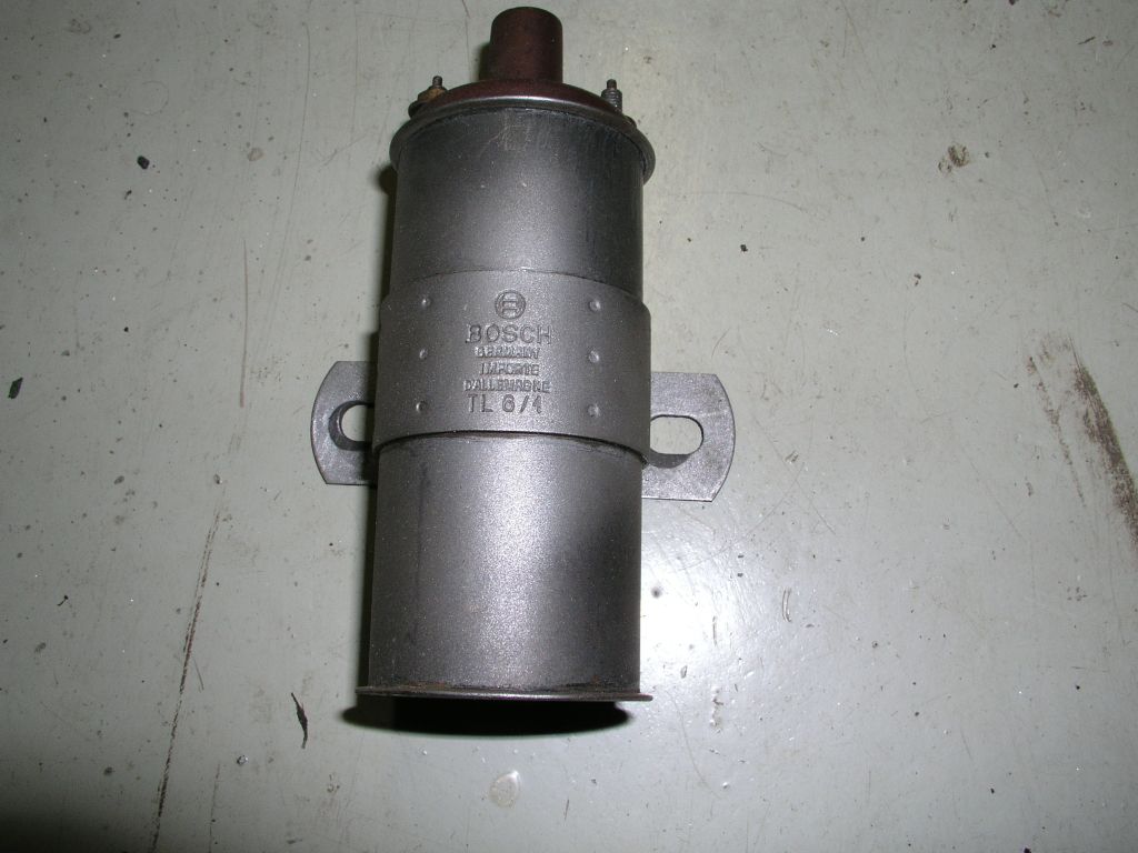

splitpartsunlimited
Joined: January 18, 2006
Posts: 1321
Location: Good Ol`Buenos Aires, Argentina
splitpartsunlimited is offline
PostPosted: Fri Oct 19, 2007 8:30 am    Post subject: Reply with quote
one is thin, the other is fat , these are the differences ....
btw the thin one is not "te" it is "tl" , correct me if i am wrong

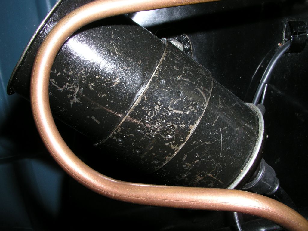

PostPosted: Fri Oct 19, 2007 8:42 am    Post subject: Reply with quote
Right!! the one I have here is Stamped TL 6/4 , but I remember saw TE in other car vws??

splitpartsunlimited
Posts: 1321
PostPosted: Fri Oct 19, 2007 9:19 am    Post subject: Reply with quote
NO , I MEAN THE DIAMETER OF THE COIL BY ITSELF ....IT IS ABOUT 52MM FOR THE THIN , BUT I DON`T HAVE A FAT ONE TO MEASURE ...

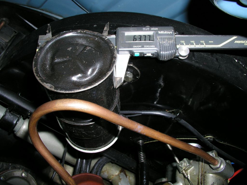

virtanen
Joined: January 08, 2006
Posts: 1495
Location: Finland
virtanen is offline
PostPosted: Fri Oct 19, 2007 10:05 am    Post subject: Reply with quote
My thin TL 6/1 dia is ca. 52.2 mm
My fat TK6/3 dia is ca. 63.8 mm

PostPosted: Sun Oct 21, 2007 11:39 am    Post subject: Reply with quote
My skinny one is marked "TL 6/1"
