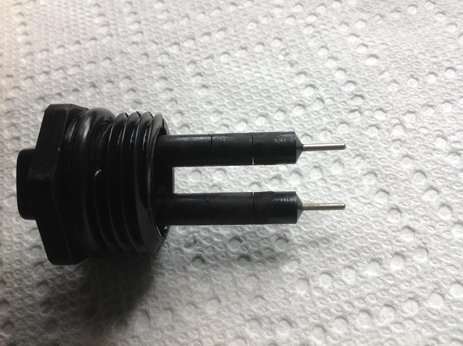

He is how my sensor failed. Original 1986 unit (date molded in).
Coolant seeped up the metal rods via the cracked plastic and oozed out from the top plug.

PostPosted: Mon Sep 16, 2013 11:51 am    Post subject: cracked coolant level sensor in Ecuador Reply with quote
1988 1.9cc Kombi Carthago
I have been checking my coolant level regularly after a recent rebuild, mostly because of very small drips from several coolant hose connections. One by one I have been tightening hose clamps and sealing up the leaks.
Then after spending a few days hiking in the Jungle I came back and warmed up the van and noticed coolant dripping out of the back left. Opening up the engine compartment is see it is coming from the coolant level sensor in the expansion tank. Looks like the kind of thing to tighten slightly and I will be good to go. NOPE, tightening made it worse.
I pull it out and yes it was dirty (as per the photos posted here), but I have never seen the red light go on and the van usually runs cool. Hottest temps are just above half way on the gauge. I noticed someone had put a bit of teflon under the O-ring on the sensor, so I thought to add a bit more and put it back. That didn't work.
Then I pull it out and clean off the new and old teflon and see that there is a large crack almost all the way around under where the O-ring goes. In Ecuador there are hardly parts available for a Vanagon, let alone in the Jungle. At a small hardware store I look for a 3/4 inch plastic plug, but the threading is different.
Then out of desperation I get superglue and bicarbonate which hardens the plastic even harder. Gooping it on in 2 different layers the sensor plastic is repaired, but when screwing it in the expansion tank, the top of it is not level (uneven) and the O-ring won't quite seal. So I remove it again and add a layer of hi-temp silicone and let it dry overnight.
Next day it doesn't leak until the van gets up to temperature. SHIT. I have got to try to make the run 3.5 hours up to Cuenca (the closest city) and look for parts. This climb will take me over a 12,000 foot pass. So with lots of extra water on hand I go. Actually the van hardly leaks coolant once it is running at over 2000 rpm's and doesn't heat up and the trip to Cuenca is fairly easy even on a rocky dirt road.
Going back and forth to all the auto parts stores in Cuenca there is nothing that resembles this sensor nor a similar plug. I almost put in an expansion tank from a Chevy, but instead I have a machine shop fabricate a plastic stopper. I figure I have never even seen the red light flicker on the gauge, so I'll get a new sensor sent to me sometime this month.
It is now running great. But the next day my temperature gauge starts showing hotter temps than I have ever seen, about 3/4 of the way up. I have a manual override on the fan and even running down hill with the fan on doesn't bring the temperature down on the gauge. I stop and try to add coolant and bleed it out, but there isn't any air in the system. It doesn't seem to be actually running hot. The return tube from the radiator is cold!
I suspect the thermostat is not opening because turning on the heat in the van seems to bring the temp down on the gauge. I was going to remove the thermostat today when I thought I would check online first. I can't get a hold of a IR (infrared) gun in Ecuador to check actual temperatures. I was going to ask on the forum how bad it would be to drive around without a thermostat? at least temporarily.
In the end jumping the connection of the coolant level sensor (I had just left it disconnected) made the gauge work perfectly again. Just drove up a pass and temperature comes up to about half way with no fan on, then I feel the return from the radiator and it is warm, but not hot. Very Happy
Sorry for the long winded story, but thanks for the info on the forum: http://www.thesamba.com/vw/forum/viewtopic.php?t=184096
