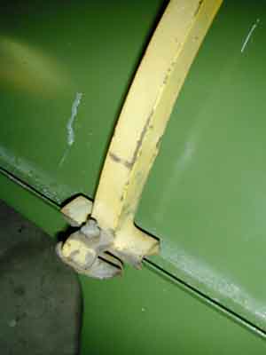

Clamp Summary from this post
The different westy rack clamps used from 59 through the 70's. From Left to Right.
1. 59 - mid/late 61
2. late 61- mid 62
3. mid 62 - 67
4. 68 - ?

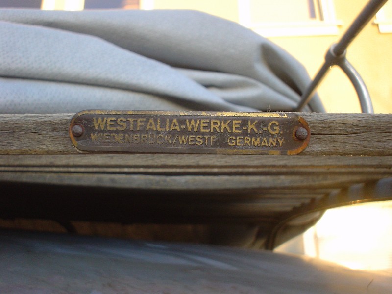

Rack tags:
Early '62 tag:
Tag location, when dual tags were used:
Other photos
Repro tags:
Rack clamp hardware (from a '61-62 clamp):

I think there are some differences in the brackets, look in the gallery.
also early (but I don't know how early) rack has slope to the rear of the bus like the end of the roof...

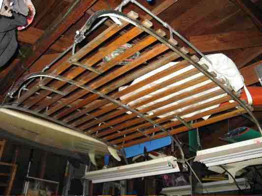

There are many differences between the yrs, most are very minor though. Measure the lengths of your slats. These are original measurements, so if your wood is original and 52.5 inches long, you probably have an early 62 only rack which does sit lower and level. If the wood measures 45.5 you have a bay window westy rack. Look the same as a 65-67 rack but sits much lower and the clamps are HUGE Shocked . Bigger than the 65-67 clamp. Hope this helps. Post some pics, would love to see it.
This is an early 62 rack.
This is a bay rack.

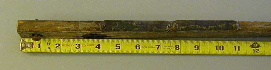

I didn't even know the bays used a wood slat rack. Shocked The clamp measures 2 7/16" at the bottom and the foot of the rack is a little over 2". Is that huge? I don't know why I didn't notice earlier but my rack has a LOT of bow in it and sits pretty high. Bay window?? Here is a the best photo I could find. Slat length was about 52". If it sat closer to the roof line, I would have no problem with the tent pole.
zundapp
Joined: August 16, 2004
Posts: 514
Location: Never far from Fahrvergnügen
zundapp is offline
PostPosted: Tue Dec 04, 2007 10:06 am    Post subject: Reply with quote
Sorry, forgot the photo.

I must have missunderstood your question initially. If the rack in question is the one on your bus pictured. It's a 65-67 so-42 rack. Your clamps are not the big ones I was talking about. Not sure about the problem you having though.... Technically it should work fine...

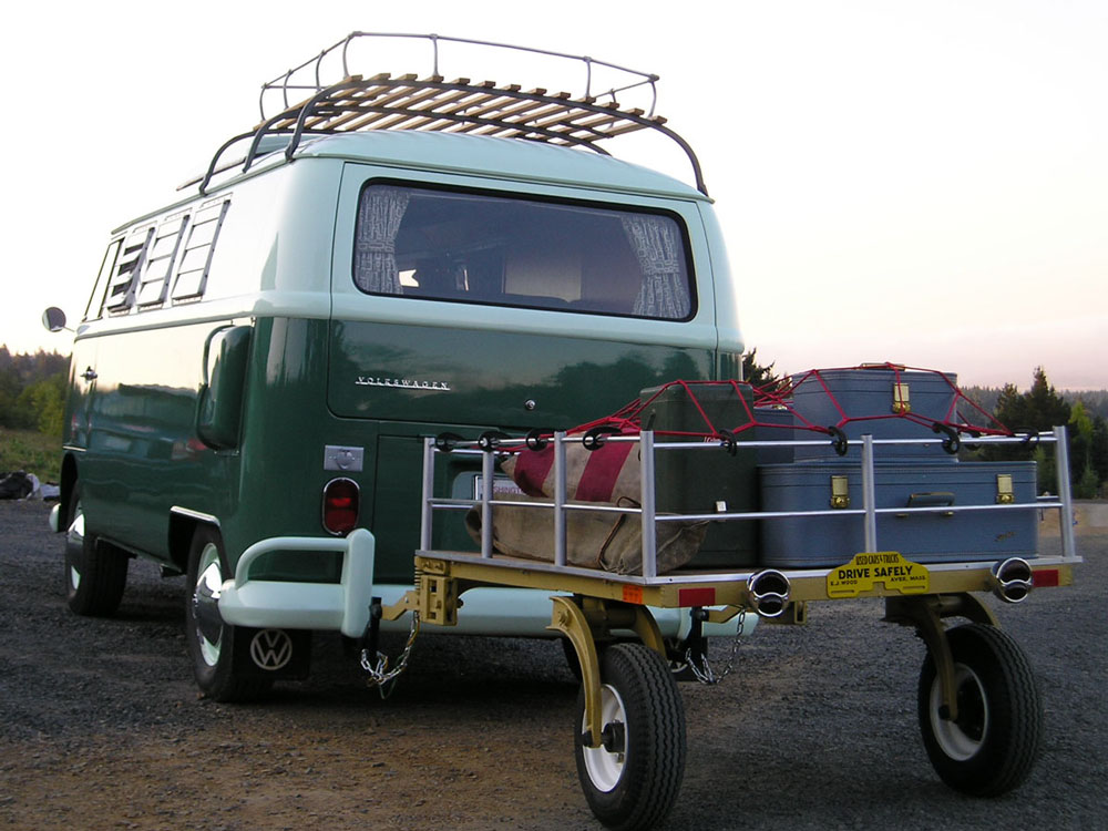

That 62 has the early 62 only rack. Those seem to have been a short run rack. All three legs on the early 62 rack are rear legs of the sloper 59-61 racks. Most likely left over parts. That rack is definitely lower than the later 62-67 racks.
The one I measured is a 65-67 rack. I believe it came off of a 67 but not a 100% sure.
Here is a late 62-65 rack. This one is the same height as my 65-67. Both tents work great on this bus.
Do you tent poles look modified??
Some bus / rack w/ larger tent.

Is the green-white bus the one with the problem? That looks like an original rack `65-`67 and there should be no issues with that.
