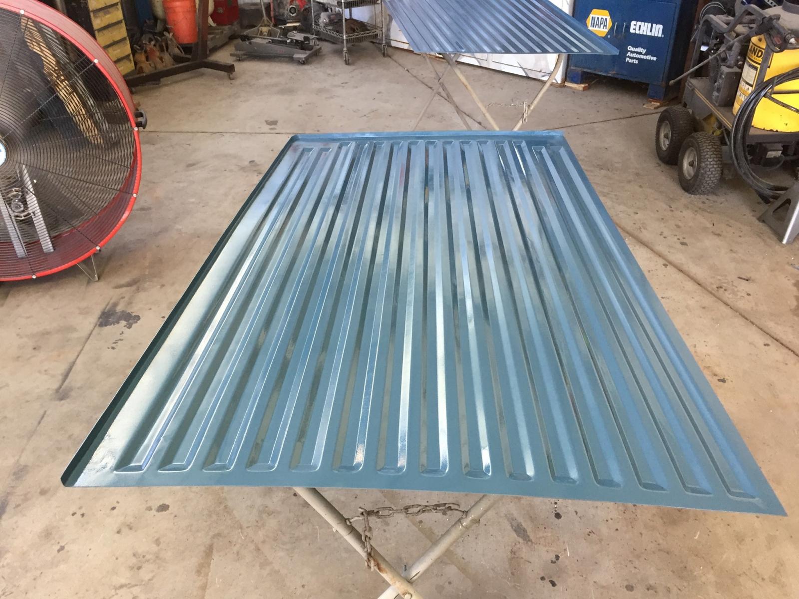

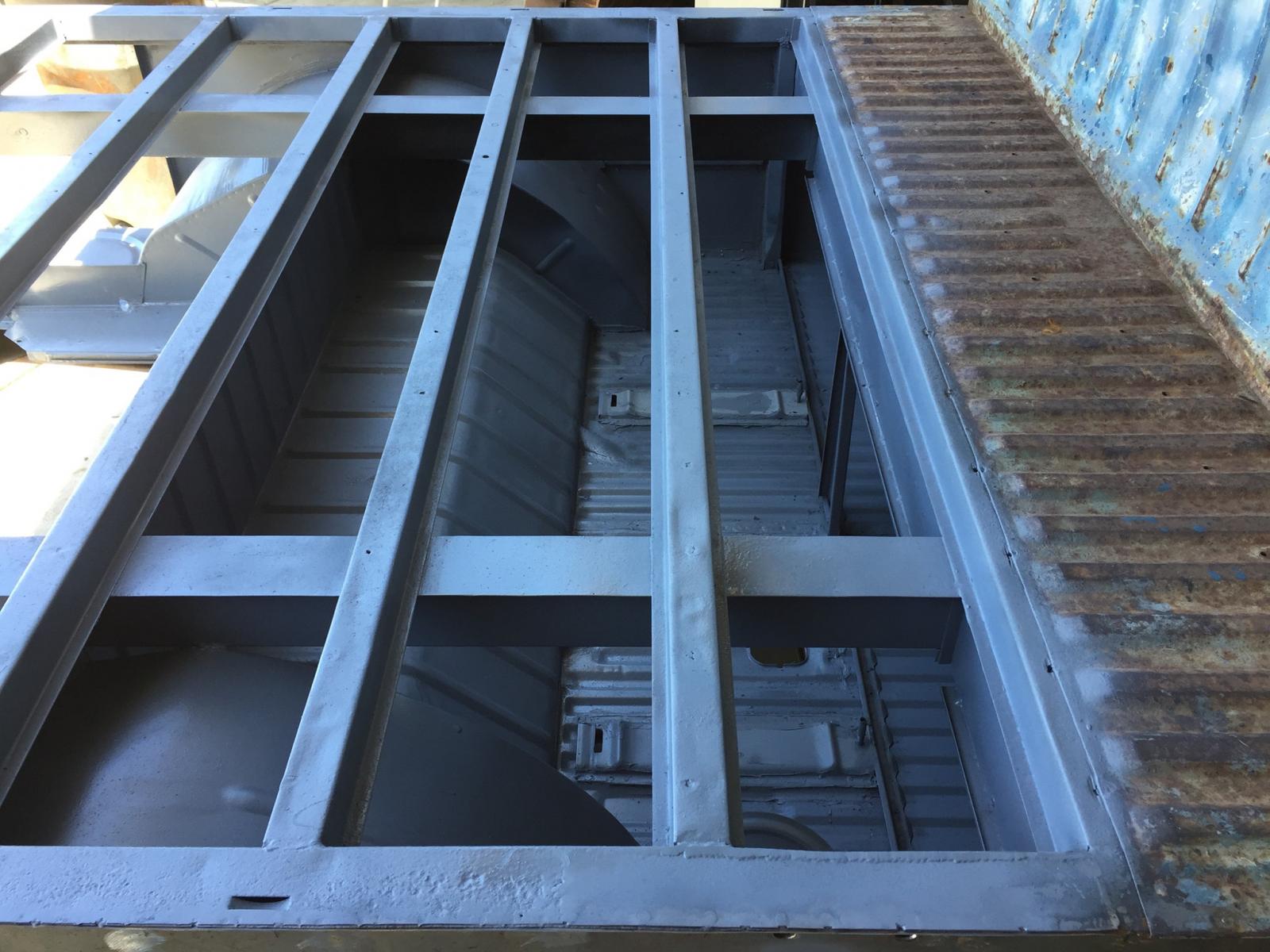

Spent six hours at Josh's shop prepping the bed area for paint. First I used some Ospho with a scuff pad on some surface rust, then grease and wax cleaner with a pad to scuff the old POR 15 that was laid down a few years ago and was a bit weathered. I then sealed it, and sprayed single stage Urethane with a touch up gun cause I couldn't get my regular gun in all those confined spaces, so it took forever having to refill the damn gun.
Anyway, did two thick coats in the engine compartment, pretty much one thick everywhere else which n top of the POR and the sealer should keep the rust at bay.
The bed floors are painted on the down side, of course. And the inside of the corners will likely need some touch up after he welds them on. Which is the next step after I get him a new apron and decklid as the old ones are too roached to make it worth fixing them. Since the bus has so little OG sheet metal it's like why not?
In many ways this is going to be nicer than stock because they did a shitty job in that area I painted, they didn't even bother shooting primer on the underside of the bed. I usually don't do over restored but it would be lazy and stupid to not spray it with it exposed like that. Plus it willlook SANO when done. I might have to rig some LEDs in there.

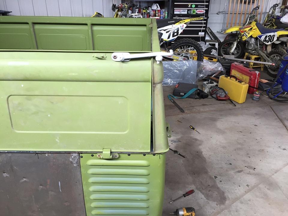

Fitting up the gates and ran into this problem.
Huge wedge shaped gap tween the side and rear gates.
Any ideas on how to fix this?

PostPosted: Sat Aug 17, 2019 8:31 pm    Post subject: Re: 1960 Double Cab project restoring a beater Reply with quote
Double check that the side gates are square.
Then check that the back of the cab is square to the bed.

PostPosted: Sun Aug 18, 2019 4:55 am    Post subject: Re: 1960 Double Cab project restoring a beater Reply with quote
Looks like the side gates should be adjusted back (if possible) and the rear gate hinges may need massaged.

PostPosted: Sun Aug 18, 2019 7:08 am    Post subject: Re: 1960 Double Cab project restoring a beater Reply with quote
We tried moving the side gates back but that opens up a nasty gap then on the forward edge.
I looked at several pix in the gallery and it appears that the gates should fit with a minimal gap.
Will check with a square tomorrow.

PostPosted: Sun Aug 18, 2019 9:48 am    Post subject: Re: 1960 Double Cab project restoring a beater Reply with quote
Does it have the same exact condition on the passenger side too? If so, since that thing had been whacked before, maybe the whole thing is bowed down!?! Confused

PostPosted: Sun Aug 18, 2019 10:45 am    Post subject: Re: 1960 Double Cab project restoring a beater Reply with quote
Yeah, same deal on the other side.
We considered that but if it were bowed down then wouldn't it make the gates tighter? It would have had to buckle up t force them apart. There is not noticeable bending in any of the structure. Not sure if he's put a straight edge on it, so that's another thing to do tomorrow.
The truck did take a sharp hit to the right side which wiped out the B pillar and later one to the front right which bent in the A. The rear sides had some sheet metal dents but nothing structural and the rear was never hit.

PostPosted: Mon Aug 19, 2019 1:50 pm    Post subject: Re: 1960 Double Cab project restoring a beater Reply with quote
Are the hinges not welded in far enough?
Are the gaps correct if you unbolt the hinges from the rear gate?
Is it still tight at the gate latch?
