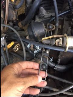

Spent some time this evening hosing down engine compartment as it seemed to have 20+ years of dirt/dust everywhere. I've been hunting down some leaks as well as few niggly items and have a few newbie questions so go easy on me.
After pouring over the Haynes and Bentley manuals and various online engine pics it worries me to see this hose duct taped off. What the heck is it?
Also, any idea what this gizmo is on top of my engine?
Lastly I think I've got a bad temp sensor for the gauge as my temp gauge barely moves on the dash and after reading through tons of threads it seems like a likely culprit. However for the life of me I can't locate it. I consistently see pics of the below blue sensor:
Is the gauge sensor lurking here in the shadows pointing directly towards the front of the van? If so, how the heck do you get to it?
I did manage to check my air filter, get it seated back into place as it was loose at the base, and shore up the hose so at least I feel like I accomplished something tonight.
Thanks in advance.
BAD PHOTO BUT I AM GUESSING A/C LINE???
CRUISE CONTROL LINKAGE
IT IS ON THE OTHER SIDE OF THAT THERMOSTAT HOUSING, GAUGE SENDER AND TEMP II SENSOR BOTH.
FROM UNDERNEATH
Thanks in advance.

Your second pic shows parts of the cruiser control setup.
If your temperature gauge isn't moving much I would suspect that your thermostat might be bad, get hold of an IR gun and check to see how hot your engine block is.
Both the TSII sensor for the FI and the sensor for your temperature gauge are mounted into the bottom part of the thermostat housing.

PostPosted: Thu Jul 07, 2016 7:00 pm    Post subject: Re: What are these in my engine and where is the temp sensor? Reply with quote
Wildthings wrote:
Your second pic should parts of the cruiser control setup.
My cc isn't working. How is this piece related to the cc setup? Every search I do on cc for the Westy shows the stalk and all the cables on the front end of the van with discussions about troubleshooting but none of them show this piece. I can't see how this piece is attempting to do anything. Not saying this is why it's not working just trying to piece together the puzzle.

Given your options, the engine in your van should look something like this if everything were functioning
The cruise control actuator is the business end of the works that keeps the throttle holding speed to whatever you set on the stalk.

PostPosted: Thu Jul 07, 2016 7:13 pm    Post subject: Re: What are these in my engine and where is the temp sensor? Reply with quote
Zeitgeist, sweet thanks!
Well compared to yours my cc part isn't attached to the throttle. Wonder why? I'll see what happens if I hook it up.
