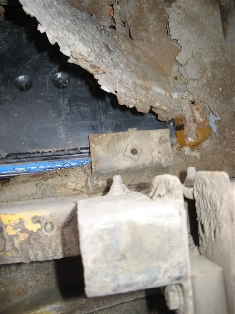

3.) The battery tray is rather rusted. Is there a remedy for this? A Fitting that can be popped in there? It still has enough to hold the battery, but I don't want it to fall out while I am driving down the highway.

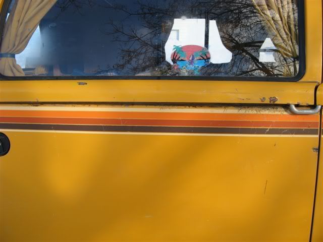

4.) The sliding door falls off if you are not careful with opening it. This was not pleasant to discover on my own. I opened it before buying it, the seller opened it before buying it, and it seemed fine. Not sure how to fix this. It falls off, but you can just pop it back in. I want it to be to the point where I don't have to pop it back in because it doesn't fall off.

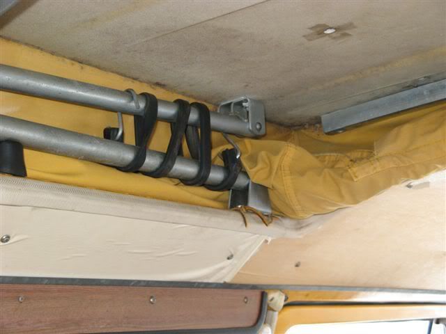

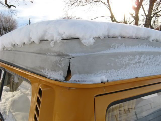

5.) There is a crack in the fiberglass of the pop top. it is located on the back driver's side corner. As a result, the top doesn't sit right and I have the inside bungee corded around the brackets to make it sit flush. Other wise it sits crooked and air flows in from the top while driving blowing the canvas around. Where do I begin with fixing that? I don't think it is feasable to replace the whole thing. Any thoughts? Prices from past experiences?

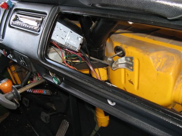

6.) I have no glove box. I have the face, but no actual box. Actually there is nothing under there. Just the face of the dashboard. The fuse box hangs down. I need to mount that back up in there.

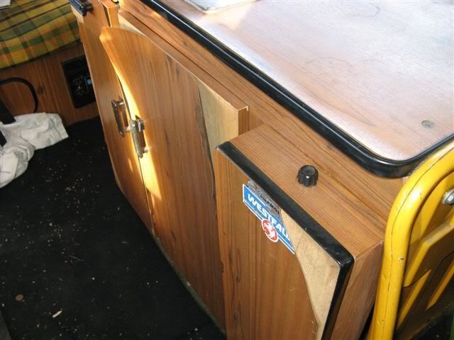

7.) The "wood" paneling is peeling off the face of the interior. Replacments for this? better ideas for a replacement?

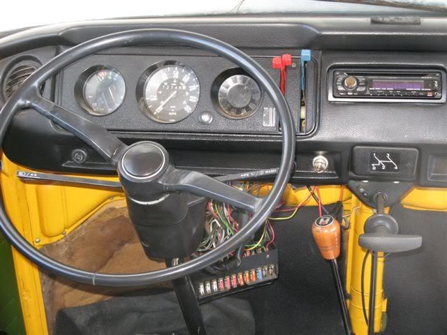

8.) The Speedometer is broken, as is the odometer. The odometer appears to have not been running for some time as it is miles exempt. I don't really need the speedometer as I don't think I could get a speeding ticket if I tried, but I do want that to work at some point.

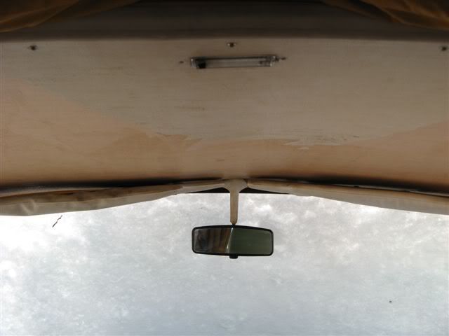

9.) the overhead interior is peeling off, I would like to replace that with something, just not sure what.
Pull the gauge cluster out and disconnect the cable from the back of the speedo. Then with the front left wheel jacked up off the ground start spinning the wheel by hand. You should see the end of the cable spinning. If you dont, the cable is broken and replacements are cheap.

As for the battery tray there are several solutions. As a temporary measure just cut a piece of plyboard to fit the outline of the tray so the battery is less apt to fall though. If the tray is not too bad I like to just coat it with multiple layers of fiberglass, but if it is badly rusted then buying a new tray and welding it in is the way to go. Unfortunately the welding will burn your paint. Crying or Very sad
If you are buying new cables anyway you could just move the battery to the other side and start anew. Buy one of those anti corrosive mats to sit the battery on, and when and if you buy another battery get a sealed one to cut down on acidic fumes.

The interior wood panels were 3 mm baltic birch and you can use a "door skin" from the hardware store for about $7 for all parts except the headliner where it requires a wider piece. Just becareful in the removal of yours so you can trace them then cut with a jigsaw with a sharp metal blade and pick out what ever screws and washers you want to install.

Here is your glove compartment
http://www.busdepot.com/details.jsp?partnumber=211857101A
Best fix is of course a new metal battery tray piece. But there are plenty of temporary options like plastic or wood. Even getting a plastic battery tray from a junk yard would help for now.

Where does the door fall off? Off the rear track? Then it might be the nylon runner piece. Off the bottom? Might be a rusty track, or also a loose upper guide - check all guides, rollers and clearances.
Patching fiberglass is really easy. Get a repair kit from a FLAPS. Just be sure to position the pop top correctly so that when the patch dries it is straight again.
EASY - $20 buys you a new glovebox insert - you might need the metal bracket too.. check classifieds...
No easy fix - live with it or make new paneling. You could try gluing the peeling sections back with spray adhesive. Best replacement is 3mm Baltic Birch plywood in 5' x 5' panels. Stain and laquer.
Probably just needs hooked up by the back of the spedo or where the cable attaches to the front driver's hub. See Bentley.

3mm (1/8") Baltic Birch ply again..

The outside of the sliding door

The passenger side
The steering wheel, speedo doesn't work

This is what I have to do to keep airflow from getting in through the pop top while driving. It doesn't sit flush
The headliner

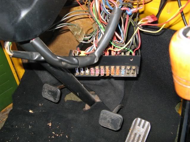

My fuse box hangs
No glove box
Interior cabinet

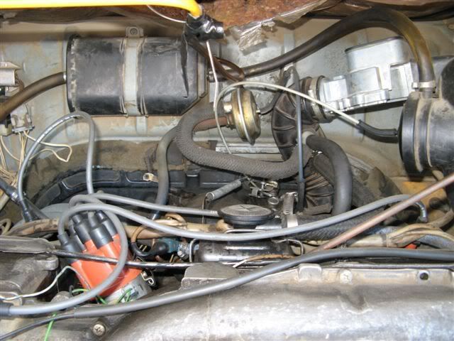

The engine
My cracked pop top. This was cracked the day I bought it so I am not sure if this is why it is not sitting level. Is this repairable without replacing the whole thing?
Underneath the battery tray

Fixing the fuse box is easy, just find two screw that fit to reinstall it.
Good to see the FI is there!
The top can be fixed with fibreglass but I would wait until spring as its better to do with the top off.
Time to weld in a battery tray...

I wouldn't try to fix that top, it's only going to keep breaking in the same spot. I would replace it myself....too bad you're across the country, I've got a complete top sitting right in the backyard.
