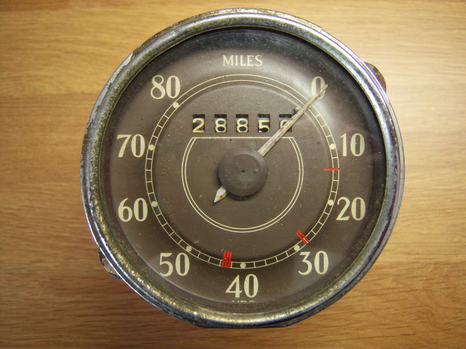

The one nice thing about having an interest in old VW's, is that we continue to learn things all of the time, no matter how long you have been on the scene. Talking with a friend just now about the subject of old speedos, as he is about to have some decals/transfers made for these early speedo faces, I pulled out an old speedo from the now famous sock drawer, which I now realise from the sand coloured overspray, was the one fitted to my 1st Kubel 35 years ago, and obviously replaced with the proper Kubel item at some stage.
Looking at it, and the info above, I can see that it's a 1950 Beetle item, when compared with a 52 speedo, is quite different in a number of ways, and has more similarities with the Kubel speedo than the 1952 one. The mileage figures are seperated by bars on the 52 item, but not on the 1950.
If you compare the pictures of the back of the two, there is quite a considerable difference in their shapes and even the light bulb is situated differently. We live and learn! Shame this one is not a MPH speedo.

I had a '50 which I sold many years ago, and the speedo was indeed shaped like the one you have. My '51 speedo is shaped like the first picture.

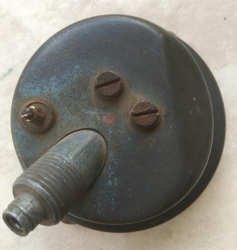

Here you go, a MPH speedo from a RHD Rhodesian standard split dated 10/50
Rarer than a KDF speedo, but they do exist. Very Happy

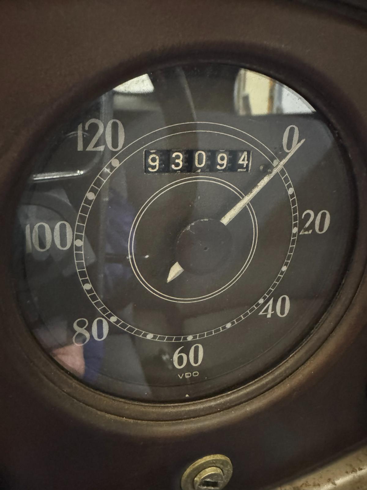

PostPosted: Wed Feb 05, 2025 6:43 pm    Post subject: Re: Trying to locate a source for a 1950 MPH speedometer Reply with quote
