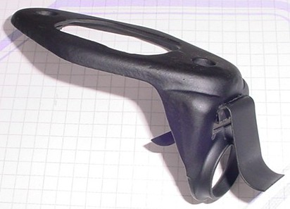

ok not sure exactly what i need for shift rod quides i ordered the old standard guides like you would use for any other vw and it doesn't seem to fit. also there seems to be no way of placing guides on the long rod

Your front bushing uses that metal spring instead of the plastic bushing.
It looks like it's falling out though.
NOS one:

yes, you do not use the later style "plastic" bushing. it will not fit, as you have found out already.
the early bracket and spring are totally different from the later version.
here is what the "m" springs look like out of the bracket. no, they are not for sale, don't ask. does anyone have a source for the M springs?
there may not be any bushings on the long rod either. does the long rod pass through a tube, or is it exposed when it is installed? (can you see the actual rod when it is in the bus and you are under the bus?) if it does not go in a tube, there are no bushings on the rod, only the weird 3-fingered bushing as seen in center of the pic above (no, that is not for sale either). that clips in to the front crossmember, and that is the only long rod guide until it gets to the rear coupler/transmission. if there are no holes in the long shift rod, i would guess there is no tube for it to pass through.

i have a double door so i imagine that would put me in the plastic shuttle cock style bushings for the long rod tube? as far as a retro fit are there major differances with a later model front hanger that uses the plastic bushing?

Couldn't you use the later style shift guide bracket and nylon sleeve with the old shift rod or is the diameter altogether different?
yes you can.
I think you then have to shim the shifter under the bus between the floor and the new/later guide. you can use a couple washers. I think it needs a bit more space there if you do it that way.

i had a later (post 59) front bracket and bushing on my 59 and it made shifting difficult. i found the correct early parts, put them on, and since then the shifter works great.
