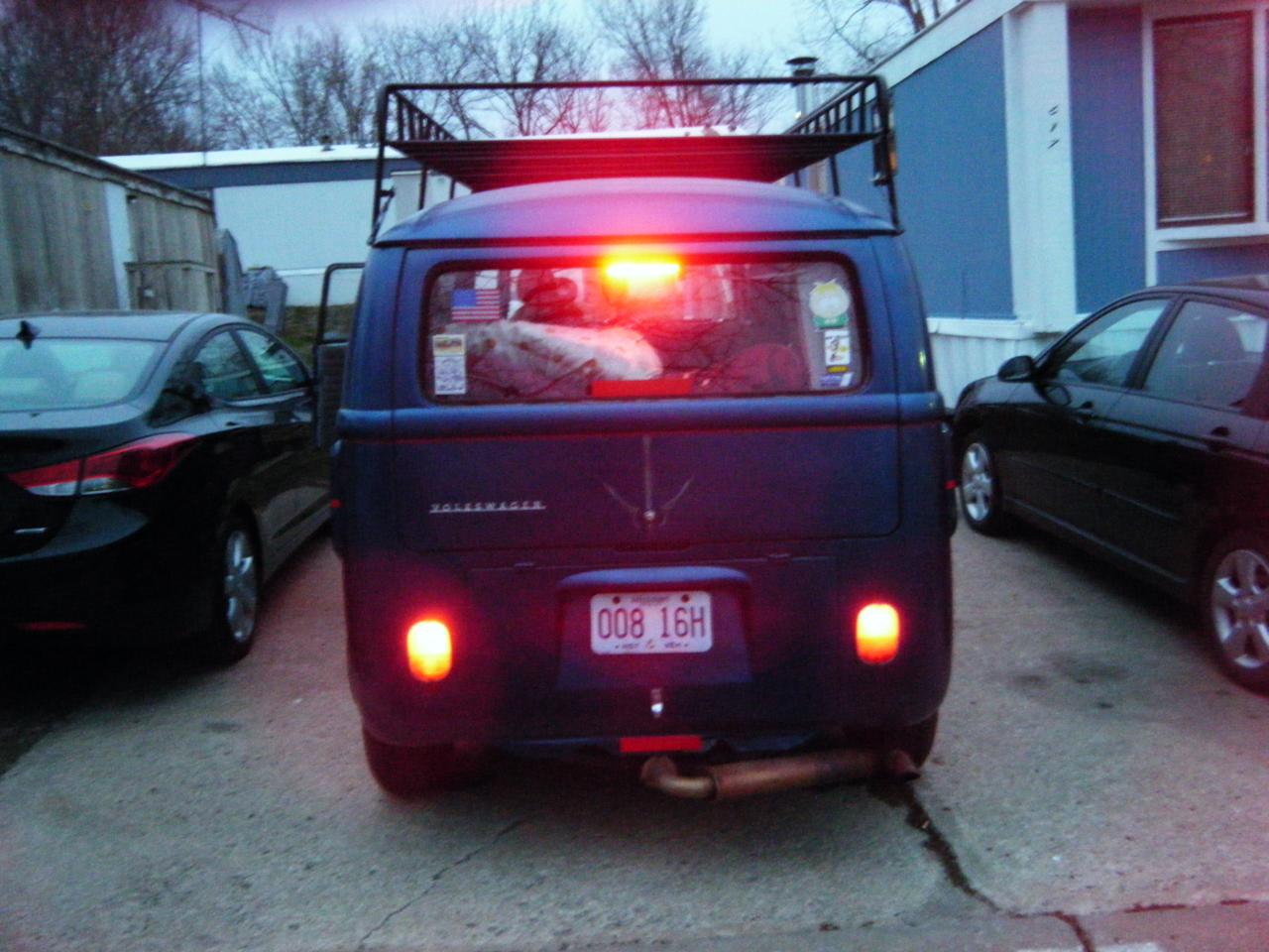

Made my own 3rd brake light.

Waiting for santa to drop off funky green. I can wish can't I????

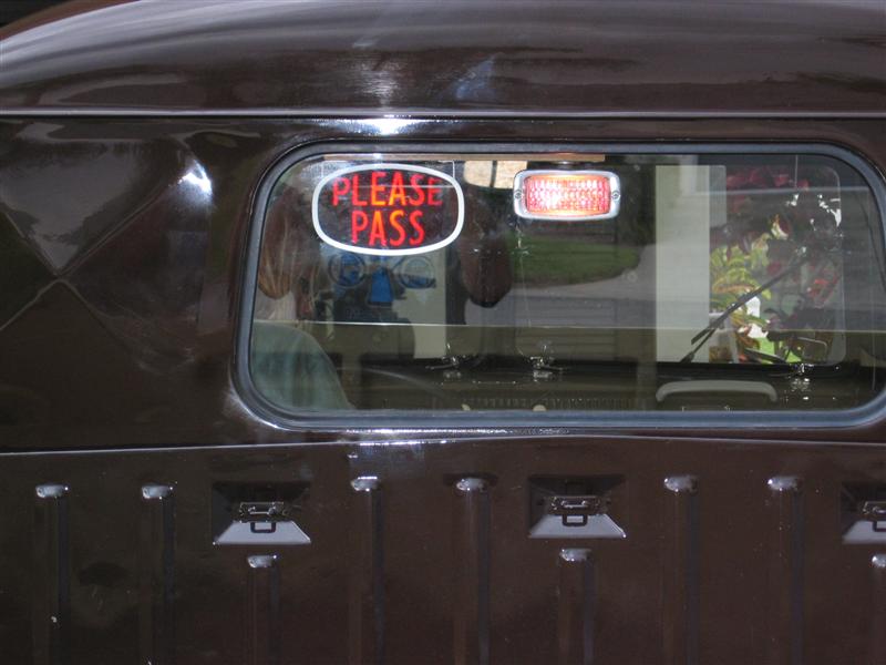

LittleThunder
Joined: May 21, 2006
Posts: 1015
LittleThunder is offline
PostPosted: Wed Dec 21, 2011 7:40 pm    Post subject: Reply with quote
I used an old 67 bug back up light with a broken piece of red reflector stuck inside.
[img]
[/img]
Is that 'Please pass' sign lit up? That's dope.

quartermilecamel
Joined: April 16, 2008
Posts: 3929
Location: ohio
quartermilecamel is offline
PostPosted: Thu Dec 22, 2011 12:00 am    Post subject: Reply with quote
yeah I thought of using a reverse light but I wanted something that you just couldnt mistake for .......is that thing on or not. That sign isnt even at full voltage yet. I used it as a flashlight inside and outside.

Wolffeather
Joined: September 10, 2004
Posts: 145
Location: Rhododendron, Oregon
Wolffeather is offline
PostPosted: Thu Dec 22, 2011 8:17 am    Post subject: Reply with quote
I Really like that "Please Pass" Light too. Sometimes I get people that WONT pass because they're checking out my Bus, then when they do pas it turns into a photo OP. Any more info on the Please Pass light ?

quartermilecamel
Posts: 3929
Location: ohio
PostPosted: Thu Dec 22, 2011 1:59 pm    Post subject: Reply with quote
Rob Whitey wrote:
I like it. Will it work on 6 volt? Can you post how you did it and where you purchesed the led's?
Thank You
-Tim-
I purchased leds from radio shack...at 2 somethign a bag of 2 Evil or Very Mad Gave up on them and looked on ebay. Under usa seller theres a guy that sells 10mm red ones for......get this..........100 for 9.95 Very Happy Im running 12 volt so, I put 5 leds in series for 10 volts then I will use a regulator to drop the remaining voltage. Yes you can make yours to work from 6 volts. Just use less leds in series. Or, use a resistor with every led. The average led is 2 volts @20ma. The regulator is for when your running the bus......to account for the alternator or generators higher than battery output voltage. If you put 6 leds together and dont regulate (lm317t) or use a resistor, Im guessing that when you start the bus......your leds will have a much shorter life due to the overvoltage. Leds arent like regular incandescent auto light bulbs, they are not as resistant to overvoltage.
quartermilecamel
Posts: 3929
Location: ohio
PostPosted: Thu Dec 22, 2011 2:04 pm    Post subject: Reply with quote
zozo wrote:
I went BIG with mine. I cringed every time I hit the brakes, just waiting to get slammed. It's not too noticeable when it's not lit, and it's easily removed without having drilled holes or done any other mods.
Yeah your the one with that huge strip, I just couldnt remember who had it.. Laughing I looked but couldnt find it online so I decided to make my own. The plus side is if it fails or an led burns out.....I can replace it easily.
This whole idea was fueled by that 58 bus that got creamed. I might even add more leds........not sure yet. The picture was taken while it was running off a 9 volt battery. Testing to continue until I can practically light lawns on fire with it Laughing
