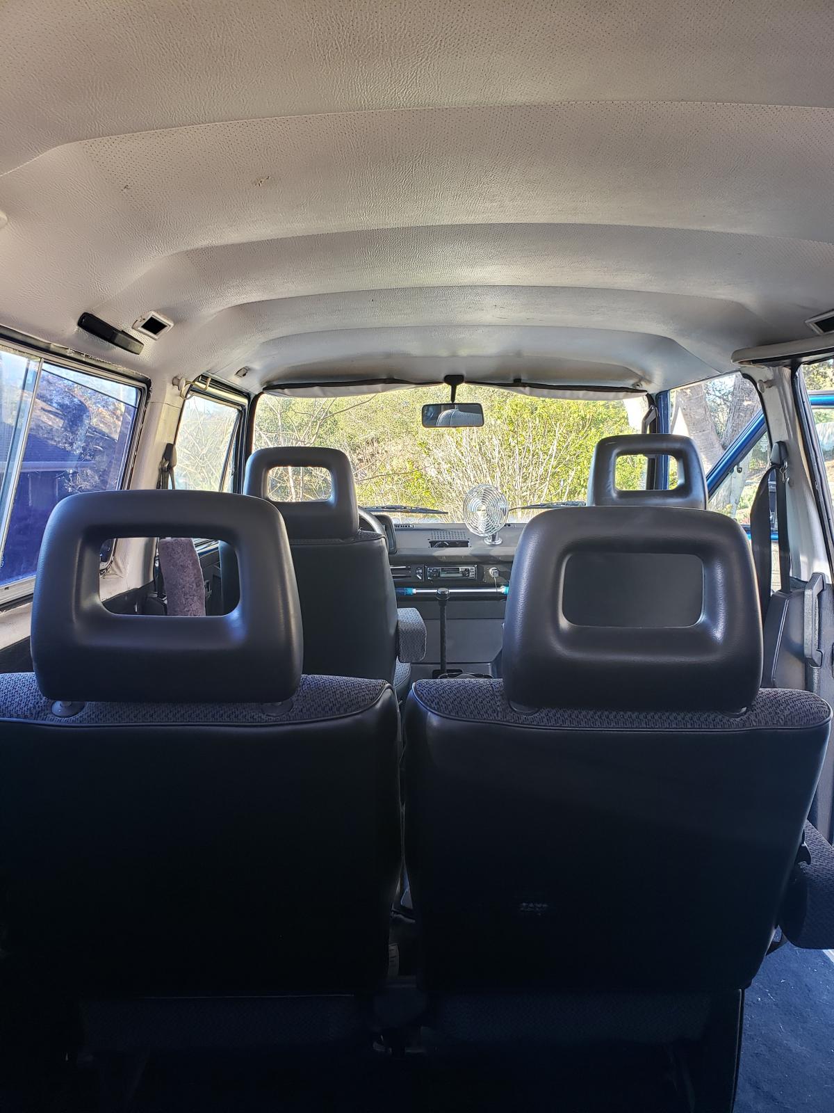

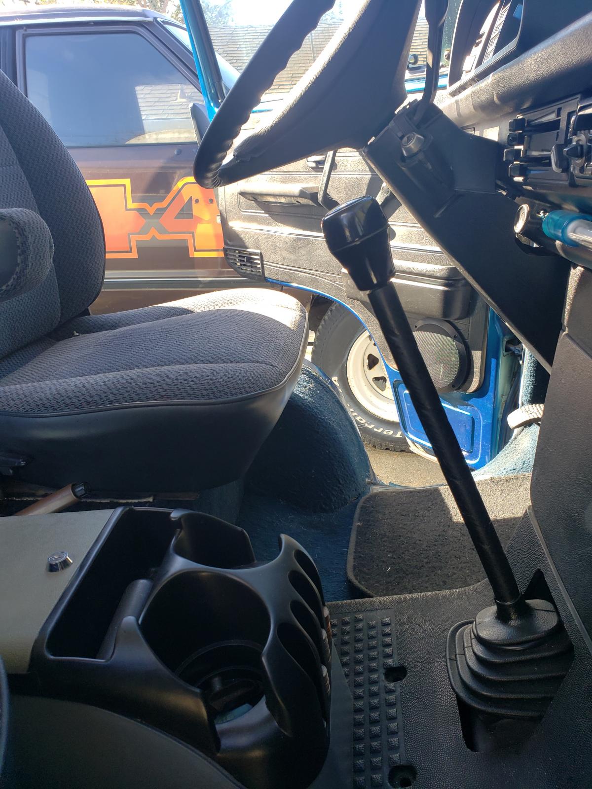

5 speed? The '82 should be a 4 speed... has it been changed? It doesn't appear to have the engine moved back for 5 speed spacing, but hard to tell with the picture

The clutch pedal is really worn like 200k+ but the driver seat apholstry looks low mileage wear, new interior??
Price is hard without seeing $3500 if she is poor $7000 you would expect absolutely no rust but with minimum general wear and service history. So probably somewhere in the middle around the $4500/$5000 looking at the pics.

As mentioned, the engine position appears to be the '82 (4-speed) position. Post pics of the nose of the trans or that's a 4-speed.

Interior is definitely not original as the '82 did not come with arm rests and the front seats have them although the outer rests were removed and show a strange lump in the aftermarket upholstery.
