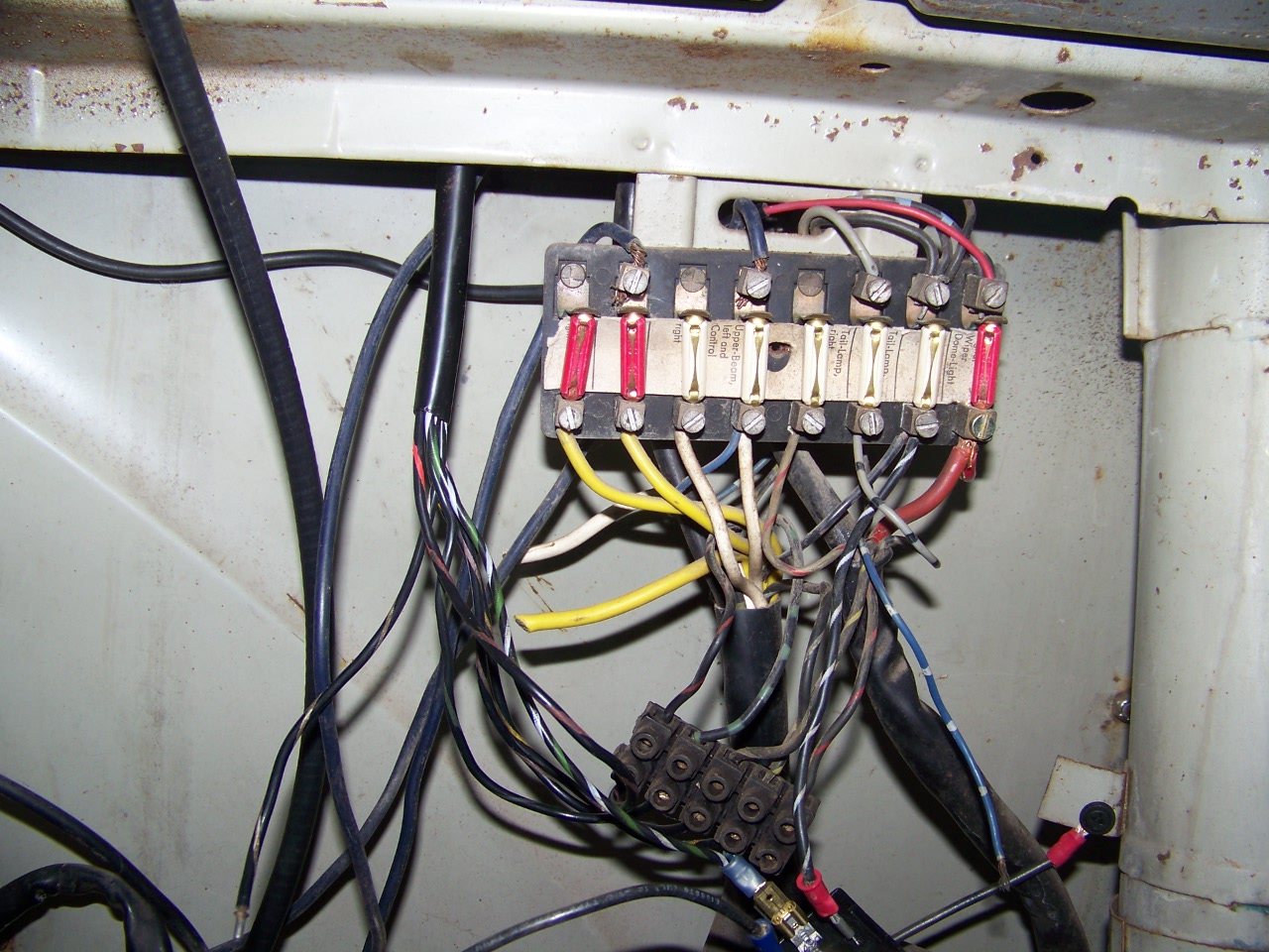

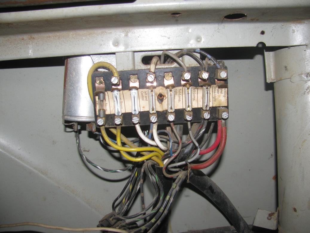

PostPosted: Tue Jan 10, 2012 5:46 pm    Post subject: 1960 only Reply with quote
Here is an unmolested 8 fuse block:
The only blue wire(white stripe?) goes to the bottom right side WHITE headlight wire. Other than dirty the wires look right except the three that go to the missing flasher relay which I need a 3 post screw terminal flasher.

PostPosted: Fri Jan 13, 2012 8:38 am    Post subject: Reply with quote
Ok, Here's the photo. The blue wire with the white stripe is the one in question. Can anyone ID this???

PostPosted: Fri Jan 13, 2012 9:22 am    Post subject: Reply with quote
The two black(dark) wires on the top left of your fuse block should have the yellow and white wires that are cut. Must of had headlight issues in the past.
I will clean my wires to get a better look for that particular blue wire.
Most of the blue wires run the idiot lights in the speedo. Blue and blue/green run oil pressure light and generator light. The only other blue wire would run turn indicator light in speedo. Also blue runs high beam light in speedo.
You should also have a 3 post flasher relay. I think black/green/white to fuse block, black/white/green to turn signal switch go to the flasher and this blue/white?
Also I think the 1961 wiring diagram is very close to 1960 having the 8 fuses. The only difference is screw terminal vs. push terminal. Almost all the electrical components are the same.

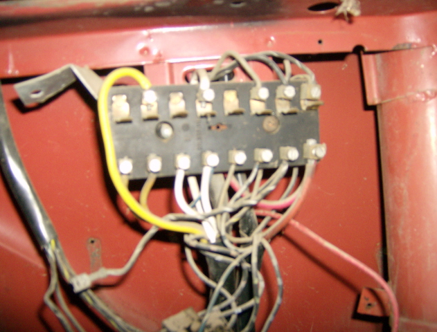

oddengineer
Joined: August 21, 2006
Posts: 112
oddengineer is offline
PostPosted: Wed Dec 06, 2017 5:34 pm    Post subject: Re: No 1960 wiring diagram? Reply with quote

PostPosted: Wed Dec 06, 2017 5:54 pm    Post subject: Re: No 1960 wiring diagram? Reply with quote
I did see that however seeing that i don't have a stock speedo in there yet and the wiring colors don't seem to correspond on the fuse terminal nor the light switch and i have a 2 post flasher that's what was confusing me... also the 61 fuse block shows the wires going to areas that are not on the terminals. Must be one of those in between areas for that year
