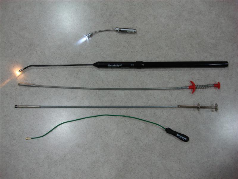

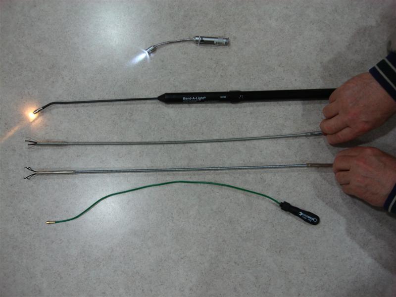

See the enclosed photos for the tools that are useful for extracting "stuff".
The mechanics claws have both straight teeth and hooked teeth. From experience I have found that the straight teeth work best for this job, especially since you do not have very much room to maneuver.
Your FLAPS or Sears should have these tools.
The green tool is a flexible magnet for when really bad things fall into your engine.
Pat (66foot)

Once you locate the piece, then figure your best angle of attack. Probably the Bend-A-Light in the center hole and the mechanics fingers around the outside.
You do not have very much room to maneuver, that is why I suggest using the mechanics fingers with the straight claws. They, will give you about an extra 1/8" of lateral maneuverability.
Be patient and you will be able to remove it.
