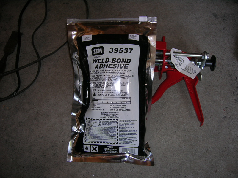

After looking further into my seam rust, I determined that the metal needed to be fully replaced.
so I set out to order the body panel, I called the usual suppliers to no avail, all where on back order. Disheartened I tried to figure out want local metal shop to visit. However, not an hour later I received a call from Richard at OEveedub, and he had found the panel. Very Cool.
after studying the wonderful pics at www.benplace.com THANKS BEN!
I figured was ready to take this on, so i loaded up my angle grinder with a cut of blade and set out, after making my first cut (see below) i started to gain some confidence.
and before too long, I had all the metal cut out. Since this is my project it required multiple trips to the hardware store; I failed to realize just how fast I could burn through a cut off wheel.
but here is the gapping hole in the side of my baby.
after getting it all out i continued to grind out the remaining surface rust that is seen and so far I'm feeling pretty good about the job. It has taken me a bit longer than I would have guessed, but that is no big surprise.
Now, the dry fit is very important, if it don't fit prior to the epoxy, it sure won't fit after you glue it up. So i must have put that panel in 200 times and taken it out to grind a little more, but in the end the fit looks very good to my eyes.
After I was happy with the fit I used a few #6 sheet metal screws on the top edge and C- clamps on the bottom.
So far this has been about a 5-6 hr job.
I'm sure it would be much faster, but I procrastinated a fair amount (to cruise the samba of course)
Tomorrow I will try and get the confidence to finish up,
I've decided to use SEM Weld-Bond
So after a little bit more grinding and zinc coating I will apply the epoxy and clamp it up, I hope to have a few more pics of that process tomorrow.

I just got my new panel and will start cutting today hopefully so I'm real curious to see your progress. I do have a question though. Are you planning on welding the panel after using the weld bond?
No need at all. This is solid stuff. Just glue 2 metal part and just try to separate them 6 hours later. It's clean, somewhat flexible and easy to do.
I have that procedure somewhere on my site... mmmmm... ok, got it:
http://www.benplace.com/panel1.htm
the only mistake that i did the first time is cut to hight!!! leave some more meat on the upper part.
So here:
http://www.benplace.com/85rouge/rouge59.jpg
Leave a good 1 in more. (cut lower)
thank you for the pictures and the advice!!!!
No problem, also, to do it the right way you need to fully remove the original skin, by that i mean even the side and lower portion.
As my English is not very... elaborate, here is what i mean:
http://www.benplace.com/85rouge/rouge32.JPG
http://www.benplace.com/85rouge/rouge33.JPG
http://www.benplace.com/85rouge/rouge34.JPG
This is not the side panel but you get the idea.
You can not overlap the new one on the side and botom. You can also gring it. But the skin come so hot that it can warp a bit.
Shit, i had a picture:
got it now!
